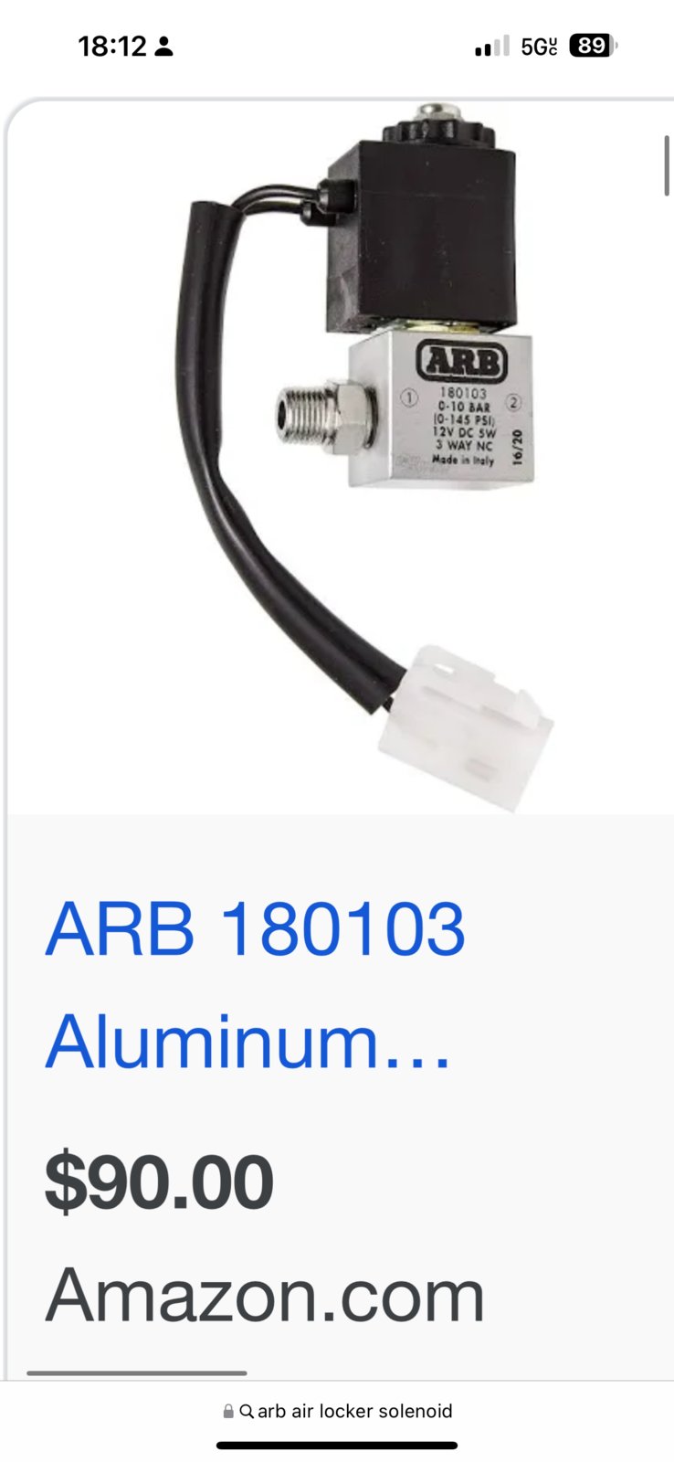

    I was talking about this item if it comes with the arb manifold or i have to get it separate or i dont need it? Im using the arb twin compressor with the new arb 1 gallon tank and if i have a the new arb tank that has 4ports already i still need that manifold just curious whats the point of the manifold is it because the old arb tank only has one port?

    Solenoid valve comes with the air locker. The manifold is needed for the twin compressor because it only has a single pressure outlet.

    Copy now i see so i can use one of the ports that the new arb 1gal tank has 1 to the compressor going in 1 to rear locker and the other two for airing tires i need to ask ecgs if they will include the solenoid valve with my purchase on a build gear if not ill have to get one for it thanks mehn im just making sure i do it right if that sounds about right just give me a thumbs up

    You should be good. I remember ARB likes to mix npt and bspt and bsp threads in the system, it's weird. But I think the connection to the solenoid is 1/8 npt so that'll fit right into the tank. However, depending on where your tank is relative to the compressor your wiring harness may not reach the solenoid. I think ARB may sell an extension but not sure.
    You definitely should get the solenoid from ECGS with an ARB install so should be good there. Otherwise, I would not buy a stand alone solenoid valve from ARB anymore ($90 is stupid) but would get something different like a MAC valve.
