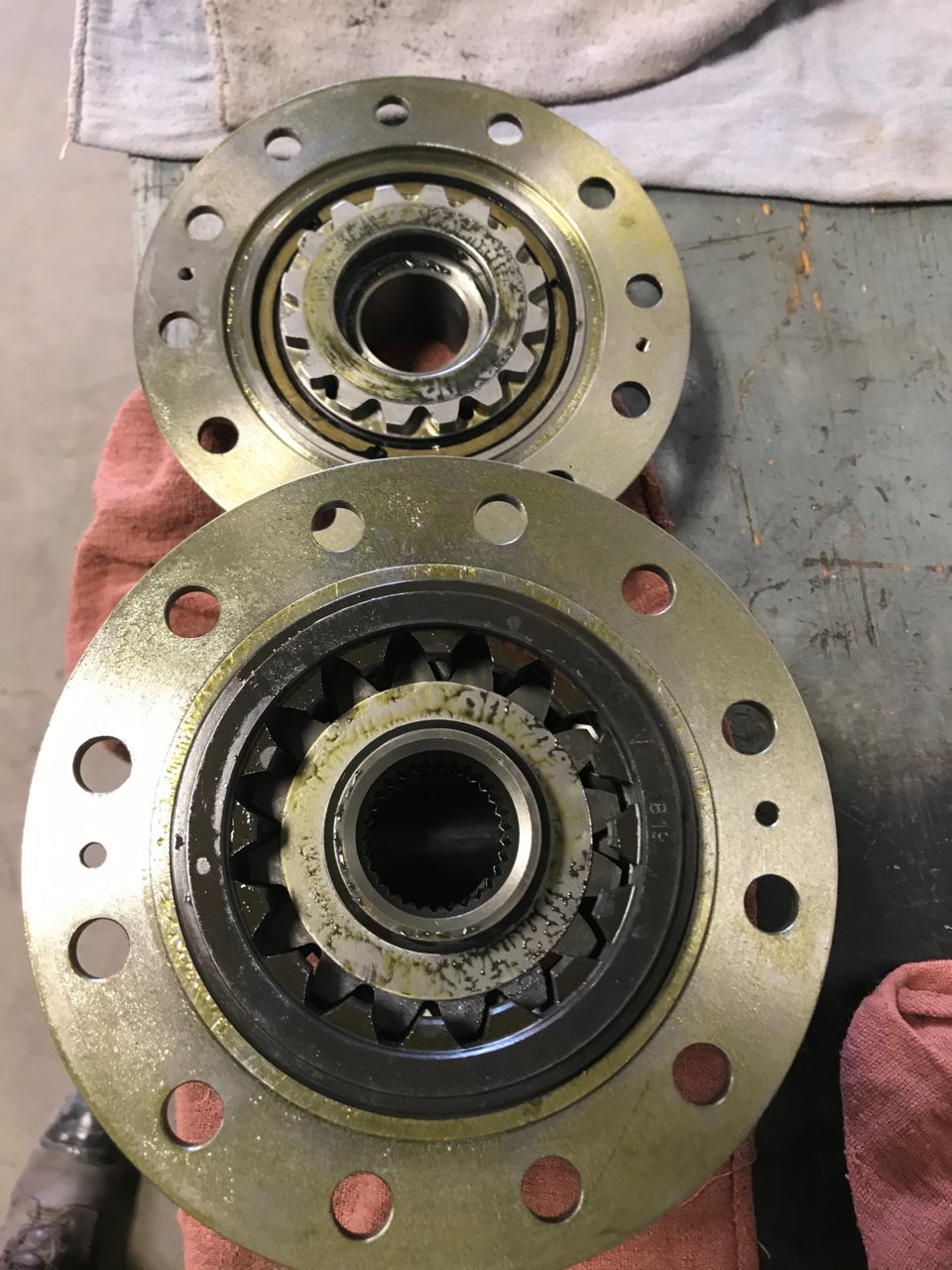

    I have front a rear arb lockers. You need to make sure it doesn’t have the black bond seal otherwise it WILL leak. I read TW before install. I advised my mechanic of the seal issue mentioned by TW members. He called ARB. They told him don’t install if you find the black seal inside. he opened and one of them had the bad seal which was part of an old batch that Arb isn’t using anymore.
    Have your shop open the lockers and see if the bond seal is black. They should be brown.

    So the Seals are part of the ARB Air Locker? Im assuming if I were to order a now one now I get a brown one! lol..
