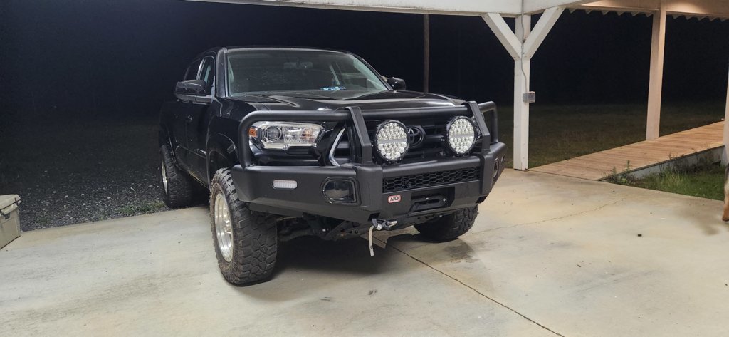

    My 2016 SR5 is going in the shop next week for an E locker in the rear and a ARB air locker in the front and also a 2 inch lift. I also had the OTT tune installed last week by Jamie Davis and I can't believe the difference it made in the driveability of this truck. I'm a T12 paraplegic so after the lift I hope I can still drag myself up in it. Lol!
