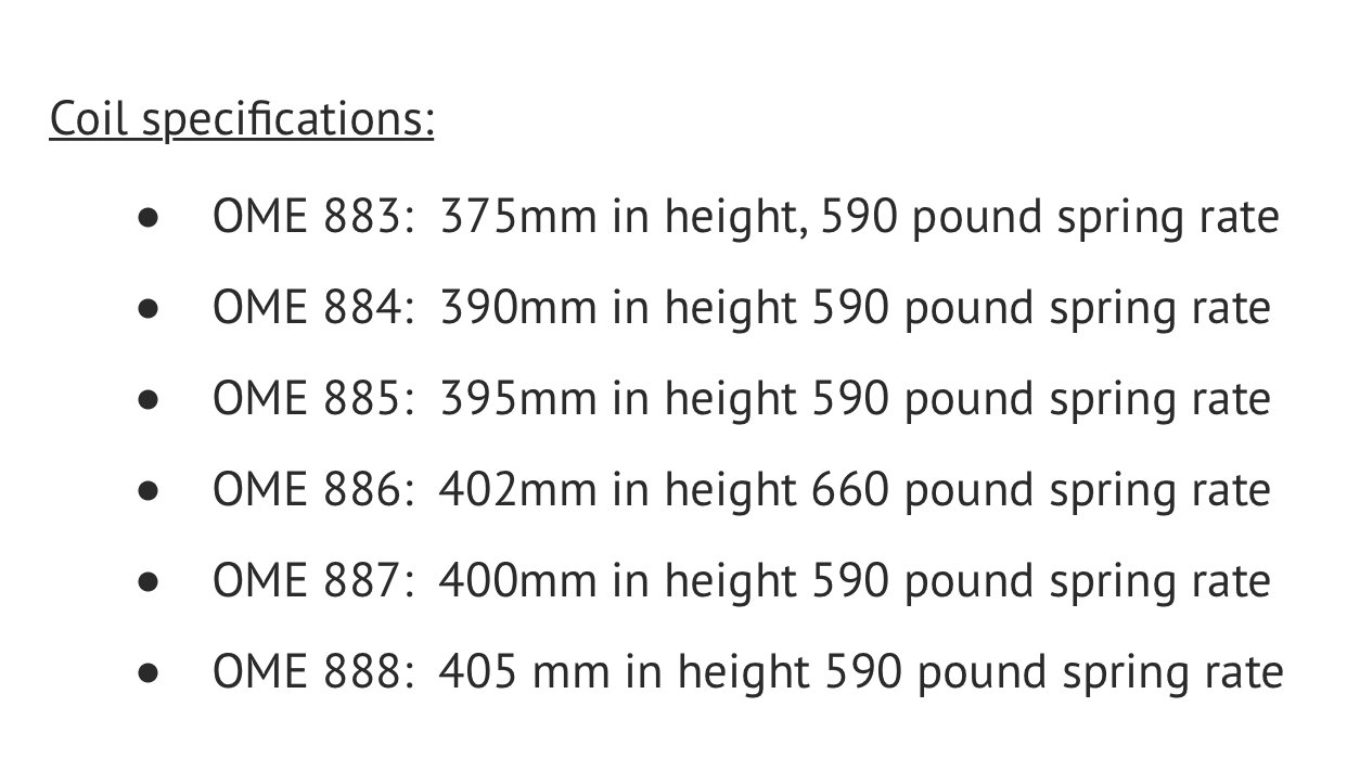

    From Headstrong:
    AIRIC, CygnusX191 and LostHusker like this.

    #20
    grubburg
    grubburg Well-Known Member
    Jan 13, 2014
    #120579
    2,329
    2019 TRD OR MT
    K & N Intake, Gibson Catback (chopped), Weathertech floormats, 285/70/17 Ridge Grapplers, Black Rhino Glamis wheels, Kicker Key, Kicker Hideaway, Infiniti Speakers, OV Tune, 888's, 5100s X 4, HS 3-leaf, LR SPC UCAs, Diff Drop, Carrier Bearing Drop, OEM Bed Mat, Morimoto HID low beams, Morimoto LED 2 Stroke High Beams, KC 336 LED bar, KC C3 LED pods for rear, KC LED 6'' SlimLites ditch lights, N-Fab Steps, Auxbeam Interior Blue Lights, 7r41lbr34k3r Shift Knob, Wet Okole Seat Covers, Diode Dynamics SAE Pro Fogs, Cali Raised ditch light brackets, hidden light bar brackets, tailgate light brackets.
    any idea what "pound spring rate" is?
