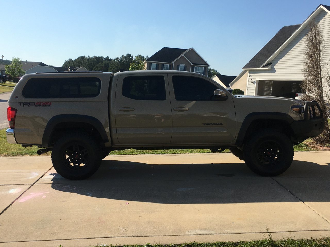

    I confirmed with ARB/OME that I should only expect 2” of front lift on a 3rd gen Tacoma. 2” of lift in rear too. This is with their medium kit; ome 888 coils and nitrocharger 90021 shocks. So I will still have factory rake with that kit it seems. Planning to add 1/4 spacers to both sides of the front to hopefully get at least 2.5” front lift and a tad bit closer to level. So at this point even with 1/4 spacers it may work out to where I will not need aftermarket UCAs? I guess we’ll wait until alignment day to confirm that, but I’m not ordering any right now based off what I’ve read on these forums.

    I didn’t do it. My fingers are crossed. I only lifted 2”.

    Thanks for the feedback. I’m glad to hear from another ‘18 TRDOR owner running full OME lift. Yes, I have talked with Marie and she has been very helpful over the course of a few emails, but I also like to hear from numerous folks out there with different experiences/perspectives.
    So I agree it does matter a lot what you’re planning to do with the setup/build into, and not only about looks... However, with me, there will be no serious off-roading. This is my daily driver. I hunt/fish/camp and take the truck through some ditches and fields. Maybe a logging road with some rough bumps is the worst this truck will ever see and I’m positive my stock setup could handle most of what I do because I’ve already proven that the last 2 years and only bottomed out like twice. Therefore it’s safe to say I’m doing this mostly so that I can run some bigger tires (33”) and get a beefed up better looking stance (for looks), but without sacrificing my on road ride quality since it’s a daily driver spending 95% of the time on highways and country back roads.
    I didn’t want to go pure blocks and spacers because of all the negative reviews on here and I don’t wanna go cheap and cause long term damage which will cost more in the end (plus I’ve read it would ride like crap if I went that route to save $). So my research and budget of $1500 on suspension kit brought me to either this (OME full kit) or Bilstein 5100s and OME coils, or Toytec Boss kits. Positive ride quality reviews seemed to be most consistent with the full OME kit and price was right. I’m excited to see how I like it.
    Two questions for you:
    1. How much lift front and rear was achieved on your truck before weight and sag factored in, and after weight and sag? Do you think 888s will achieve more than 2” up front without me adding front weight?
    2. Which front shocks do you have? 90021 (soft ride) or 90000 (stiff)?
    Also have you tried getting rid of the squeak in the Dakar’s? I’ve read cleaning or greasing can fix... but idk... thanks
