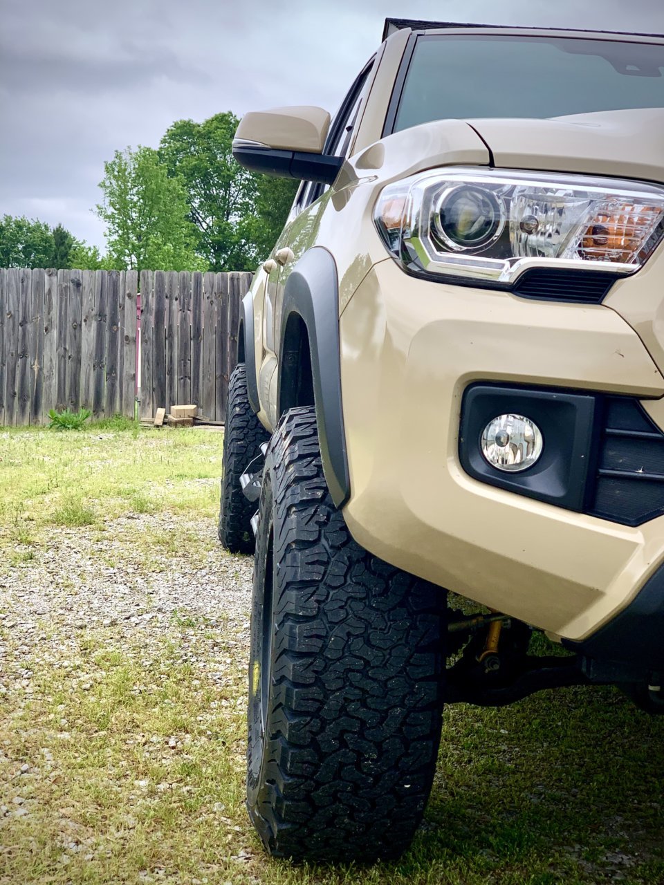

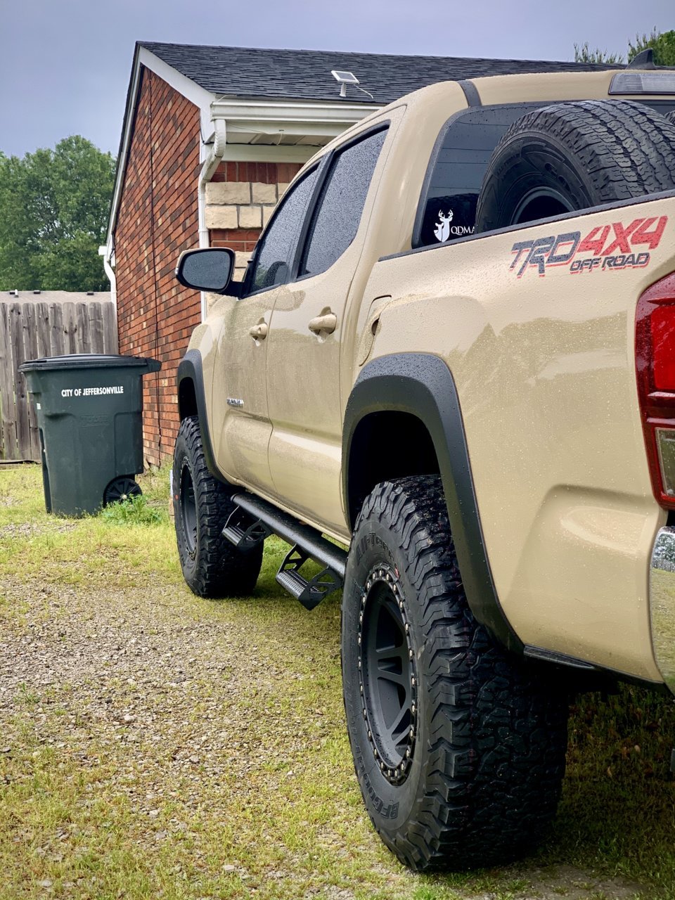

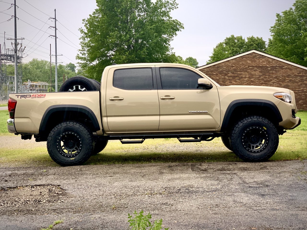

    Lift installed...
    Went OME medium load kit
    OME 2888s and nitrocharger shocks all around
    1/4” top spacers on top in the front both sides and small trim packer on drivers side only for taco lean.
    Medium Dakar leaf pack
    Have not measured, but looks like approx. 3” in front and 2” in rear but that’s an eyeball’s guess. It’s very close to level looking.
    Running 285/70/17 KO2s on Method MR312s with -12 offset and 4.5” backspacing. No rubbing yet but it’s fresh. Might rub a little once settled.
    Stock UCAs got a good alignment.
    Rides pretty nice (as good as stock on road) maybe a tad stiffer in rear with no weight in the back.
    Haven’t been off-road yet.
    I’m liking the looks and feel of it so far, but haven’t put many miles on it yet since it was just installed yesterday.
    Here are some pics:E7FBB11C-99FD-4F40-8853-F12D89B492FB.jpg6BDA0081-4246-44CF-9EED-F13A979F5819.jpgD65F40C9-C4B5-4A92-8287-1B2F78525AB4.jpg8FA7243E-C5E0-42B6-8DB0-9900D18F6160.jpg

    Looks like a touch of Cali lean but your front might settle after 1000 miles or so. Have you pulled center of hub to fender measurements? Looks good man

    Thanks! I have not pulled measurements but plan to by this weekend. I will say these pics were with all the other suspension parts and all tires and wheels from stock setup laying in the bed. Once I unloaded all that the back maybe came up just a smidge. It looks kind of level if not maybe a very slight front rake still.

    The tire/wheel setup looks good!

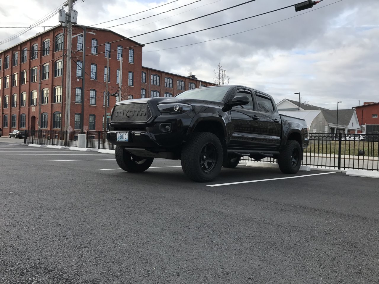

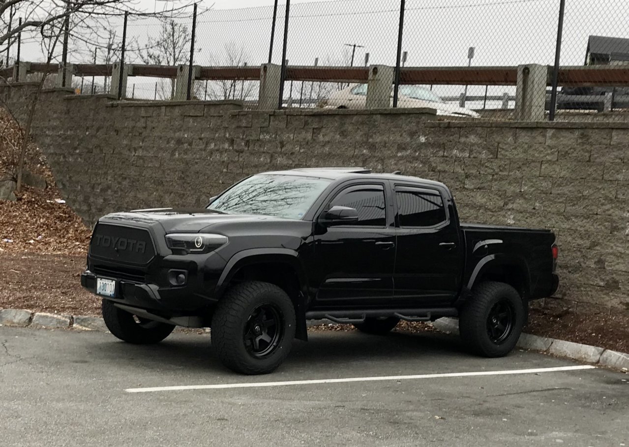

    What is your wheel and tire setup?

    RI
    2017 Black Tacoma Limited
    18x9, -12mm Fuel Shok wheels
    275/65/18 Falken Wildpeak AT3W tires

  11. Oct 20, 2020 at 3:09 PM
    #51
    2ski4life7
    2ski4life7 Well-Known Member
    Apr 30, 2012
    #77911
    2,207
    Seattle WA
    17 DCLB 4x4 TRD Off Road Previously '12 DCLB 4x4 SR5
    Got any pics of your setup? I think I am going to go this route.
