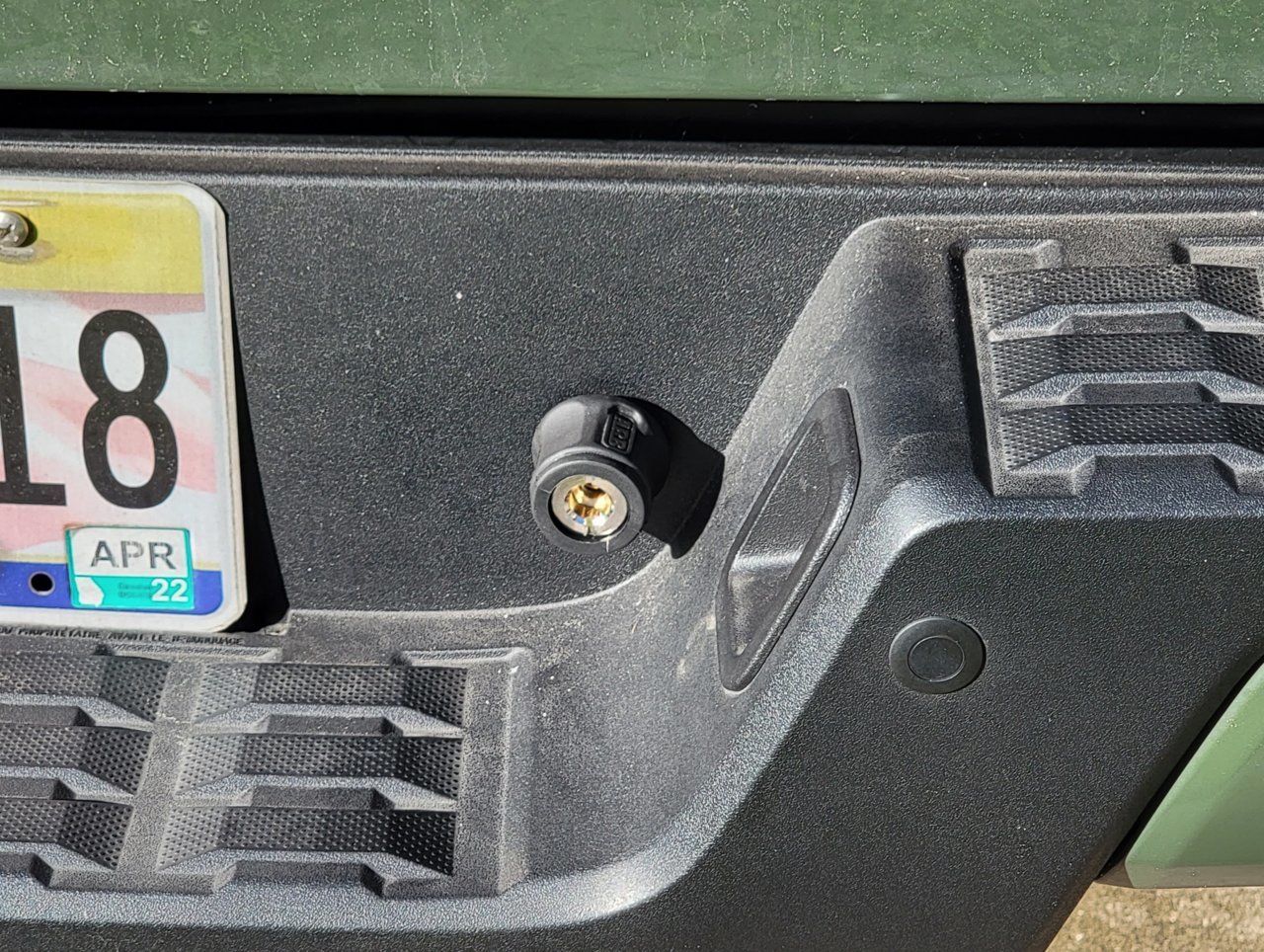

    I ran the line from the engine bay all the way to the driver's side taillight where I installed the ARB tank and and electronic solenoid as a drain. Then I drilled out a hole by my license plate for my quick disconnect. Didn't want it too close to the plate as to cast a shadow at night but also needed to line it up with the metal behind the plastic.

    Looks killer! I would highly recommend a dust cover with that location. Amazon sells the arb version.
