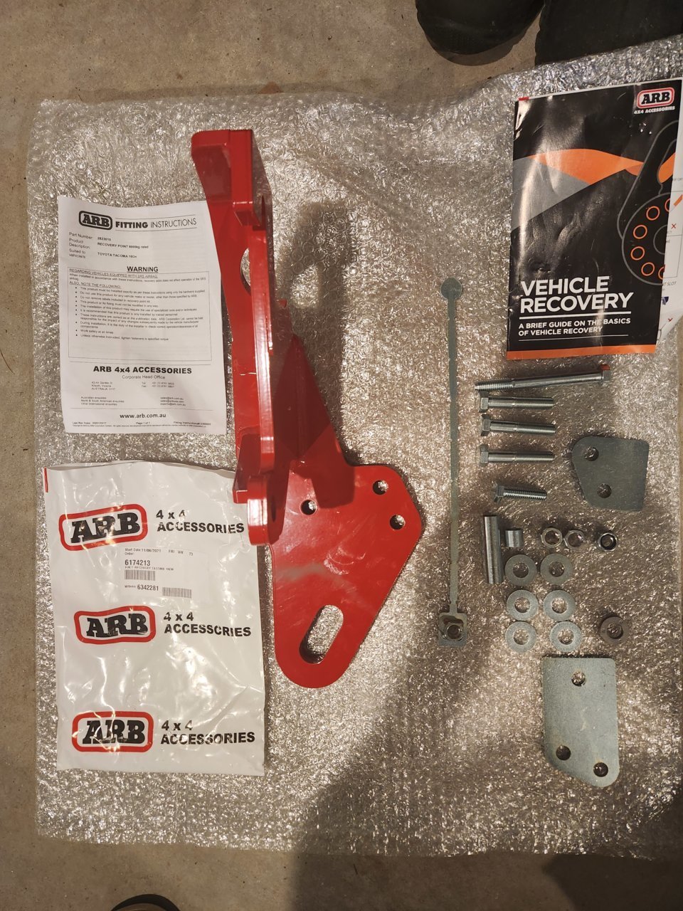

    What is the 1 thicker washer used for? It doesn’t say in the instructions anywhere
  4. Sep 14, 2023 at 9:33 PM
    #184
    musicisevil
    musicisevil Lesser-Known Jack Wagon
    Jan 8, 2022
    #386719
    2,285
    Alaska
    2019 TRD Sport
    There’s two spacers if that’s what you mean. One for the stock bumper and one for an arb bumper
    Edit: Nevermind I see what you’re saying… The odd man out in this pic. I don’t recall exactly but it all made sense when I pieced it together before installing and went wherever it was supposed to go about a month ago. I’ll see if I can dig up the instructions
    Edit 2: The parts list has 6 flat washers and a single M12 washer. Step 9 reads “For the bolt without a factory weld nut, utilize the M12 flat washer and M12 hex nut.”
  5. Sep 14, 2023 at 9:51 PM
    #185
    fake4x4
    fake4x4 Well-Known Member
    Jun 20, 2015
    #157787
    913
    Los Angeles, California
    3rd Gen Tacoma TRD Off-Road DCSB
    Cool stuff
    So it goes on the part that “closes that opening” that is secured by a bolt …: if that makes sense? If you have pics that would be awesome …. I just want to be sure I get this thing on right

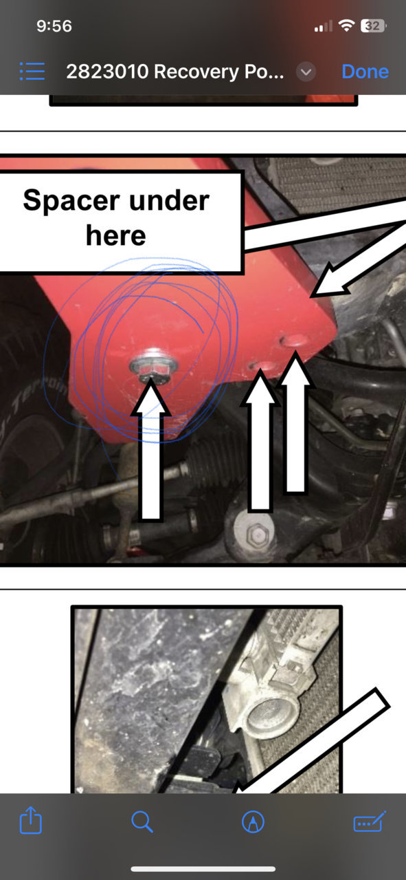

    I’m not positive what you mean. In the pic there’s three holes. The two on the right match up with the factory tow hook weld nuts. The one on the left lines up with a hole but you use the M12 washer and nut to secure the bolt since there’s no weld nut there

    So this one uses the thicker washer? Refer to my circles
    musicisevil likes this.
  9. Sep 14, 2023 at 10:00 PM
    #189
    musicisevil
    Jan 8, 2022
    #386719
    2,285
    Alaska
    2019 TRD Sport
    Yes, but it goes inside the square tube (don’t know what this piece is called) subframe, under the nut holding that bolt in place. The one in your picture is one of the 6 flat washers.
    It’s shown in the picture below step 16. I’d post a pic for you but it would be that exact picture basically lol I already had one. You can see the M12 washer and nut in the subframe.
    You got this! The hardest part is drilling the square hole wider. I was expecting the “nut on a stick” to be a hassle after I read a bunch of people complaining about it, but that was a cake walk imo

    I get it now …. Because the recovery point won’t allow the metal subframe cap to go back in , but that cap had the weld nut in it, so you will now use the bolt , M12x4mm washer and nut in place of that metal “cap” …. God these instructions suck

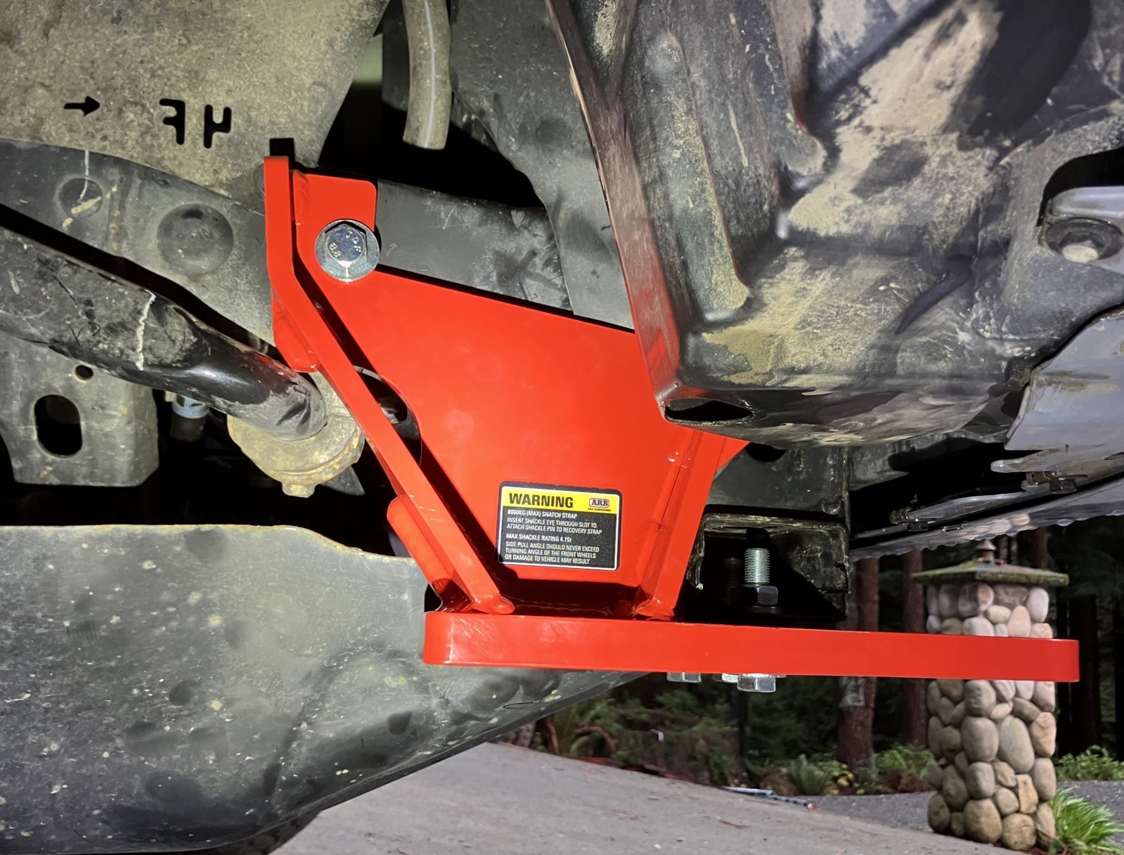

    Installed today. Not too bad to install really. The nut on the stick worked OK for me and didn't take too long. I trimmed the fender liner a little with a box cutter and that worked well. I did paint the spacer as well while I painted the frame after making the hole larger.
