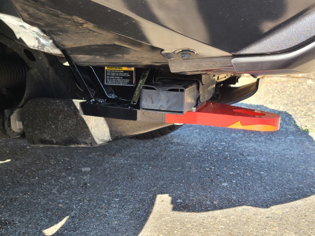

    Stripped, sandblasted, zinc primer'd, then powdercoated semi-gloss black :stirthepot:
    The red was obnoxious
    scocar, richy1371, jmneill and 2 others like this.

  10. Oct 23, 2024 at 12:21 PM
    #210
    assist
    assist Roadside Assistance
    Feb 12, 2024
    #443698
    70

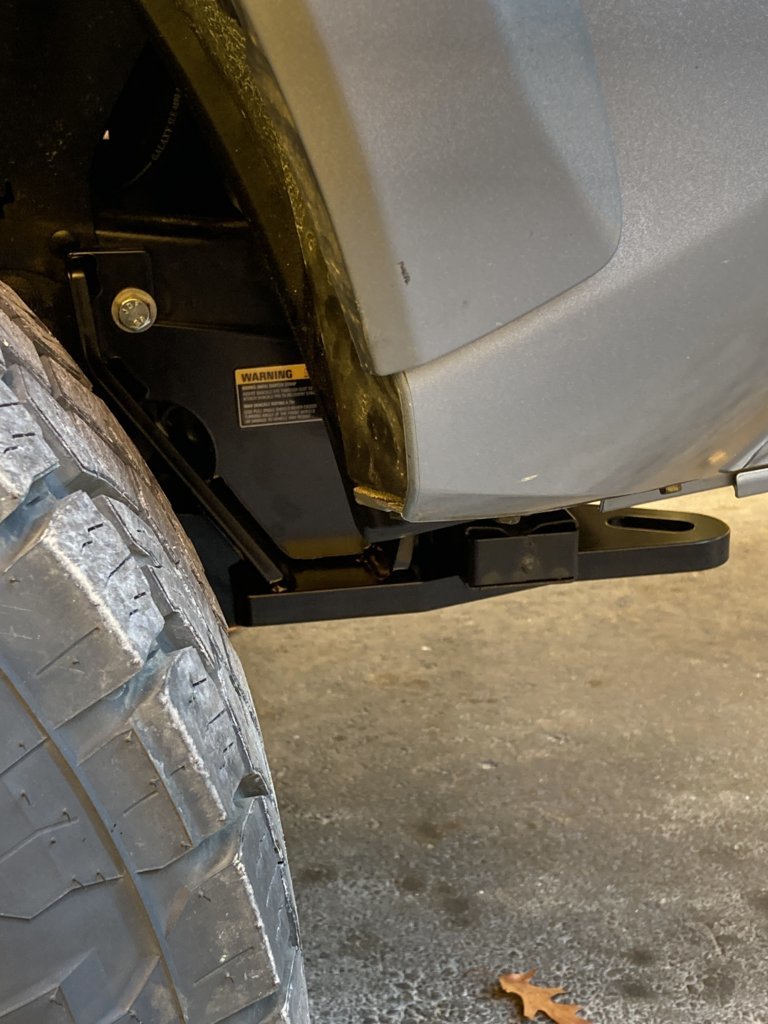

    New Hampshire
    2022 Silver TRD S 4X4
    Installed. the black finish hides it pretty well
    jasonvt, lsrmath, eurowner and 2 others like this.
  11. Oct 24, 2024 at 12:24 PM
    #211
    BattleKat
    BattleKat Well-Known Member
    May 19, 2020
    #328589
    1,076
    San Diego
    2021 TRD Offroad 4x4 - Army Green
    6112/5160s Icon RXT Leaf Pack (Option 2) Cali Raised 0-Degree Rock Sliders Cali Raised Bed Stiffeners Talon's Garage Cat Shield TRD Skid Plate ARE MX Interchangeable Yoda Dashboard Buddies
    Did you install it as red, hated it, removed it and did this, than re-installed? Or did you do this before even installing?
    I ask because of the nut on a stick. Like who would wat to go through that pain again? I still haven't been able to get the nut on a stick installed. I'm sure it compromises the rating but I just can't figure it out.

  14. Oct 24, 2024 at 5:46 PM
    #214
    assist
    Feb 12, 2024
    #443698
    70
    New Hampshire
    No sir, I have no red on my truck and knew I'd get annoyed by it, so I blacked it out beforehand.
    As for the nut on the stick, I pulled 2 or 3 of the fender liner bolts to get access from that side and stuck a light in there (I had the wheel off already). Then dropped the skid plate and was able to fish it in there pretty quick. After install I used some bolt cutters to cut off half the stick, which made it small enough for me to bend the rest back and forth until it broke off at the nut. If you plan on color changing I would definitely do it before you install that bolt/nut. Trust me man, I am the most amatuer wrencher there is, took a little over 3 hours to install this thing, but once I had the area all opened up it only took me 5 min to fish that thing into place and thread the bolt in because I had my working light right in there and could see exactly what it was doing. If I can figure out, you can for sure.
    eurowner and RIX TUX like this.
  15. Oct 24, 2024 at 8:53 PM
    #215
    fake4x4
    fake4x4 Well-Known Member
    Jun 20, 2015
    #157787
    905
    Los Angeles, California
    3rd Gen Tacoma TRD Off-Road DCSB
    Cool stuff
    Your actions are vague …. What did you cut out exactly? The nut on stick is terrible … very very hard to thread on …. I feel there is a much better way of going about this but shocked ARB chose this route
  16. Oct 24, 2024 at 9:27 PM
    #216
    assist
    Feb 12, 2024
    #443698
    70
    New Hampshire
    After i torqued down the bolt into the nut on the stick, i didnt want the stick attached anymore. So i cut off half of it, then was able to bend it back and forth a bunch of times until the rest of the stick snapped off
