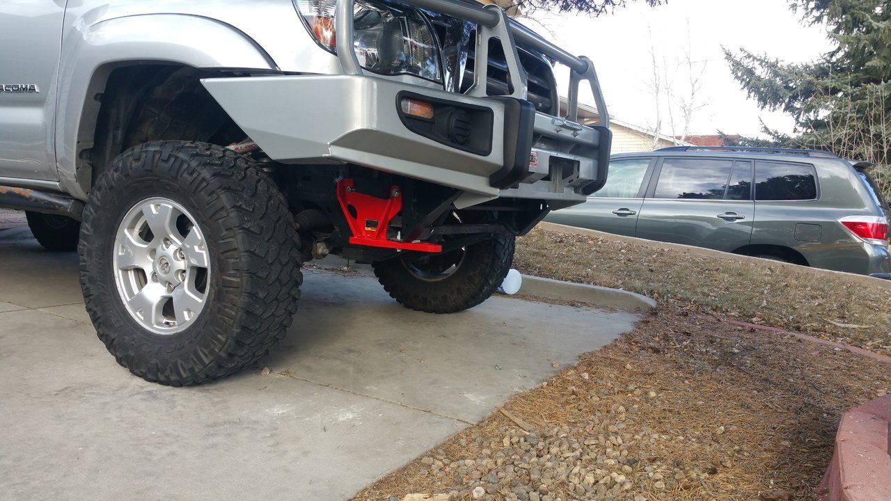

    I went ahead and bit the bullet and bought this recovery point even though i have a 2010 2nd gen. Some ARB stuff lists this same part number for the second gen as well but most retailers only list it for 3rd gen trucks. I have an ARB front bumper so i needed something with a solid recovery point and this fit the bill perfectly. It required some drilling out of an oblong hole on both sides. I did not have to remove any wheels and my front skid plate and the rock guard for the ARB bumper was already off the truck and still needs to be put back on, as well as the winch and level the bumper. just fyi for anyone searching

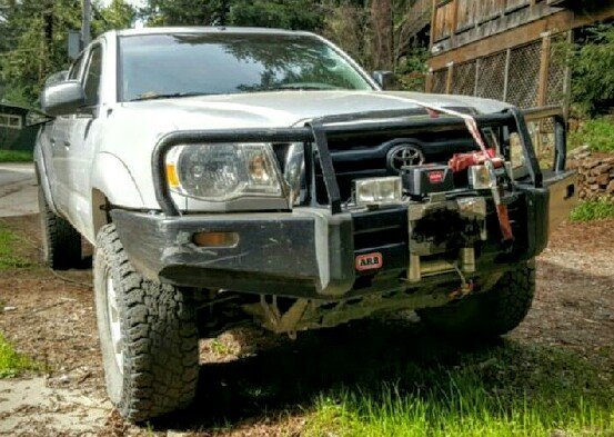

    I've had the opposite experience with ARBs powdercoating. Also haven't heard many complaints form on here either. Arb bumpers don't seem to rust away they seem to last the lifetime of the truck. That shipping damage however, sucks, especially in your corrosive area. 20160422_150501_2 (1).jpg
