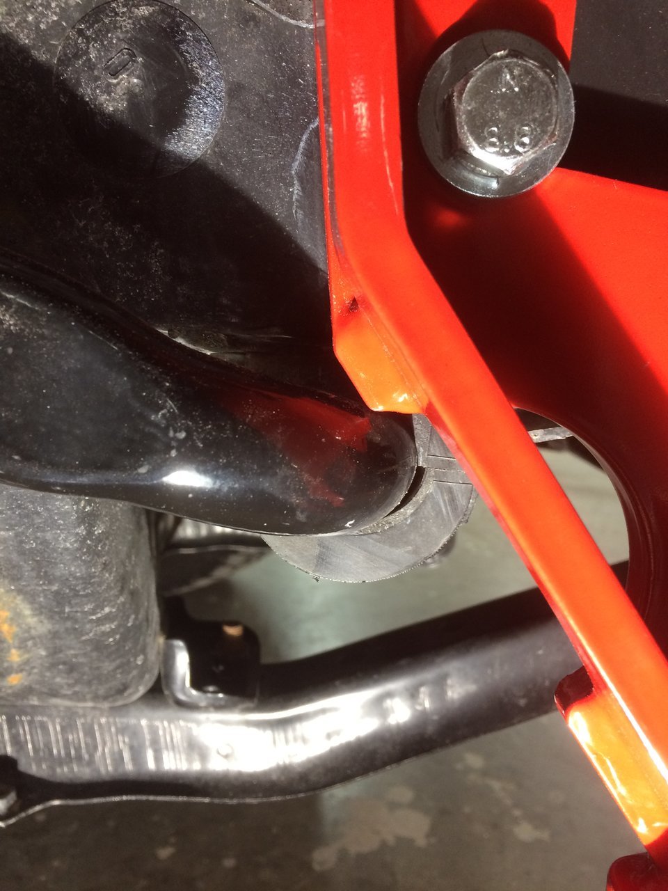

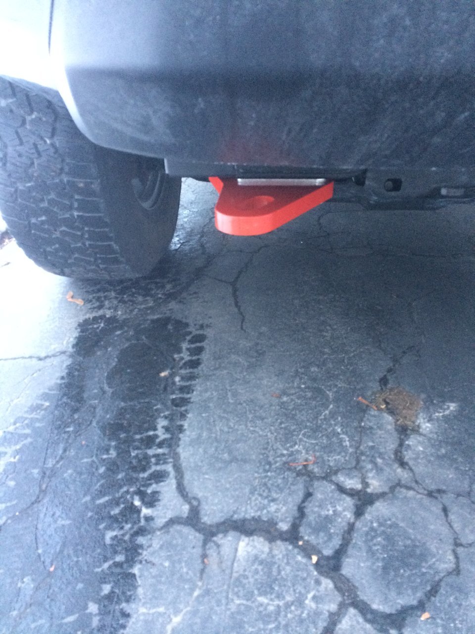

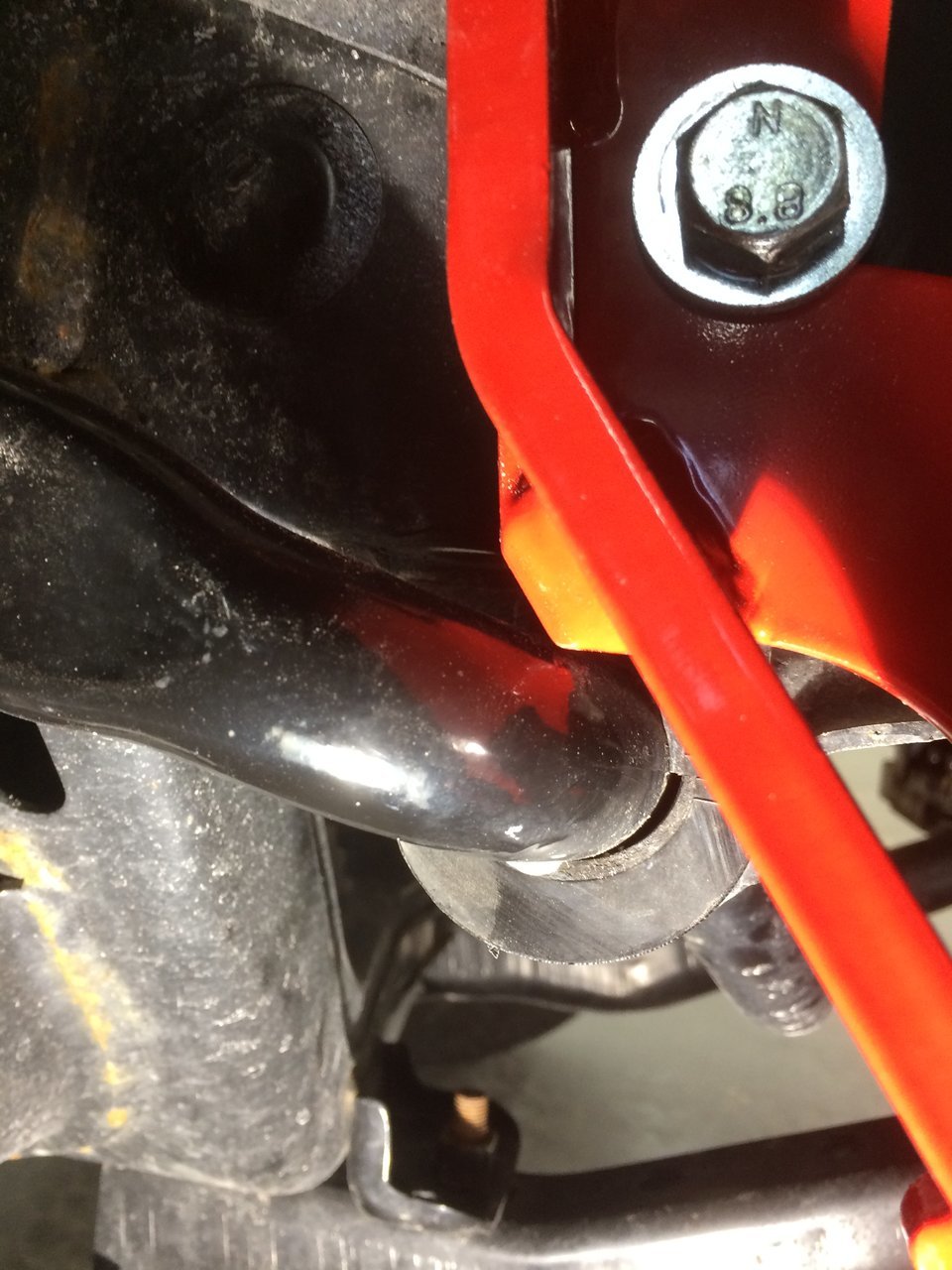

    Well I mounted up this bad boy today:
    I’ve got a couple questions for the guys who have this.
    1) How close is yours to the sway bar? I only have ~1/16” of clearance on flat level ground, kinda hard to see by this pic:BC2E1D99-5747-436E-8F1C-2E76362753C4.jpg
    I drove up on a block about 4” tall to flex the suspension a little and see if it hit, looked like I still had 1/32” gap:C512818D-F1C8-493F-BAA2-ECD09E6CCBBF.jpg
    I’ll keep an eye on it, maybe loosen up the bolts and smack it forward with a BFH and see if that helps. Not looking to get rid of the sway bar just yet, but I’ll keep that option on the table.
    2) That “nutstick” thing, besides being a huge MF’er to get started, did you guys snap off the excess and put the frame plug back in? I don’t want to leave that open and let roadspray in, but if you snap off the stick and need to take the recovery point off and put it back in, I doubt you could ever get that back in.
    Overall pretty happy, can’t wait to try this thing out!

    1. my swaybar is in a dumpster
    2. i left the nutstick attached but thought the same thing today. I dont know what to do with it.

    Oddly enough the instructions show a truck with remote reservoir shocks... and a sway bar still lol.
    Probably gonna snap off the nutstick and replug the frame, and cross the rogue nut bridge if and when it comes up.

    The ome bp51 reservoir suspension you probably see in the instructions utilizes a swaybar relocate kit. That relocation kit will give you more clearance from the recovery point.
    IronPeak and Joe23[OP] like this.

    Just checked mine. Maybe 1/4 gap but no paint is damaged so would not be too worried @RocTaco
    I've wheeled and used mine a bit now and it hasn't touched

    Good to hear. It seemed a little close, but it should be easy enough to see paint transfer if they do make contact.
    Worst case Ontario I do a little grinding on the sway bar.
