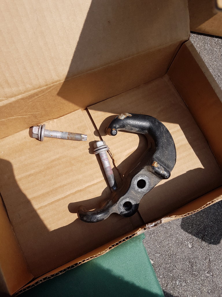

    It might, I'm not 100% sure how different it is from a mobtown skid but it fits with my mob town no problem.
    that just goes into the two existing bolt holes which are only attached to the sub frame/rad support. No where close to as strong as this. And after seeing failed rigging a rated point is invaluable to me vs 'it should be strong enough'
    Its two holes. I know someone else that has it. Honestly would not trust it if you're really stuck and what not.
    If you don't plan on having much of any hard use it might be fine, but if you plan on being really stuck in snow or mud I wouldn't trust it.
    The ARB ties back into the frame in 2 different spots and has 3 bolts in the front.
    Oh and the guy that has that SOS one has the TRD Pro skid, he had to trim it to fit around the recovery point, and he welded his on as well to help strengthen it.

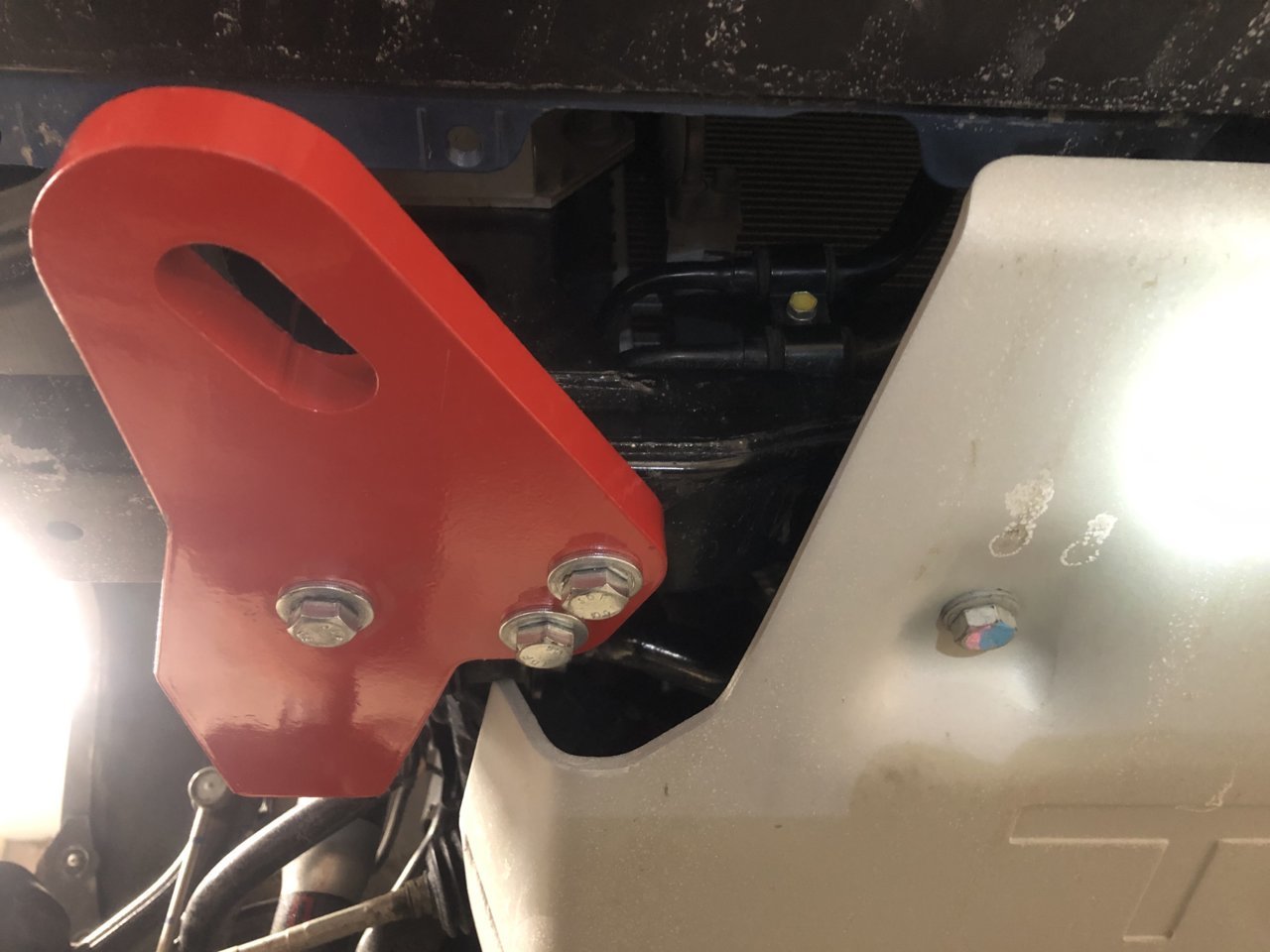

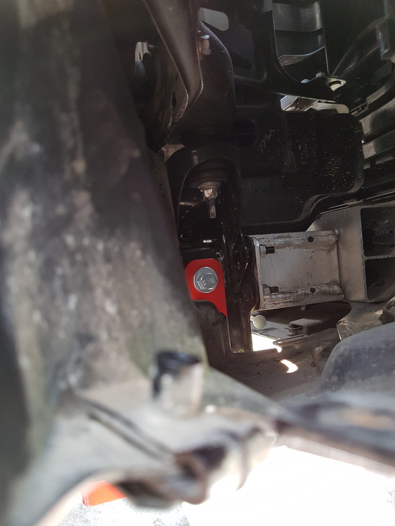

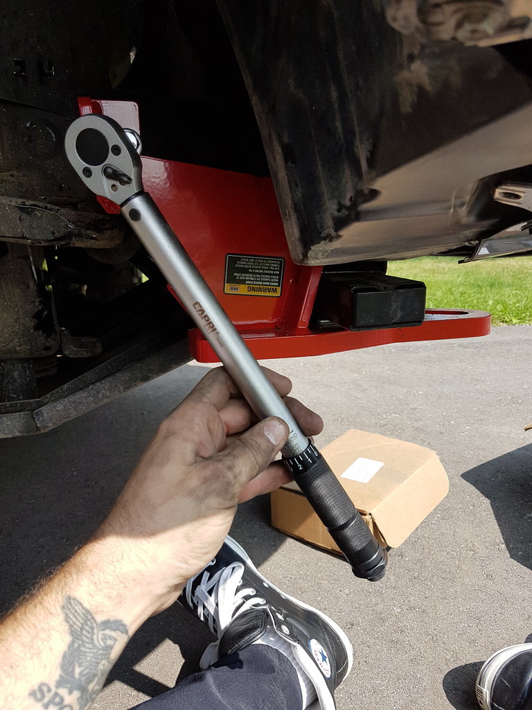

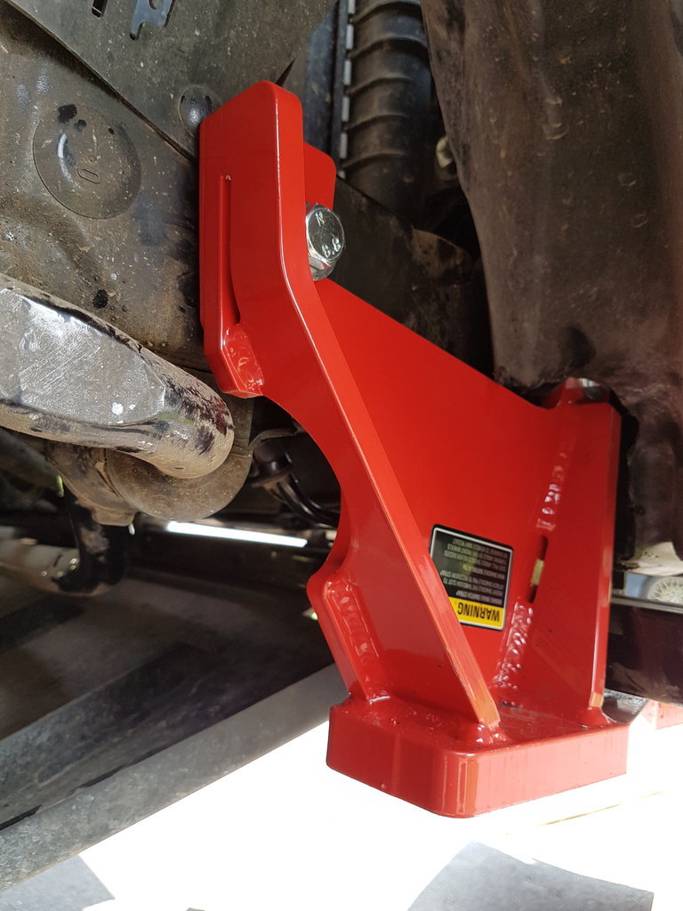

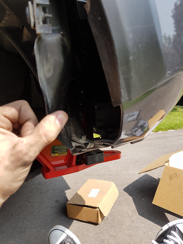

    Easy install other than that goofy nut on a stick. There are no fit issues with the TRD Pro skid. Only unexpected issue was that the recovery point partially covers one of the splash guard holes. So I drilled a new one to keep the bottom of my rad rubber splash guards secure.312C1B81-2540-45E5-BEE9-2E83BF2A8398.jpg
