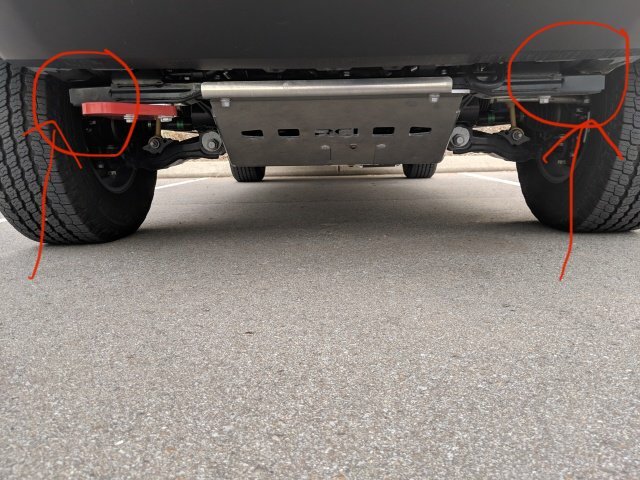

    How visible is this thing from the front on a stock bumper truck?

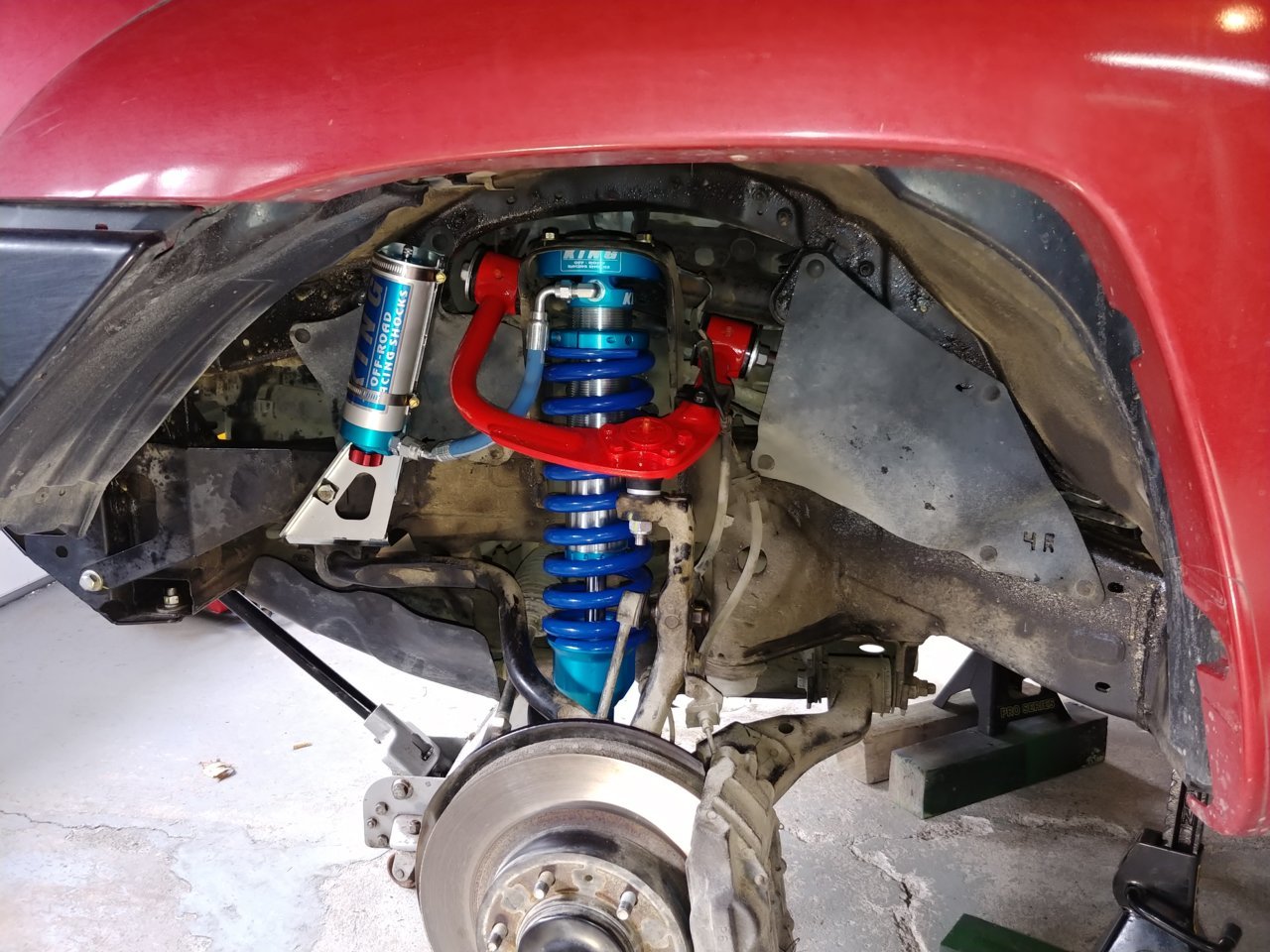

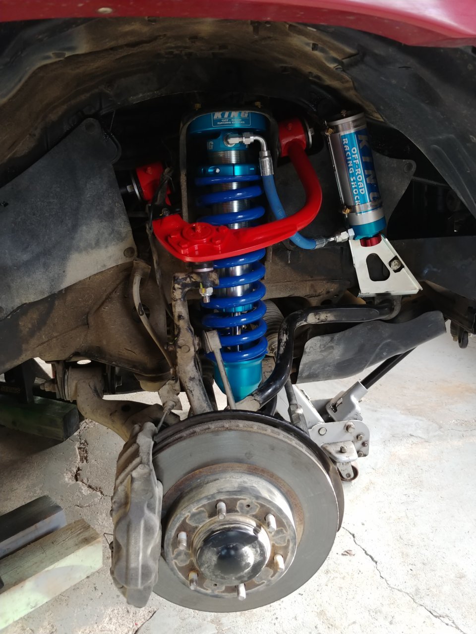

    I didnt get many pictures during install, but you can see where I had to cut the Kings bracket to fit around the ARB 'Y' bracket thing. This is the driver side, not passenger. But its the same exact thing. Seems like the 3rd gen bars dont have this tension bracket?
    Not a great picture, but passenger side:

    Perhaps different for Kings. That y bracket interferes with the reservoir Mount for Fox as well but you just need to bend the Fox one and it works

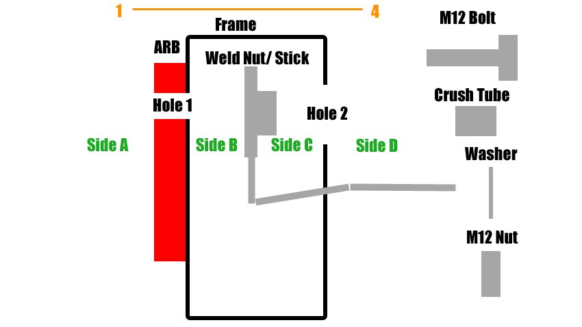

    It's almost Halloween, so I'm gonna bring this thread back from the dead to ask any of the users who has one of these if they installed it themselves.
    I'm having a moment of difficulty with installing the last pieces of hardware outlined in panel 11.
    There's the metal stick with weld nut, M12 bolt, nut, washer and crush tube. ARB says "Just throw them in there!" but they do nothing to explain which order they're meant to go in. The presence of the extra nut is especially confusing.
    So I have the Weld Nut/Stick figured out, but I'm not sure which way to insert the bolt, nor where the washer/nut/crush tube go. The instructions are calling for all of them. I can't seem to insert the crush tube through Hole 1, so I'm certain it goes through Hole 2.

    Looks like the rear bolt uses the crush tube and nut while the front bolt uses the nut on a stick.
    Snaeper likes this.

    There are two crush tubes, the long one on the rear and the short one on the front.
    That does at least appear to clear up which way the bolt and washer goes.

    this post shows the direction of the bolts and where the nut plate was used but not the smaller sleeve

    I'm wondering if @Joe23 didn't use the crush tube as instructed? Sounds like he just did bolt/washer (through Hole 1) and threaded it straight into the nutplate.

    Sleeve was on the front bolt going through the frame. The hole you had to drill out bigger for it to fit through.
    Haven't looked at the instructions since so don't know if they changed the step. But for mine when I got it right when it came out basically, said to drill it bigger

    Yeah that's a different hole and different crush sleeve than the one I'm talking about.
