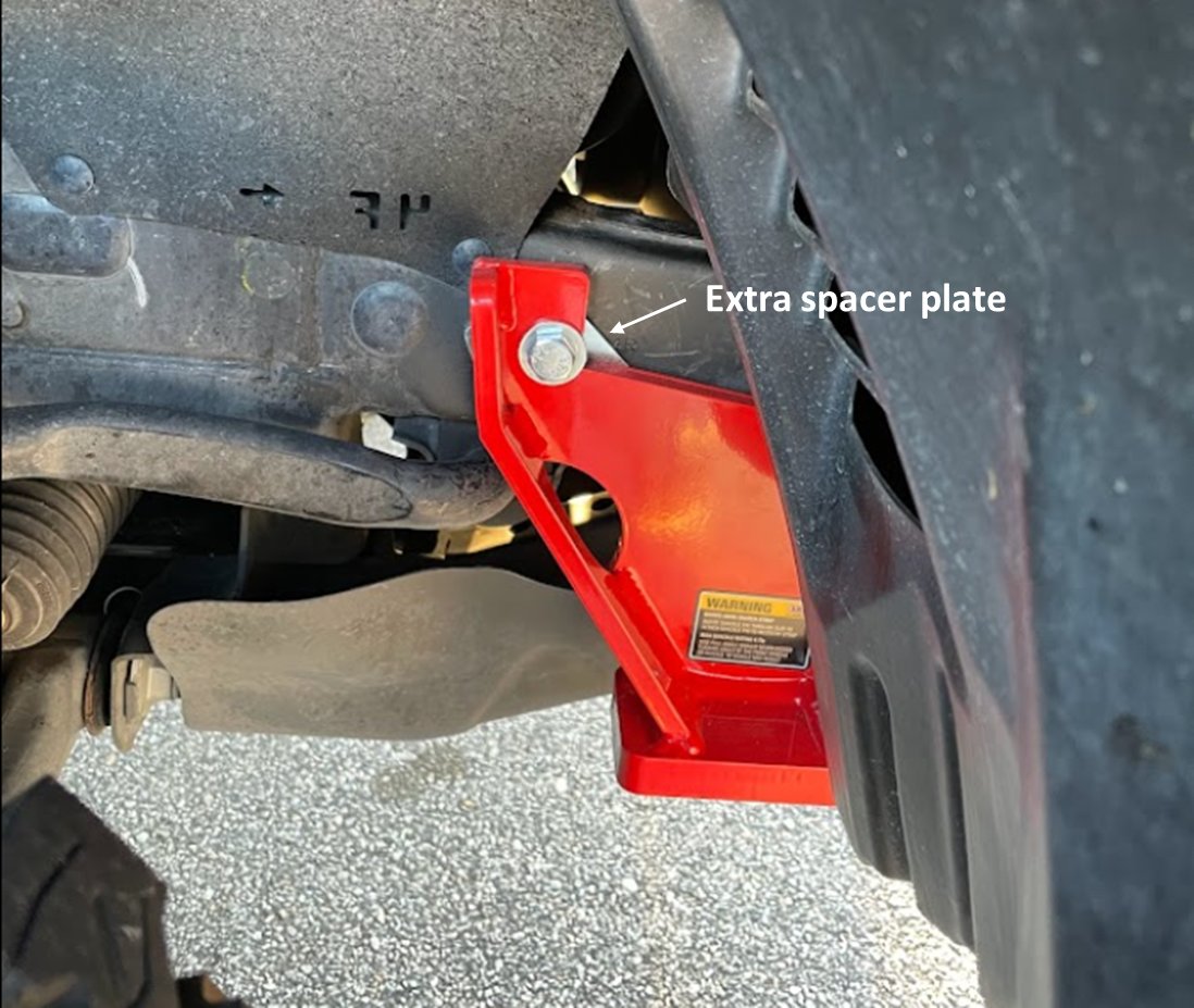

    I couldn't find the instructions in color on this thread but saw a few people had mentioned getting them from ARB. So I reached out to ARB and figured I'd post them here to save some time for the next person. Hope to get this installed over the weekend!

    Yeah, the instructions weren't all that helpful but once you get started it's pretty intuitive. That window you put the "nut on a stick' through in Step 11 is more obvious once you get there. It's just the rectangular hole behind the top front bolt. Getting that nut to line up just right to catch the threads on the bolt requires some cussin' and fussin' but isn't too bad.
    One thing the instructions didn't cover was the need for a spacer between the recovery point and the frame at the rear hole that you have to drill out. Someone earlier in this thread mentioned stacking some washers together. My kit came with two different spacer plates intended for the front of the recovery point (one to use if you have the ARB bull bar and one to use if you don't), so I used one at the front and the other at the rear hole to line everything up correctly. I'll try to grab some photos later for clarity.

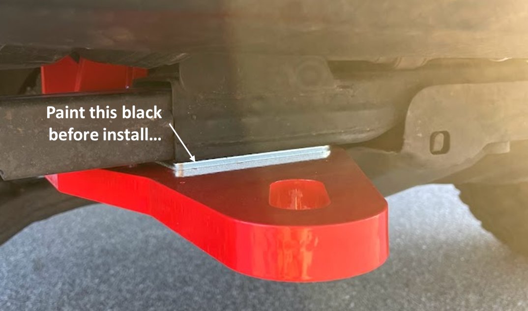

    Right, the thin rectangular metal plate. I had a large one and a small one, both intended for the front. But I couldn't get the recovery point to sit flat across the frame back where the rear bolt was without adding something between the point and the frame. So I just used the spacer plate I didn't use in the front to get everything lined up at the rear whole.
    I didn't think about painting those spacer plates until the end when I stepped back to look at it realized how annoying those shiny plates looked. I'll get those painted black over the weekend.
    I also had to trim off a good amount of the factory skid plate. I don't think other folks had to do that.

    Ah, I see now. I may have had a left over spacer when in was done. You managed to install leaving the splash guard in place, that may be why you needed to space it out a bit. When I installed I had popped the lower clip on the splash guard but then couldn't get to fit back so resorted to a zip tie. At some point I may revisit that.
    Luckily I stepped back when fitting everything and noticed how shiny the spacer in the front was, that's when I grabbed the spraypaint.
    When you say you trimmed the skid plate, what exactly do you mean. The figment with the TRD skid plate was no issue.

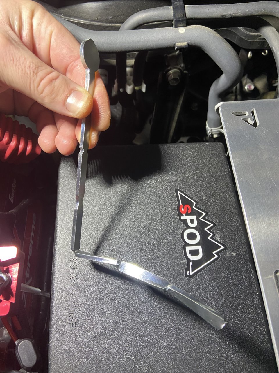

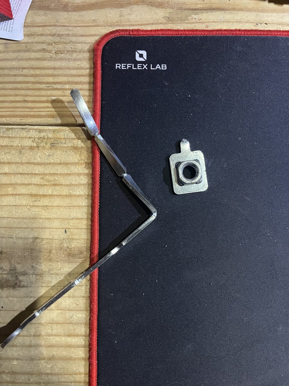

    That little nut wrench broke on me, I’ve got everything tightened down except that one bolt, any suggestions? Should I take the grill out to get down into that hole for better leverage?

    Do you think it’s fine without? I had to pop the grille off, it took a lot of effort and a helping hand, but I got it off, can’t put it back on because it’s cross threaded

    For looks? Yes. But I would not attempt to be hauled out by someone without it.
    Ouch, I was just having trouble threading the bolt and crush tube through the hole and was confused by the presence of extra hardware and washers and the instructions were borderline useless imo.

    Can it be saved with a tap or chaser?

    I don’t think so, but I reached out, gonna get another t-nut and go after it again in a few days
