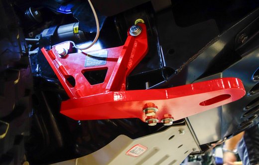

    Any way to avoid drilling into your frame for the install?
  8. Apr 8, 2020 at 9:44 PM
    #48
    TRD493
    TRD493 Well-Known Member
    Dec 27, 2015
    #173269
    1,713
    Dave
    Texas (DFW)
    17 TRD Sport DCLB 4x4 / 01 4x4 V6 Extra Cab TRD SR5
    The hole is already there, you just make it slightly bigger. It was very easy to do.

  10. Apr 8, 2020 at 11:39 PM
    #50
    Coolfinedonewicked
    Coolfinedonewicked Well-Known Member
    May 3, 2018
    #252455
    201
    Kaua’i, Hawai’i
    2019 Cement Tacoma TRD OR DCSB
    Thank you for your response! I should have been more specific. I wanted to avoid drilling the hole bigger to avoid any future warranty faults in the future. I realize it very well may be silly to some, but I’d hate for something like that to leave me at fault for a claim in the future. I was thinking a smaller, but still high grade bolt. But maybe that’s just a bad idea all together considering it will lose considerable rating.
  11. Apr 9, 2020 at 11:59 AM
    #51
    TRD493
    Dec 27, 2015
    #173269
    1,713
    Dave
    Texas (DFW)
    I worried about the same thing but just did it.....now i have holes drilled for my sliders too!

  15. May 24, 2021 at 10:31 AM
    #55
    vecdran
    vecdran Barely-Known Member
    Nov 2, 2019
    #309694
    850
    Jeremy
    Kirkland, WA
    2020 TRD Pro Super White 6MT
    Financial Black Hole
    Just installed one of these yesterday. Torqueing the rear bolt (the one you drill out) was a pain with the clearance, but otherwise it was a straightforward install. The nut stick thing is...an interesting solution to the problem.
    I drilled out a hole through the cover on the radiator side where the nut stick goes through. I'm leaving it in place instead of snapping/cutting it off, so having that cover still there should help keep water out of the frame.
    It's not the bolt you're drilling for, but the crush tube that goes around it.
