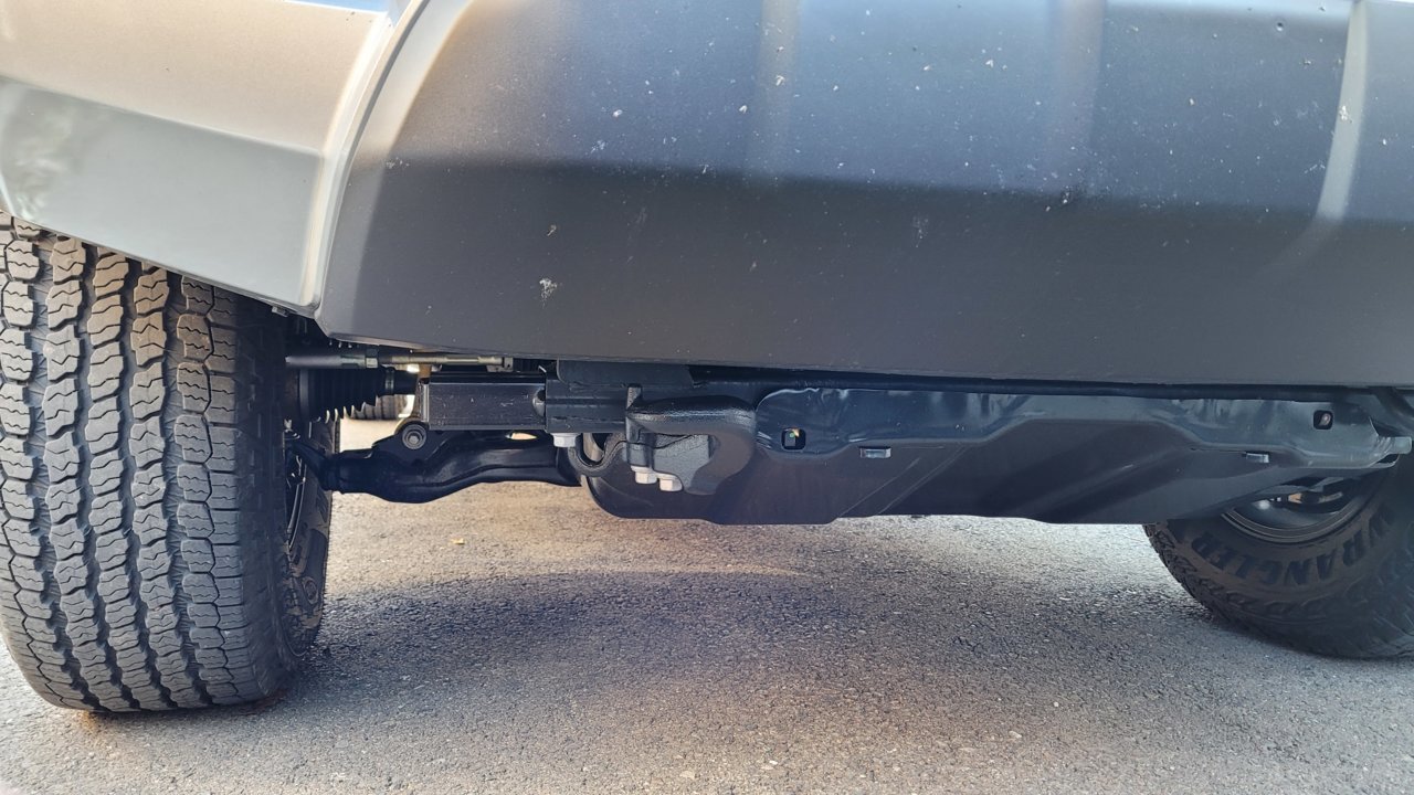

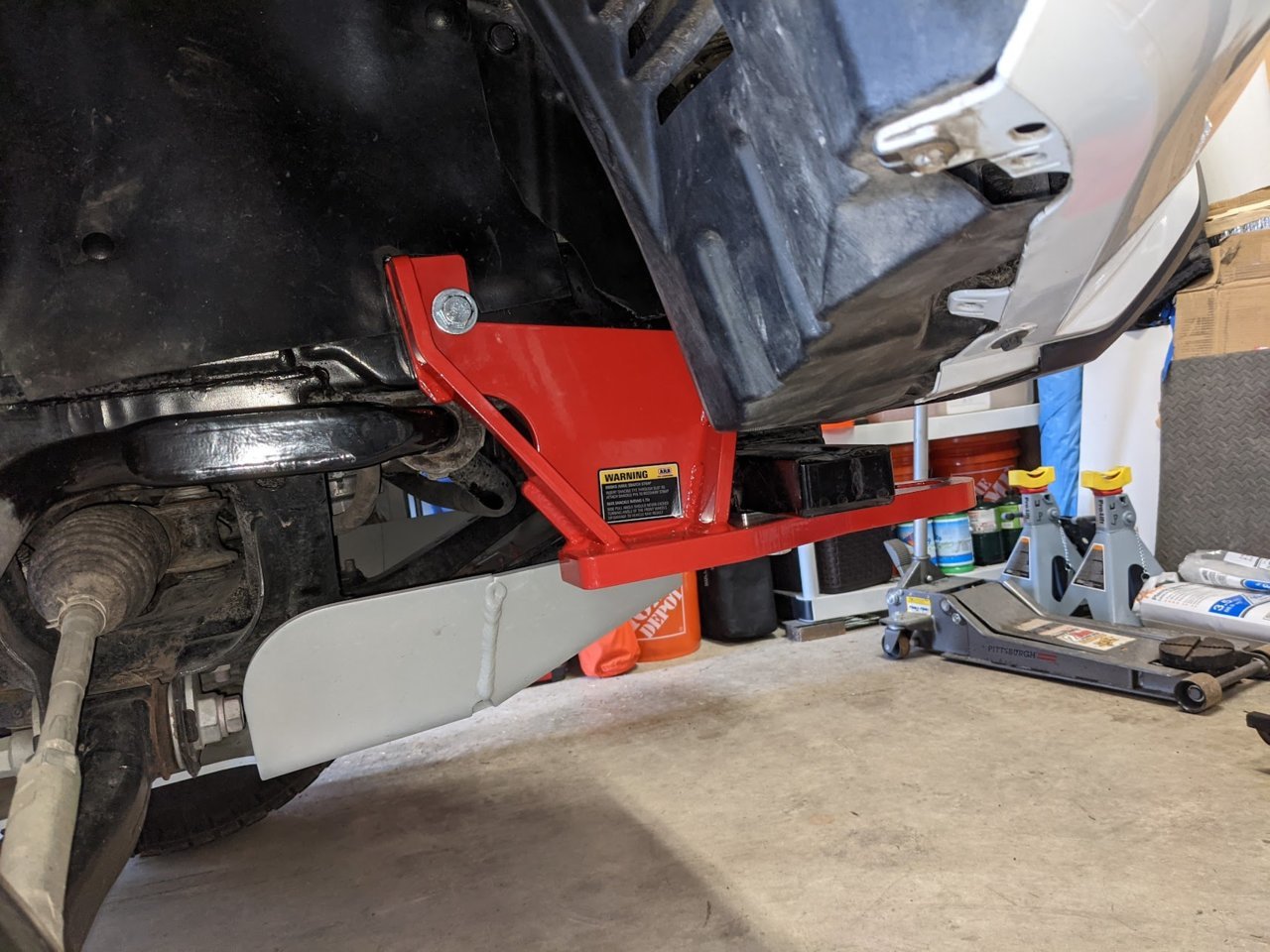

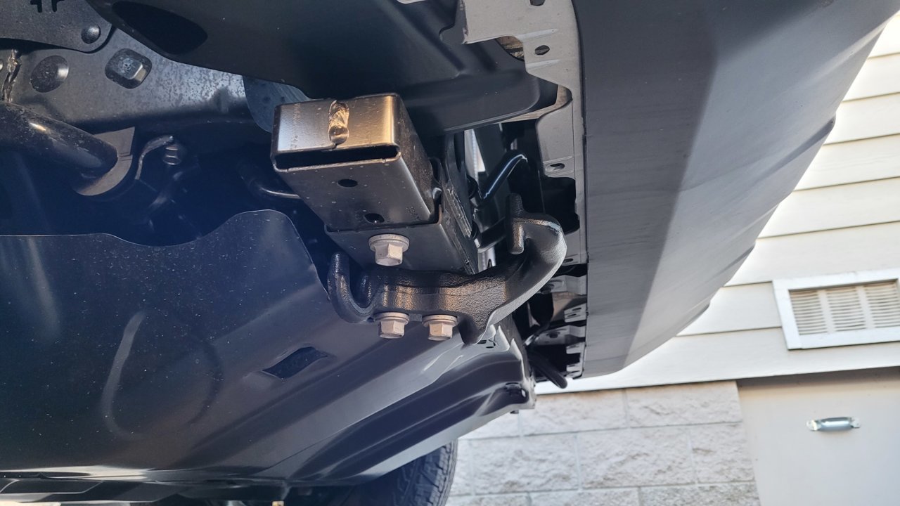

    There is a photo of how the ARB mounts from a customer on extremeterrains website. I’m sure it’s a 2022 but you can go compare on your trucks from the photo. I’ll go look at mine and reference photo a little later!

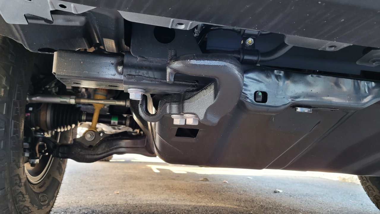

    This is a photo on a 2020 to compare.

    Looks like he still needs the main bolts attached!

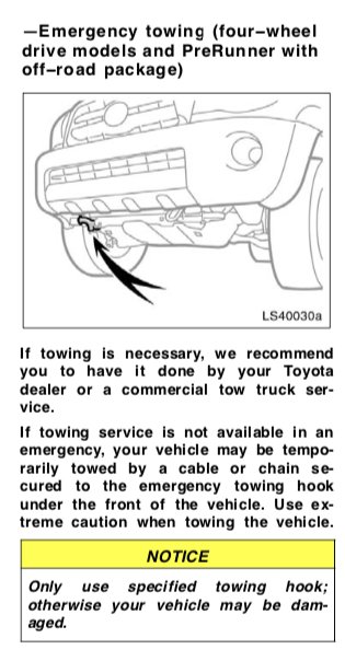

    Note that the OR (and Pro I assume) comes with a recovery hook on the passenger side that is beefier than the loop that comes on the other trims. It’s not as beefy as the ARB product, but has worked for my needs.

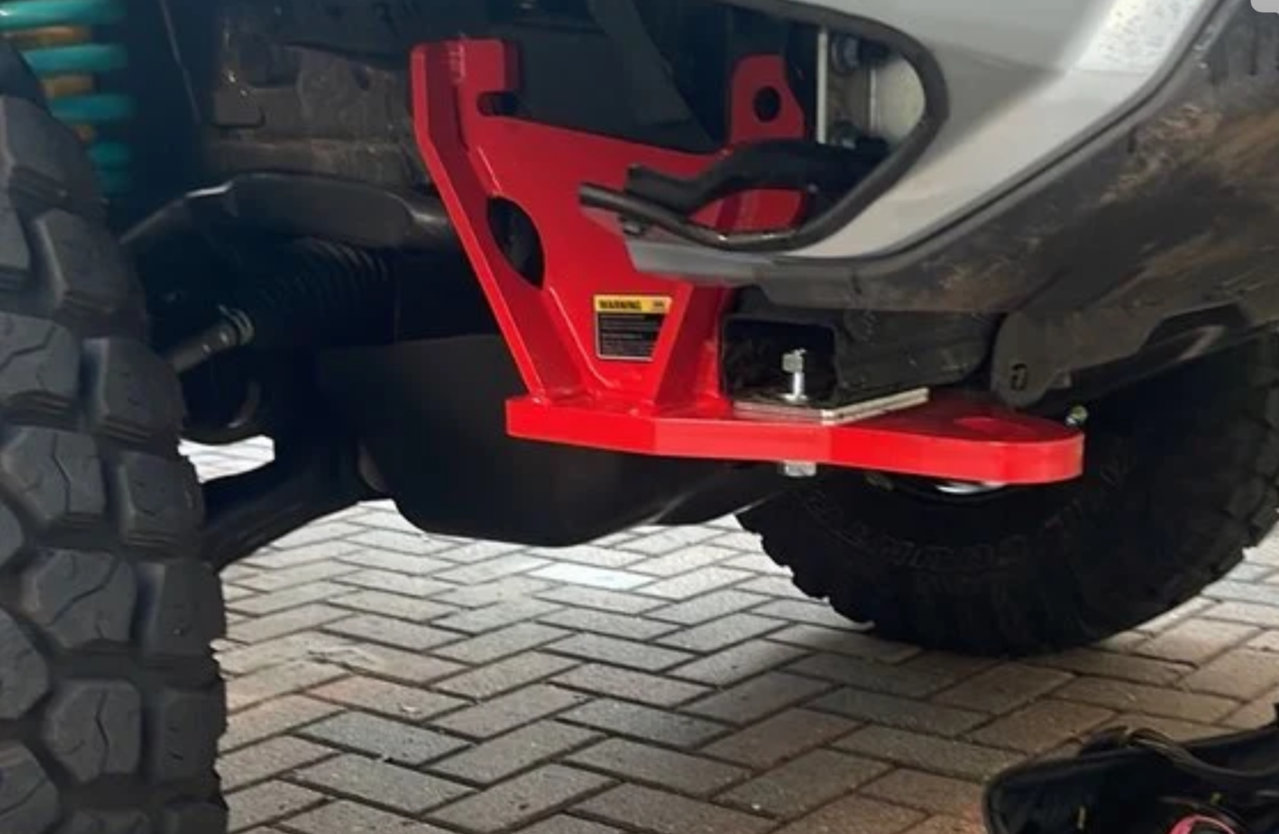

    OP you shouldn't have any issue.
    It is only bolted to the crash bar, and I wouldn't trust it for anything besides flat towing on road surfaces.
    The ARB recovery point is bolted in two locations to the frame, and is the only rated recovery point currently for a Tacoma.

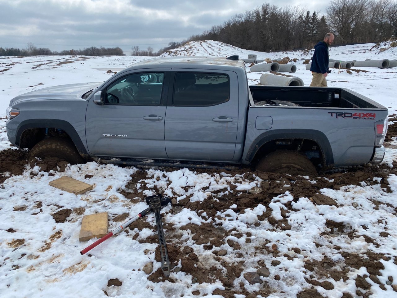

    I’m not claiming it is as beefy as the arb recovery point, but I can say it did not break or bend during a recovery using a 20,000 lb winch when I had my truck buried to the frame in semi-frozen mud. I am by no means guaranteeing it in any way. YMMV.
    I’ve used it in a number of other off-road recoveries as well. No pics though.

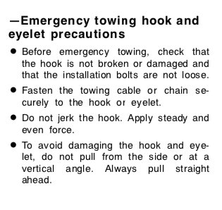

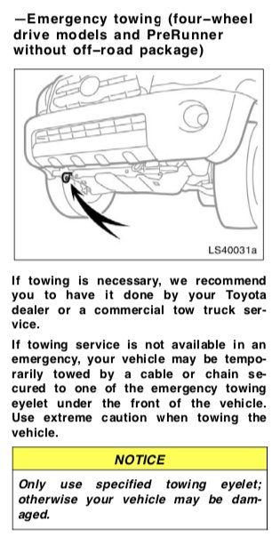

    That is not a recovery hook and is known to bend easily under recovery situations.

    Huh,
    I have an OR and know about it.
    Huh, "
    Tow Hook (Front) Part Number: 5196135080 Supersession(s): 51961-35080"

    I understand is not rated piece of rigging, but there are few options that are. Also, it’s not clear that “recovery point” is a technical term used by engineers or lawyers. I could be wrong.

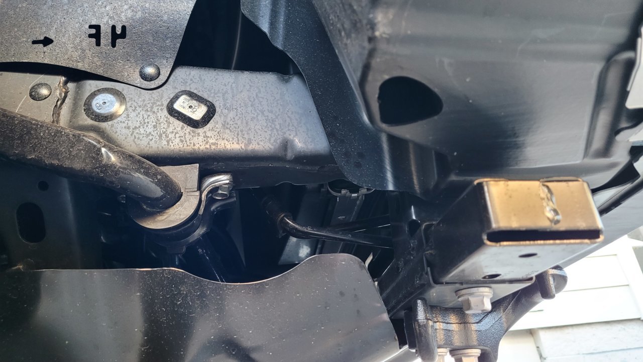

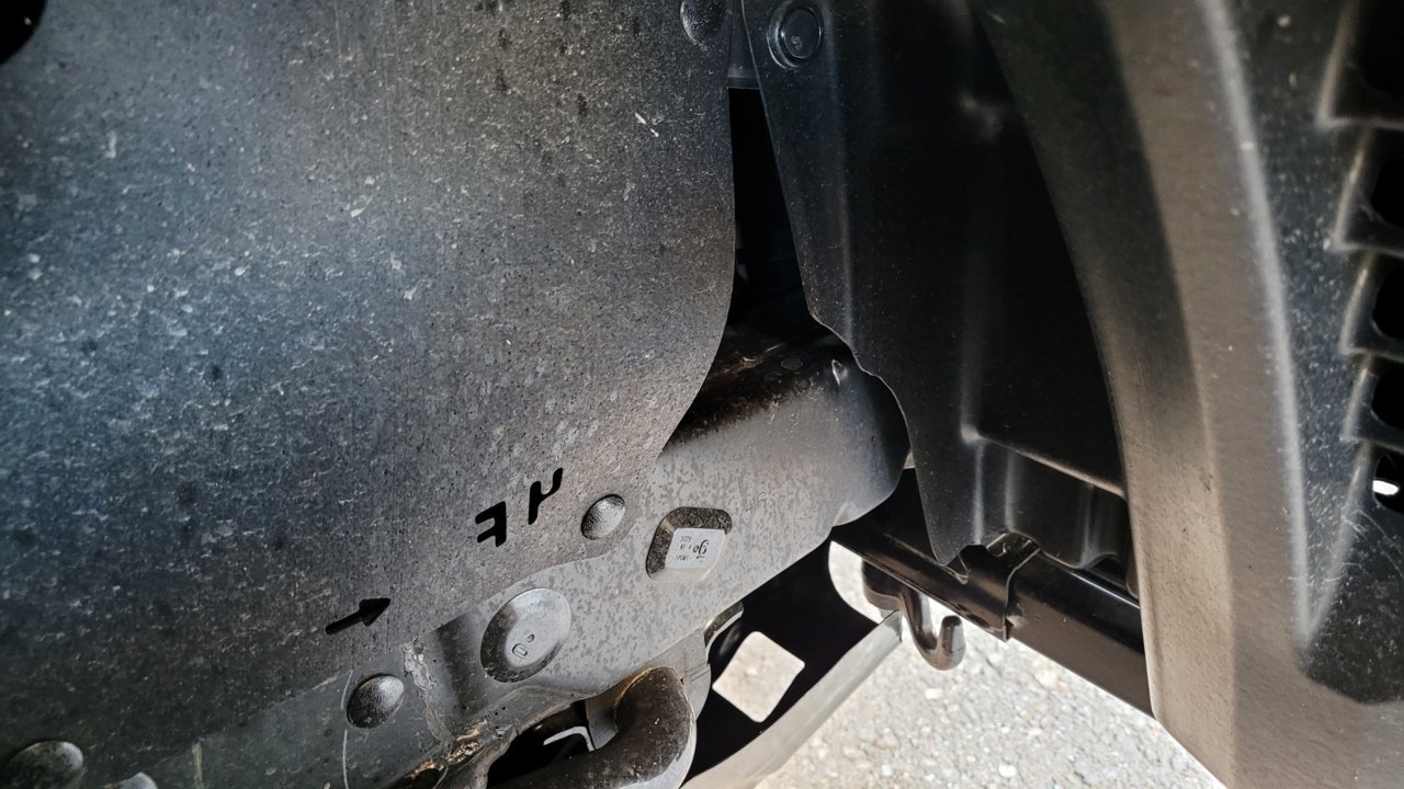

    Here are a few different perspectives.

    Looks the same as my 18

    Thanks Jeremy and Tyler.
