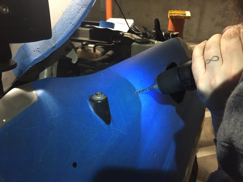

    the install was a little bit tricky, as we faced a couple of fitment issues that required us to drill bigger holes than what the instruction sheet said, its our mistake, as we did align the template correctly however, we drilled at an angle rather than drilling straight, and that when we faced fitment issues. the clips were causing trouble a little bit, but nothing major.

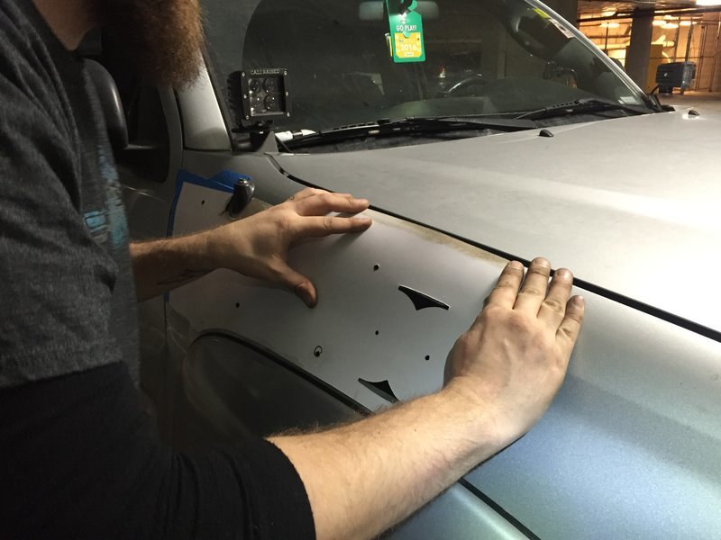

    laying out the goods.

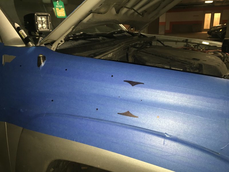

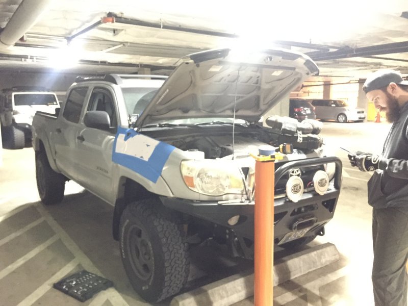

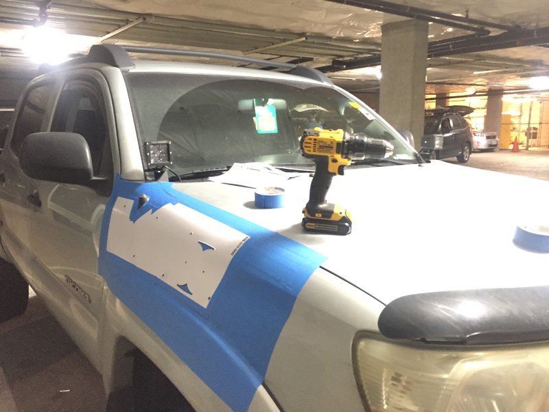

    we might have went a little bit over with the masking tape.... but hey! better safe than sorry, protection is good.
    Jeeps are always lurking around the Tacoma!

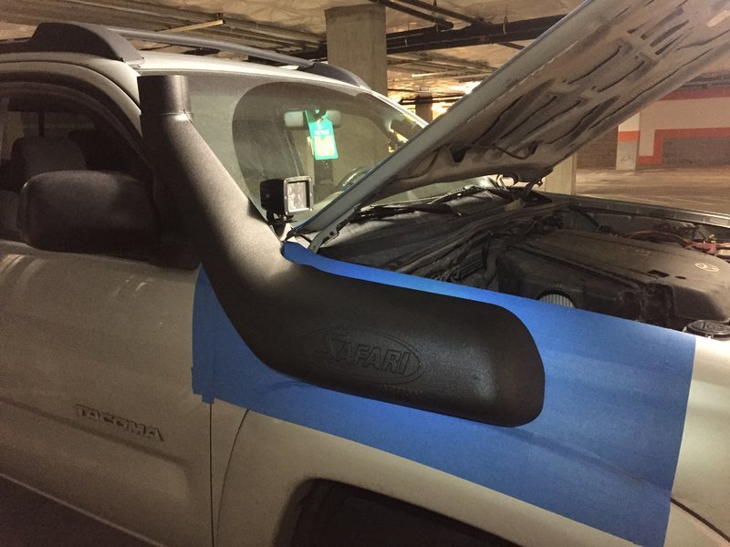

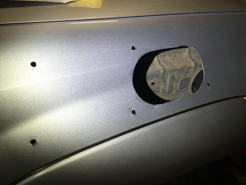

    The outline after we took the template off

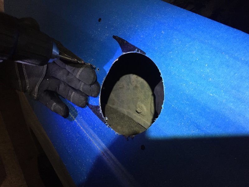

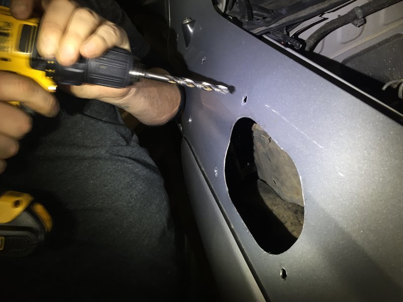

    Making pilot holes for the hole saw.

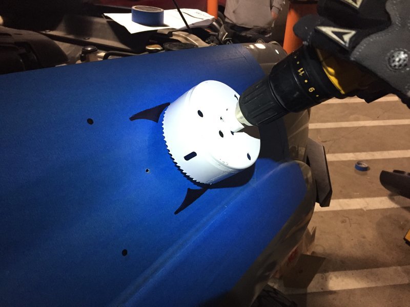

    Then comes the hole saw, the instruction calls for a 4-1/2" but we got away with 4-1/4".
    first hole done:thumbsup:

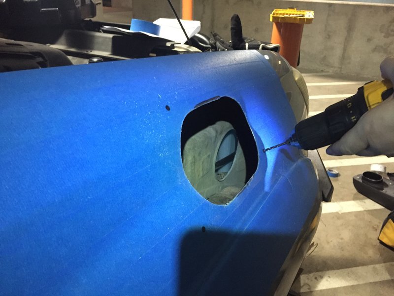

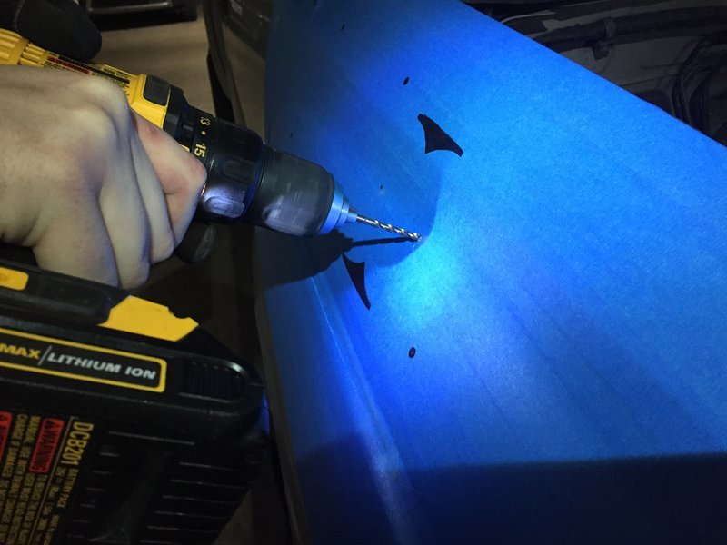

    second hole is drilled. then we started with drilling a pilot hole for the rest of the points.
    more holes
    at this point we wanted to make everything sits flush, and it did! after many tries.

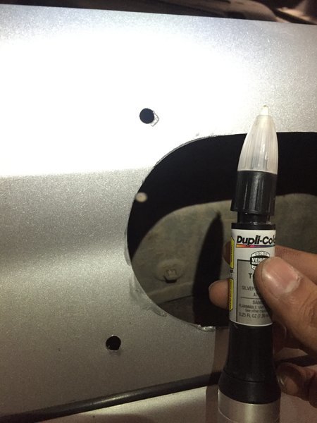

    at this point we painted all the holes we made, I know my paint game is not that good, but at least its going to be covered!:D

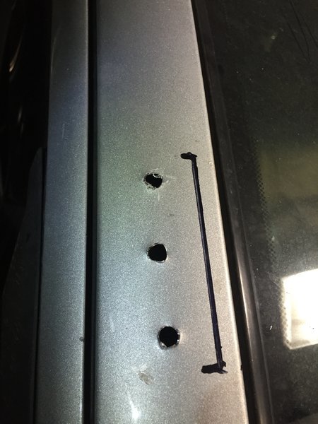

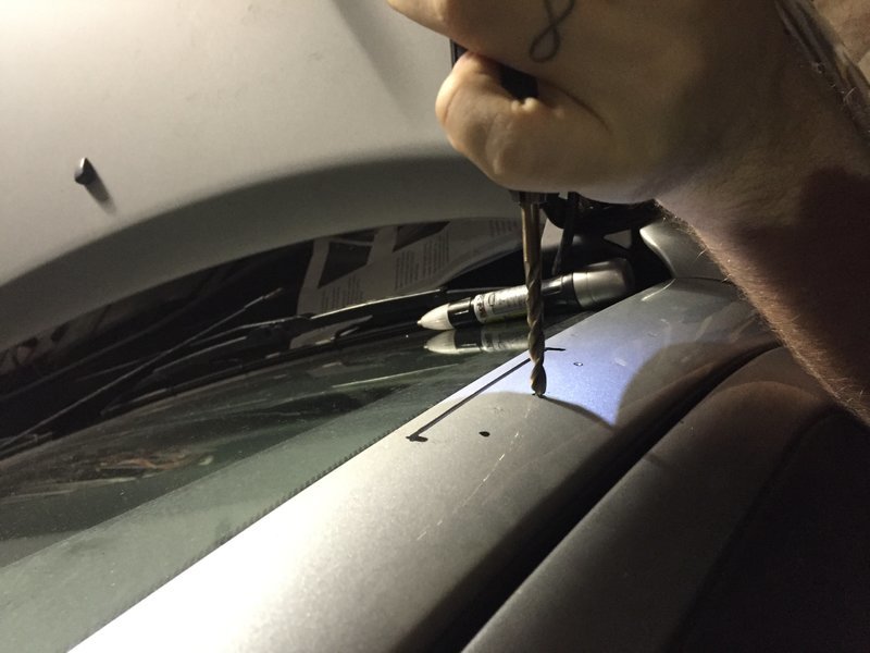

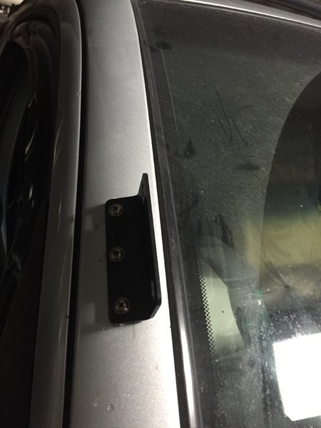

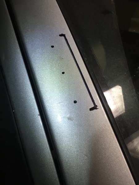

    making the outlines on the A pillar for the bracket, I was more stressed about drilling the A pillar than drilling the fender!
    making pilot holes.
    no comment here:anonymous:, we cleaned the holes well before the final install.
    bracket goes on.

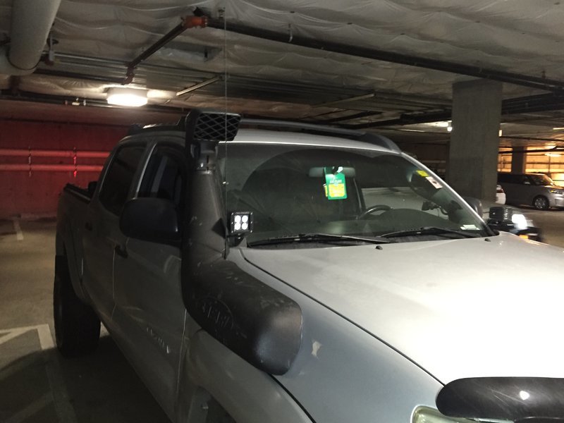

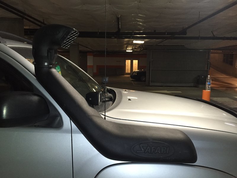

    the end result! the snorkel is well worth the money, it not only adds a protection measure for the engine and ease of mind when crossing water, but it looks beefy!

    I didn't drill my pillar for my airflow. Just used 3M automotive mounting tape. Been solid for over a year now. Easy to change a fender, A pillar, not so much.

    Did everyone repaint their holes after cutting?
    Anyone have signs of rust for not doing it?

    You gotta paint, it's bare metal exposed to the elements.

    yes...I went to auto zone and just bought some color match and painted. not that you can see it under the snorkel...but you don't want rust
