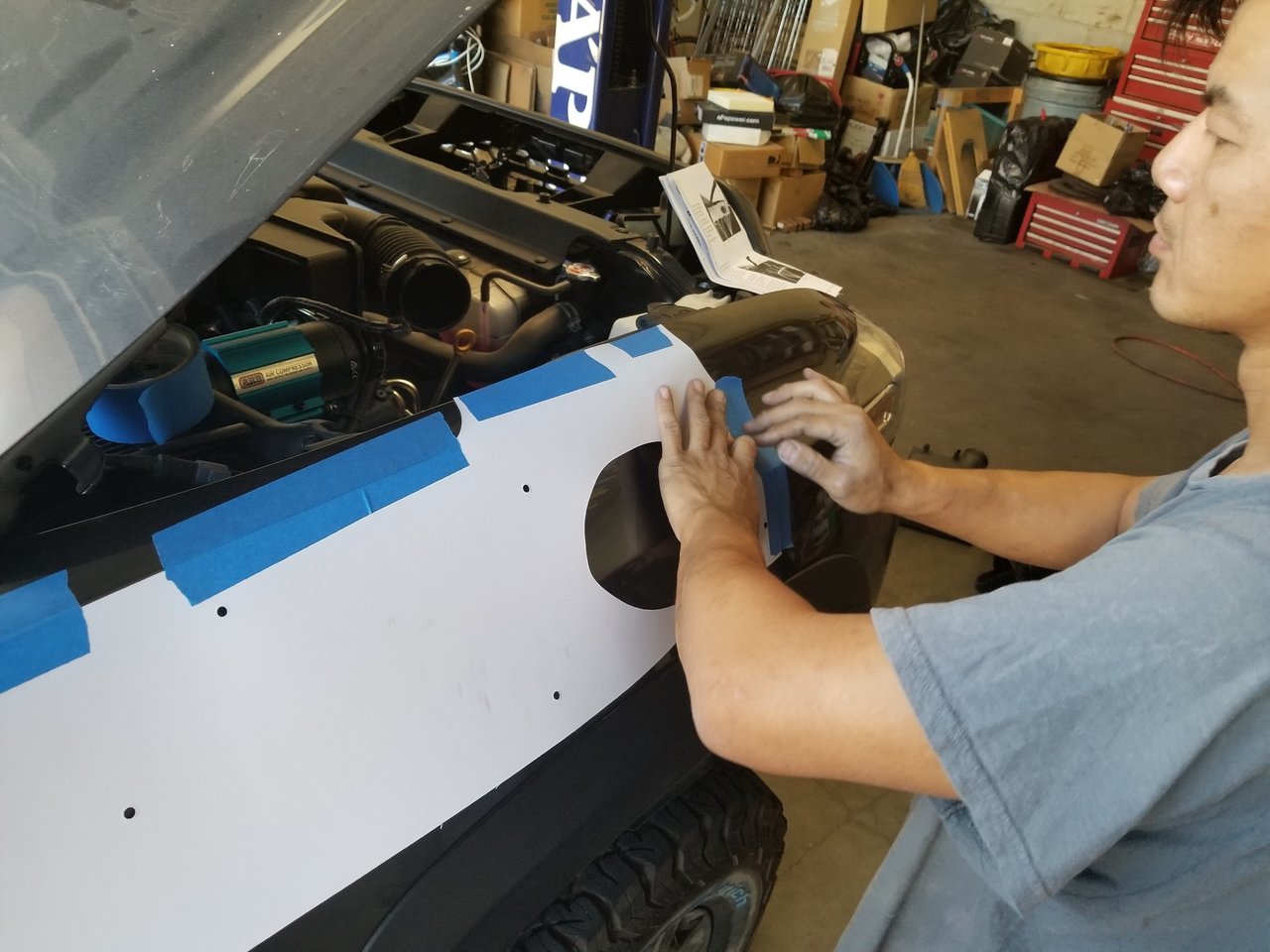

    for those interested I got the PDF from ARB
    picture is of an inferno so its much easier to see with the template then

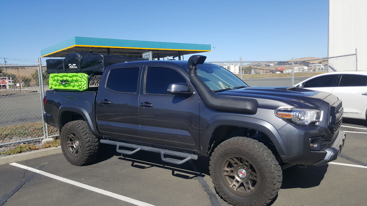

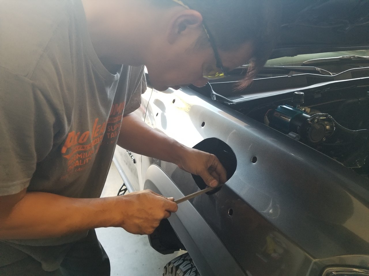

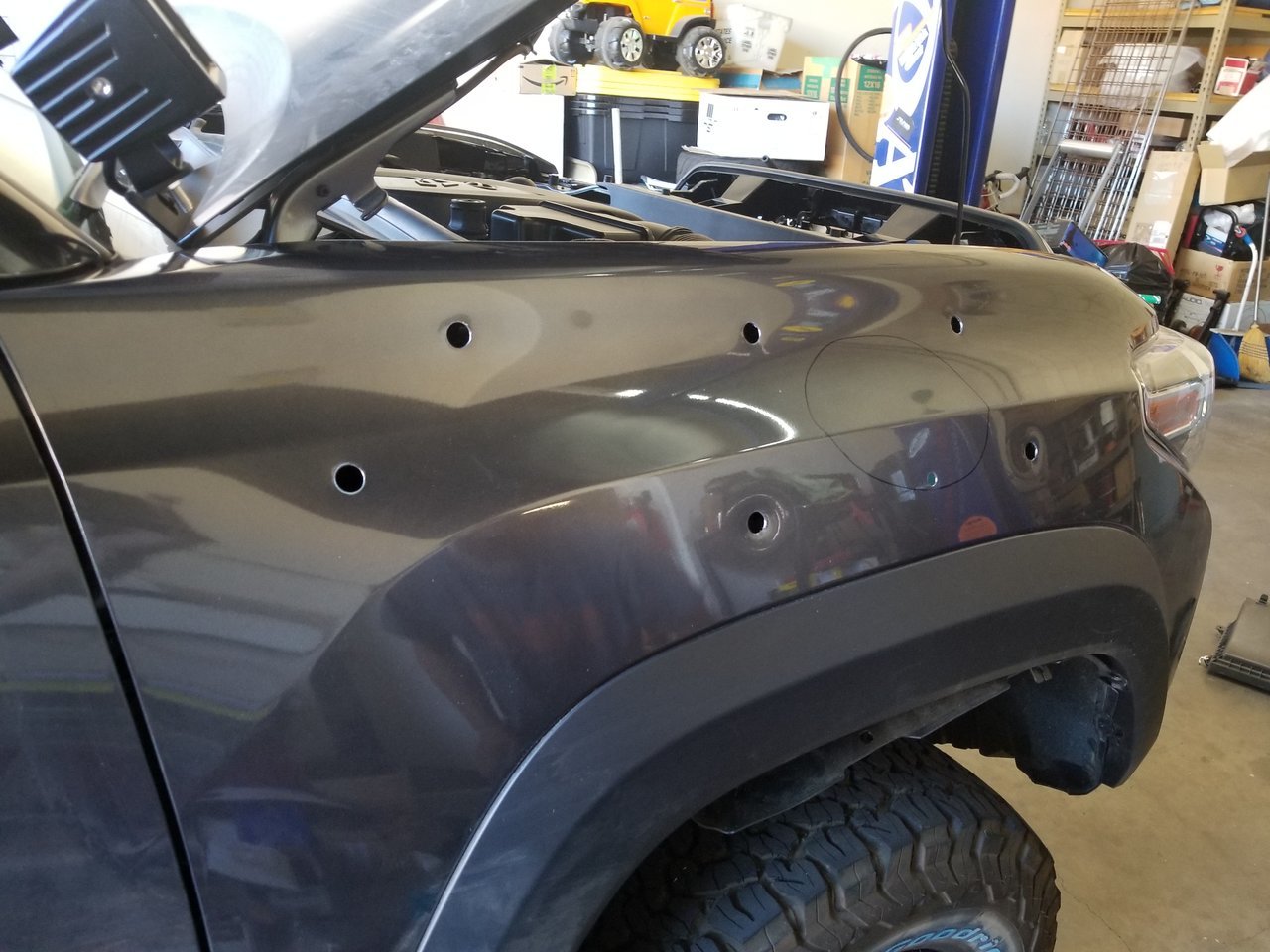

    installed the ARB Safari snorkel yesterday. If you use the template that comes with the snorkel the holes will line up perfectly. The cutting part was not as easy but if you take your time and not rush things you will be fine. Drilled 60mm holes for the set screws and it worked fine.
    If you have ditch lights. Unmount them and the bracket mount. The snorkel will not fit with it on. Well atleast mine didnt.
    I used toyota touch up paint from autozone after the cutting and drilling holes to prevent rust.
    For the top part of snorkel the instructions say to drill 3 holes into the A pillar. I did not do this. I used some real strong 3M outdoor Tape and its on there pretty damn solid. For the offroading im doing im not worried.
    After everything it fits perfectly and mounted the ditch lights and that fits but barely. Im happy with it.

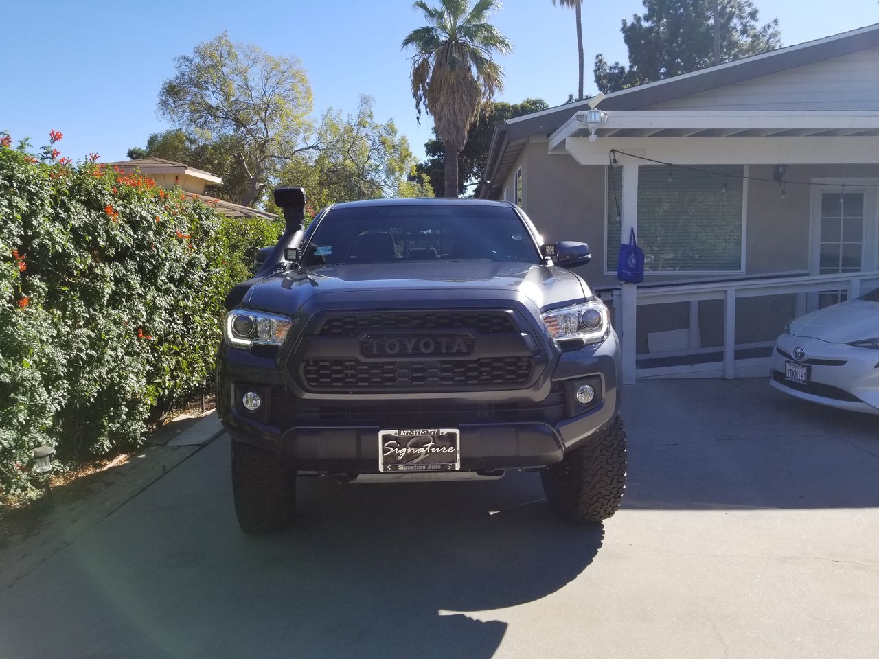

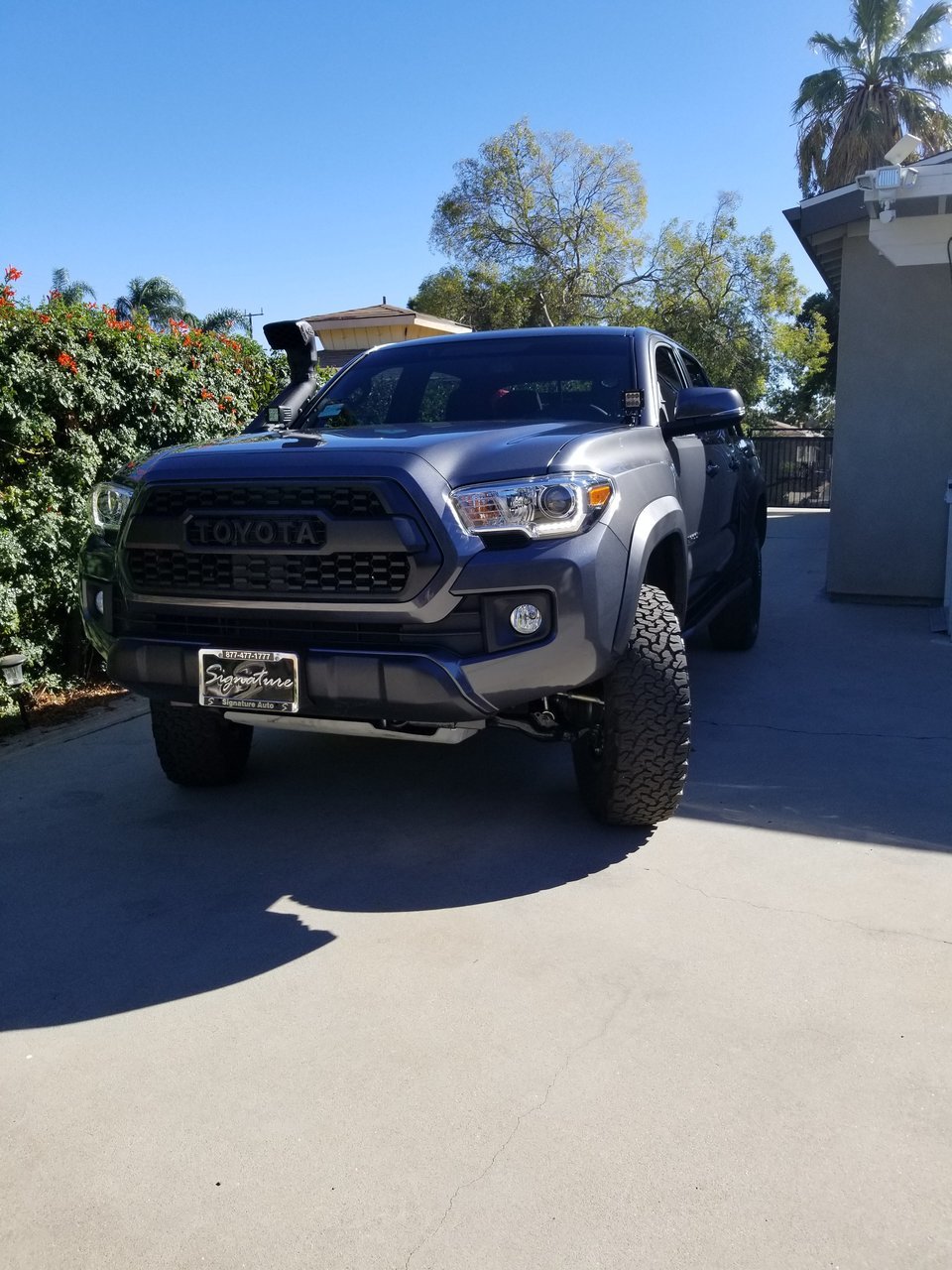

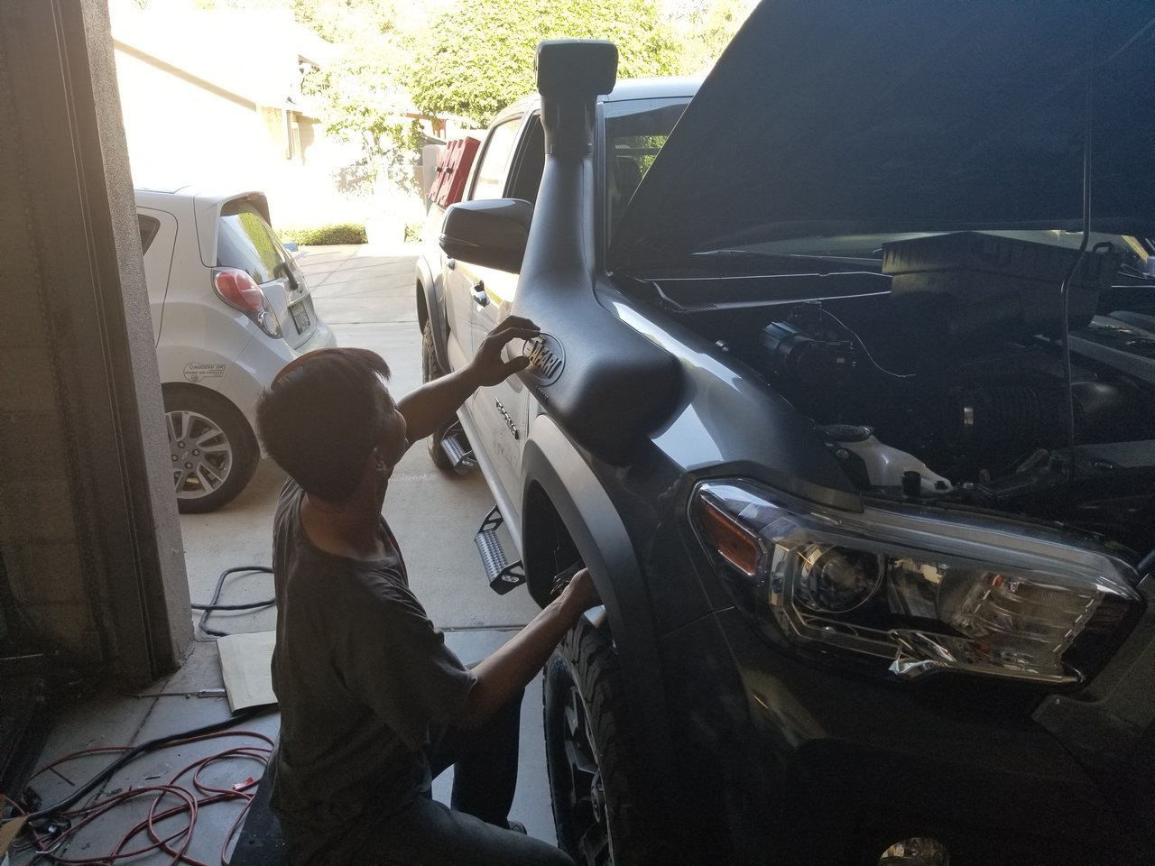

    Yeah after the first 4.5" hole, I just started sending it on every hole after that lol. The drill silences out your truck's screams for help pretty good. I also had issues with the CBI ditch bracket hitting the Snorkel. Took the bracket off and dremeled off maybe a half inch and then re installed and it clears perfectly now.
