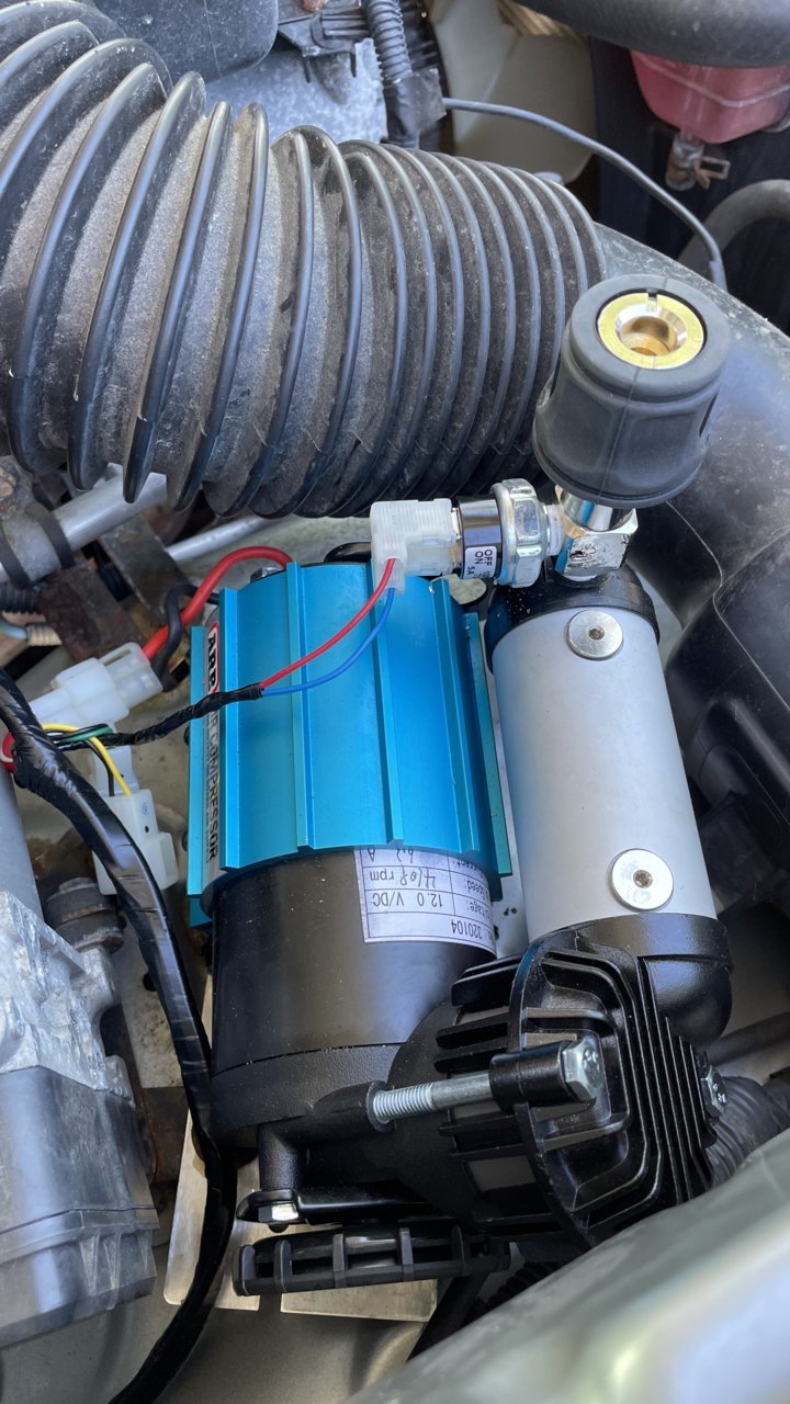

    Engine bay i modified my switch pro bracket to make it fit only had to drill out one hole and use a spacer underneath to make it level A0A15FDD-BD18-4EB2-9CB2-E71EEFFB9D80.jpg44BA872C-9E01-4298-8C50-91331DE2ED9F.jpg

    It looks like it uses the same mounting plate as my locker compressor. I used the mounting plate to build a simple bracket to pickup existing bolts, works with the stock intake in the first pic.
