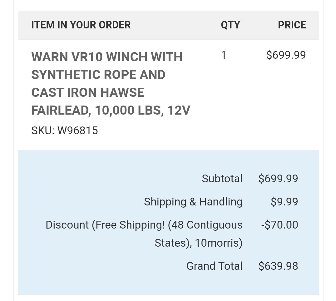

    I think the 12 is overkill. I was shopping for a VR8-S and got a great deal on the VR10-S.
    The Solenoid pack can be relocated which almost certainly will need to be due to the Tacoma having a brace dead center at the bottom of the grill.
    They do sell a $13 metal plate that makes it easy.
