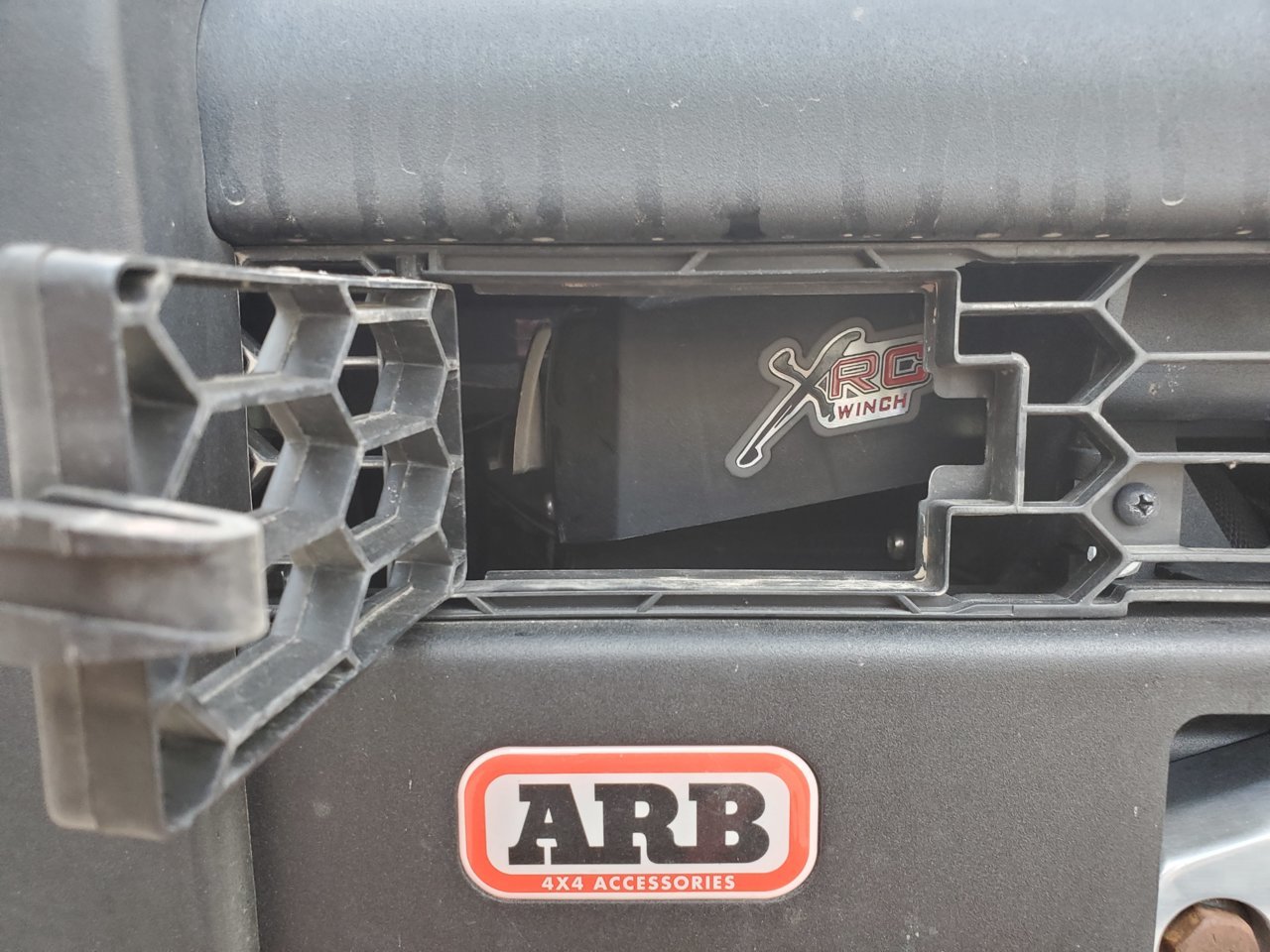

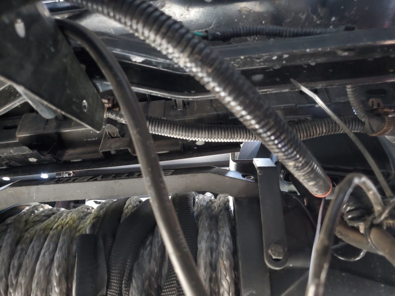

    This is going to be really hard to see but it's almost impossible to get a decent picture as its inside the bumper. One picture is from the front through the access for the winch controller to plug in, the other is from the back (just stuck my phone up inside to blindly take a picture)...
    There is a bracket that comes with the xrc winch to mount the control box...its that little bracket witg a black bolt head just to the right of the winch cable. I think i had to drill a new hole in that bracket to move the box off to one side more but its not going anywhere. Not too hard to access the plug in for the remote so it worked out well
