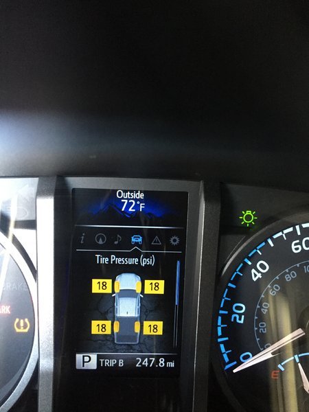

    Deflater Tip:
    I painted my Staun Deflators each a different color for a couple of reasons:
    Two ways to use them.
    1. Set each color at different pressure, for different terrains. I do have to use that same color on each tire, four times-as long, but that is ok and well worth it. Example a color for each: Desert, Beach, Dirt or Rock. Please see photos below.
    or
    2. Set all to the same pressure. Fast truck deflate time. By time I put on the fourth one, first one is done.
    I always put them on in Red (LF) White (RF), Blue (RR) and Black(LR) order, in case one is off pressure after an air down per my Tacoma truck gauge. Then when back home, I know which one to tweak/correct for my next adventure. This helped me stabilize the initial settings. They generally stay correct once set.
