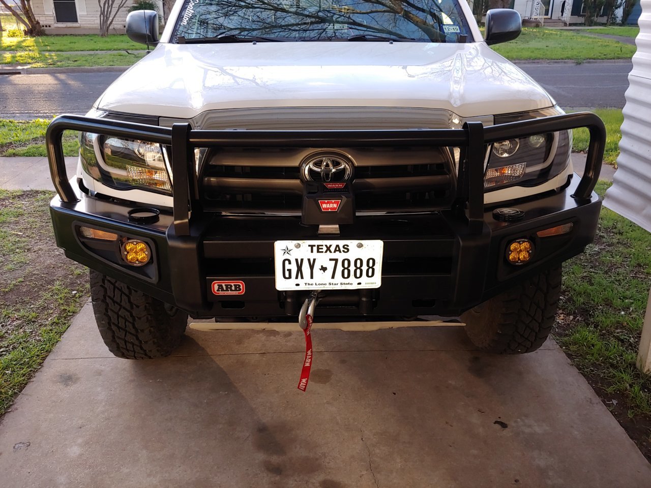

    I've been wanting to replace the less than stellar quality that comes with the ARB bumpers in regards to the lights that it comes with. I ran across these one day and was wondering if anyone knew the manufacturer or if it was a one off project.

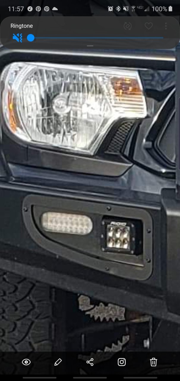

    I've seen similar LED conversions. Here's what Kurt Williams of Cruiser Outfitters has on his 200-series Land Cruiser. He told me a year ago that somebody was making these, but I don't know who. When I saw his truck a few weeks ago the black powder coat was coming off, so take that for what it's worth.
    I'm not aware of a LED with a true low-cutoff light pattern. The Rigid LED cubes are more driving light than fog light, AFAIK.

    The picture you posted is the Slee bracket just like @Greytacoma1 linked above. They still use the ARB turn signals / marker lights. The only thing that lets you do it add aftermarket fog pods if you want those for some reason.

    I have the Paranoid Fabrication fog light adapters.

    There are many LED cubes with true cut off fog beam patterns, you just need to look for SAE J583 spec. Rigid is the best of them. https://www.tacomaworld.com/threads/the-led-sae-j583-fog-pod-fog-light-review.554813/
