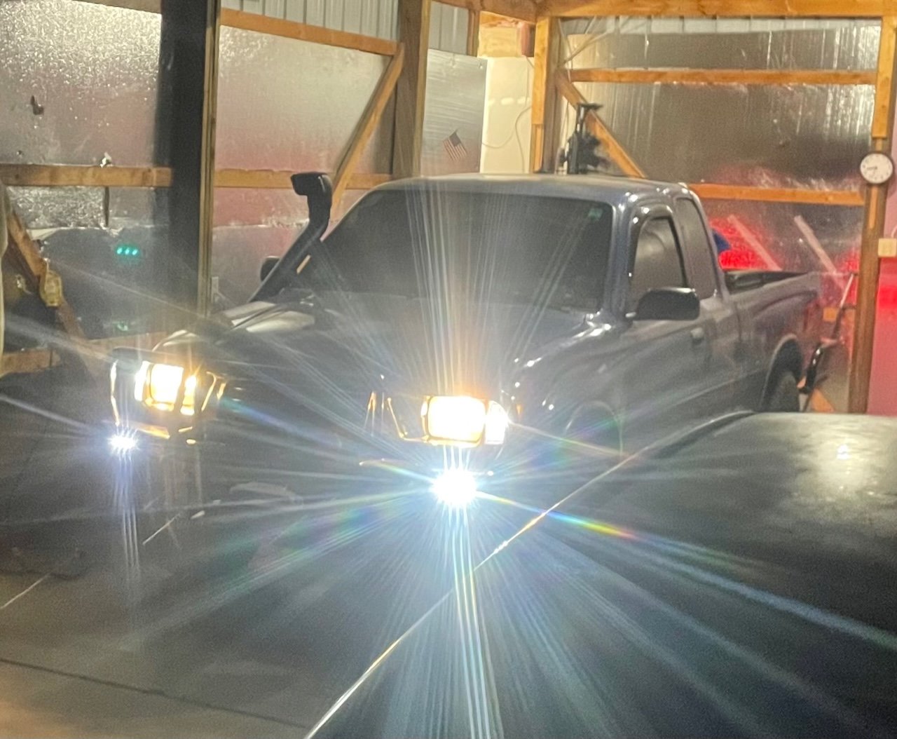

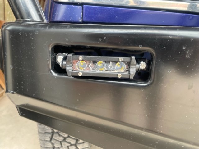

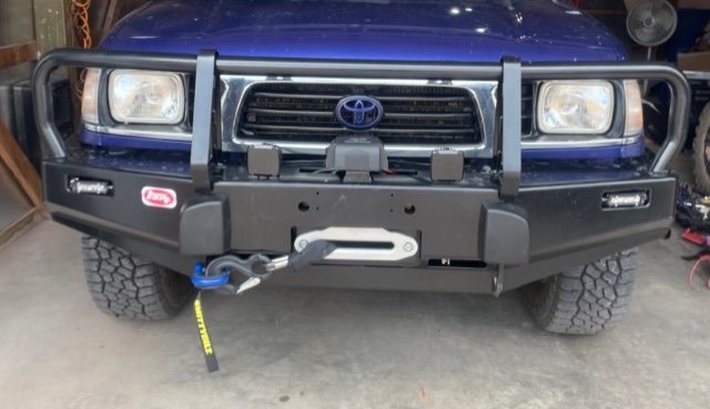

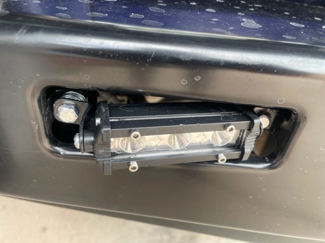

    Reviving this from the dead. I got some small lamps from Amazon (https://www.amazon.com/dp/B07CZ5K61W?ref=ppx_yo2ov_dt_b_product_details&th=1) to fill those turn signal spots in. I shimmed both sides (7 washers outside and 6 inside) to get them straight and wired them into my running lights, which I may rewire into my off road lights but these help with those lesser bright headlights. They don't seem to be to bad for oncoming with the shimming and they aren't super bright like some, almost just right.

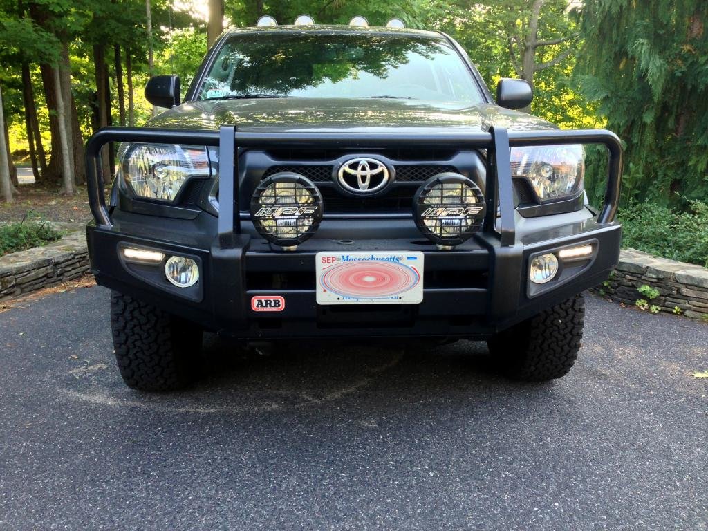

    I ran a Philips Daylight 4 LED DRL kit in my ARB.
    It was brighter in person than in photos. I believe they've come up with new / improved versions as this was from 2014-2015.
