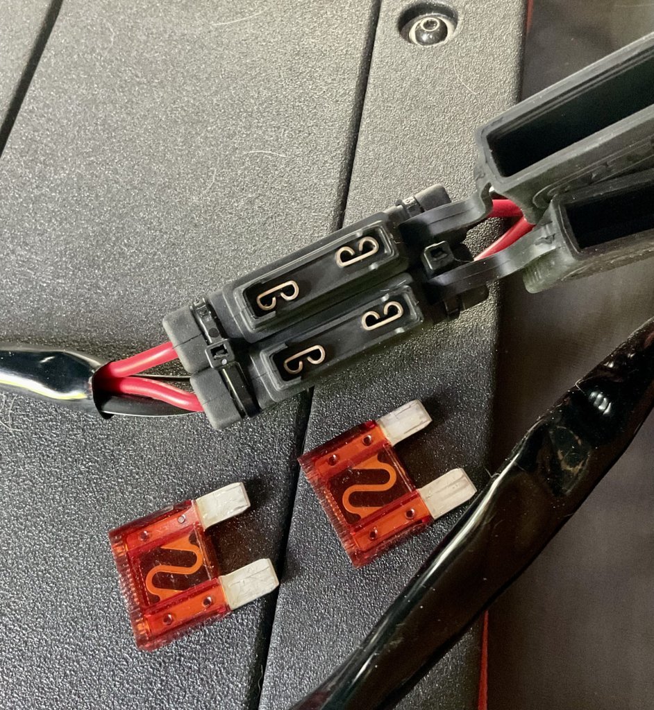

    The compressor should have two fairly large fuses where it connects to the battery. Pull those and test continuity of each with a multimeter; they can appear "good" even when they're not if you're just looking at them.

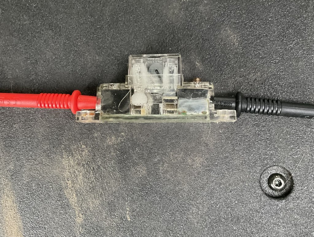

    I did a little checking today. There are two inline 40A fuses in the compressors wiring harness. They both checked out good. I have another 80A fuse just before the positive terminal on the battery. That checked out open. I will replace and recheck. This would be nice if my troubles end right here. I truly appreciate all of you who took the time to lend me a hand. Much respect guys.IMG_3819.jpg IMG_3818.jpg

    Blowing an 80, and slowly looking at the heat effect. Something else seems amiss. Make sure all your electrical connection points are clean and well tightened.
