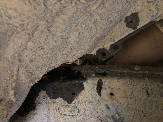

    I appear to have an oil leak coming from my compressor...anyone ever have the same issue...?
    Where could it be coming from? Photo is from directly below the compressor.

    just to be sure, it's not your ac drain splashing the frame rail?

    Yup, I actually did the mod to carry the water away from the frame. It was oil for sure...I can't trace its origin.

    You take it apart yet to see if its just a seal you can replace?
    I had one of the pair in my twin fail. Bought a single and replaced the broken one of the pair. Back to full air again :cookiemonster:

    just visual inspection so far. I’m not familiar with these mechanically speaking…do you happen to know of a video or an exploded view I can use for reference?

    Looks like the compressor wasn’t the leak. I may have driven through a puddle of oil that splashed into the wheel well and on the frame. The exist to the ORV park I was in is typically a graveyard of poorly maintained rigs breathing their last breaths.

    Do you have an ARB locker?

    Yes, Front and Rear

    That’s oil from your diff the venting out the solenoid most likely. What’s it look like under the hood?

    A little oil up by the compressor.
    Just check front diff oil and go about my business or should I be concerned?

    Only my rear locker spits oil, pretty common. It should be fine, it’s a pretty small amount of oil. I put a catch can on to keep the oil from spraying everywhere like you are seeing, and with maybe 50 on/off cycles there was a teaspoon of oil.

    Most certainly is the air locker. Mine is so bad my fluid level was low and I had to refill. Here is my thread. Just FYI ARB says this should not be happening on newer lockers. Raise hell and join the angry mob I’m forming. We have attorneys!
