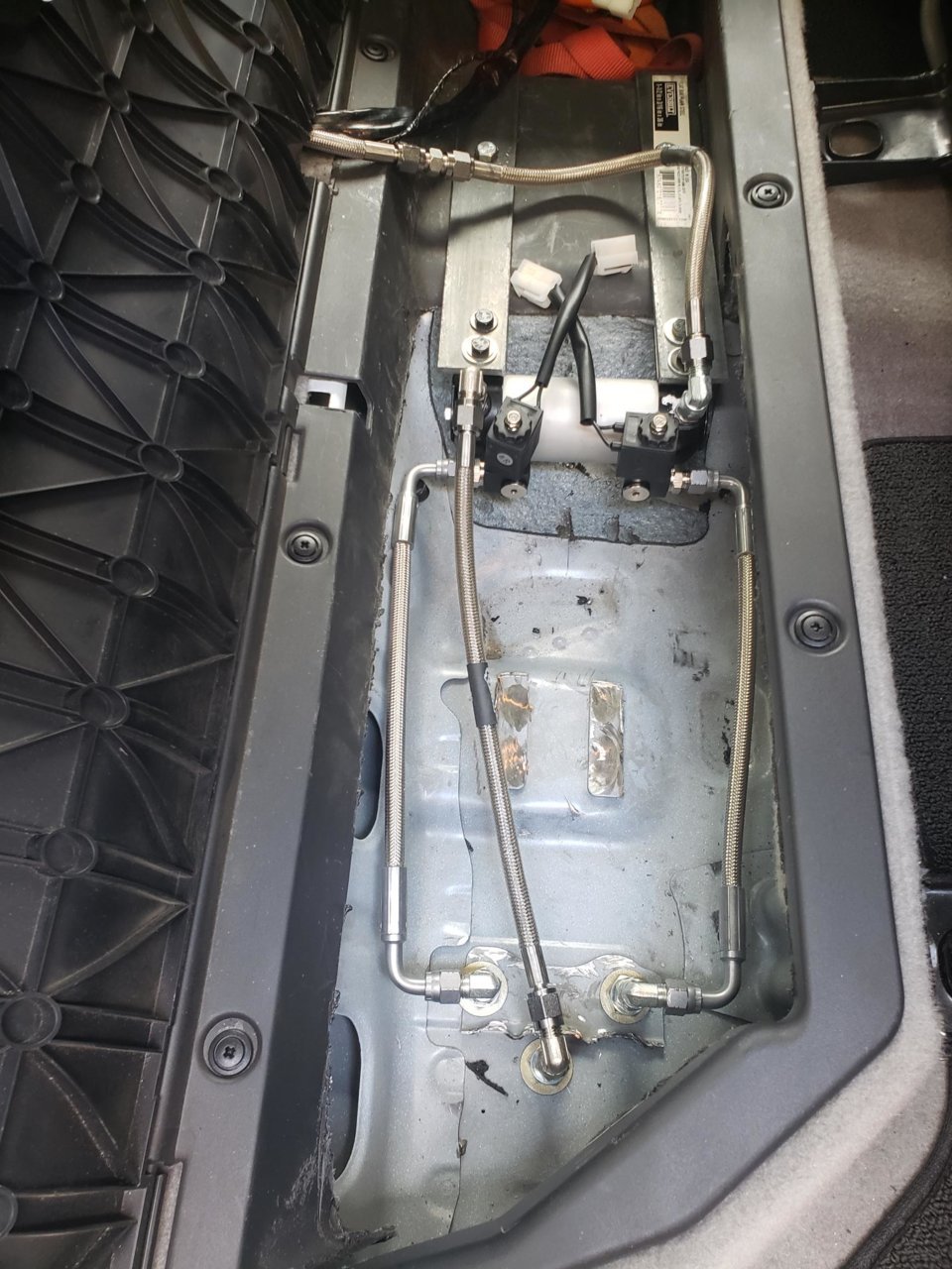

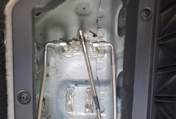

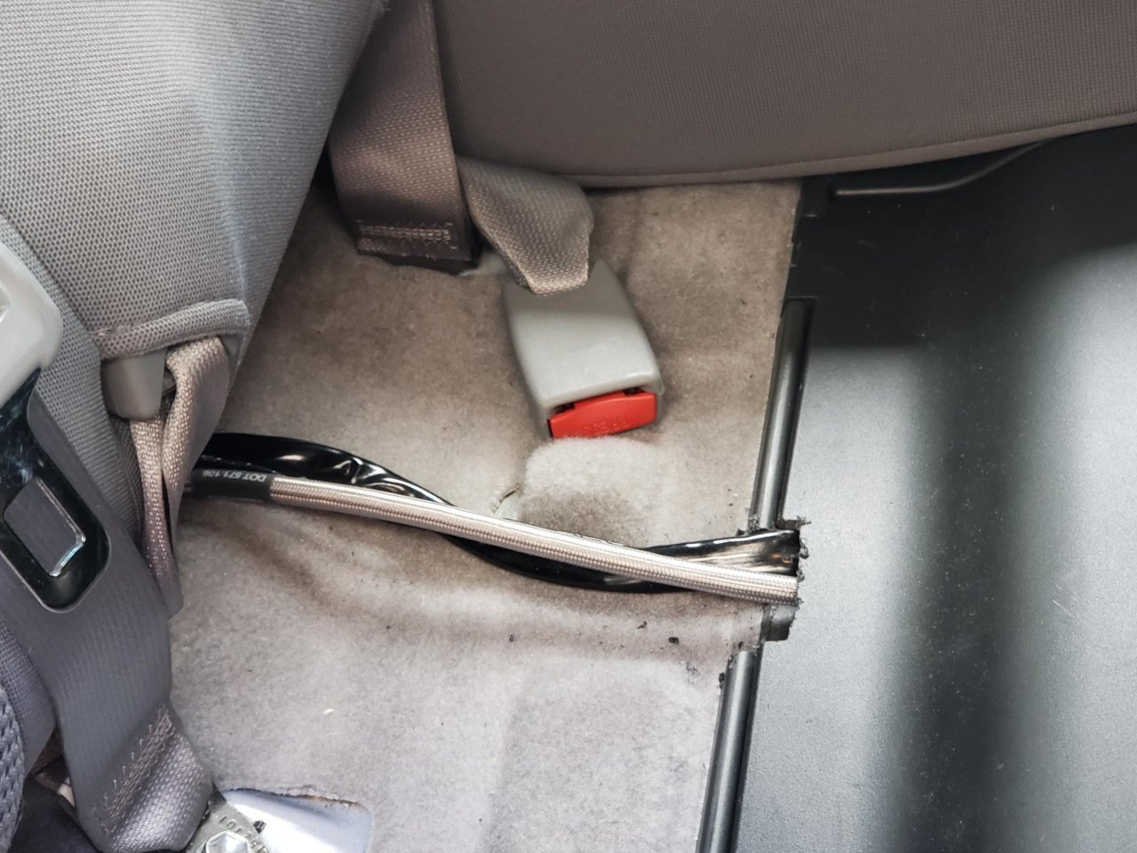

    anyway at this point on my install.
    i mounted the arb twin behind the seat, fit great, ran the wires and ss hose under the rear seat to the small storage hole, stripped it and mounted the manifold. then used ss bulkhead fittings to route the lines out of the cab and under the truck next to the frame rail.
    still not complete, at my age it takes me some time lol.
    do not judge my rear speaker, that is 100% temporary,,,one thing at a time.
