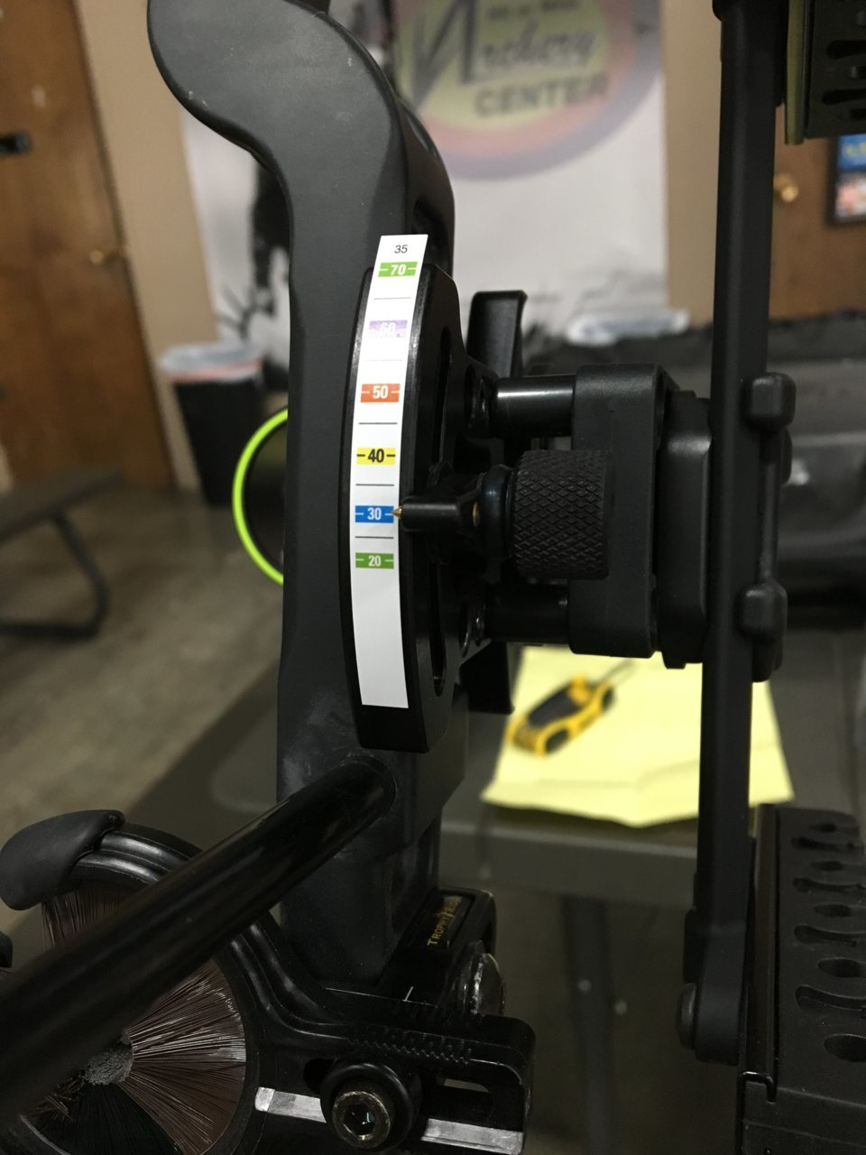

    Well finally think Im back to normal on my bow, I got the right tape and sighted in. I just need to practice more, Sept is right around the corner! Im Shooting out to 60yds, I dont know if I'd take a shot that far out or not, I guess it depends on how clear the shot looks.

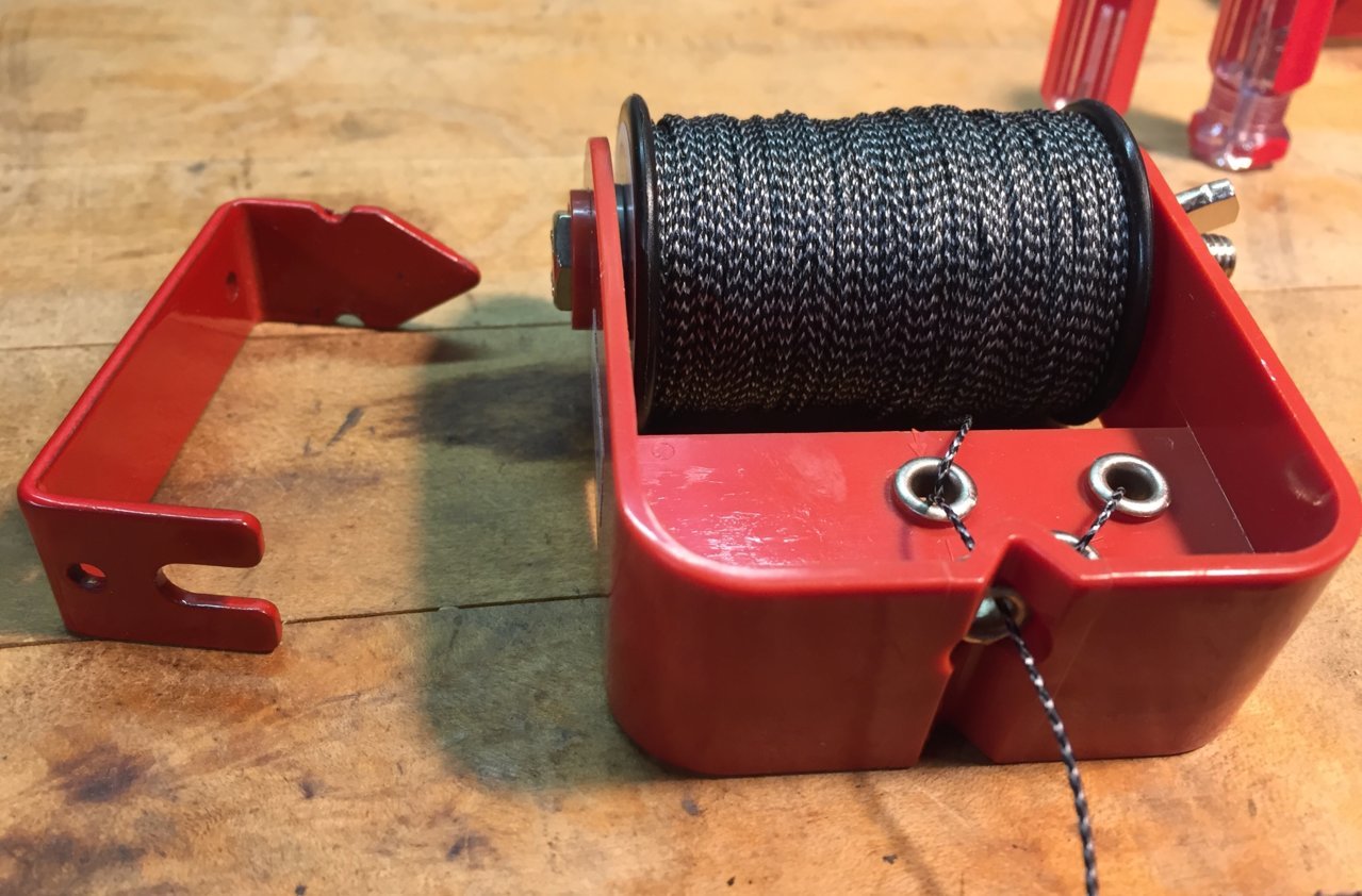

    The press is definitely a needed item when learning to do your own bows which is a great advantage over having someone else constantly do it. I will say,
    most peeps that I’m aware of don’t need a bow press in order to put in/adjust or serve in.
    This is the key tool you would use for the Peepsight. The little red tool on the left with the arrow at one end is what you used to separate your strings to put a peep him.

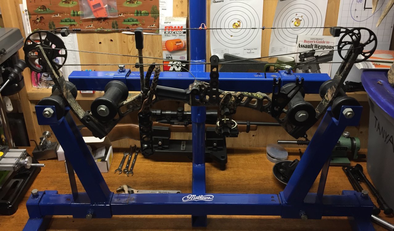

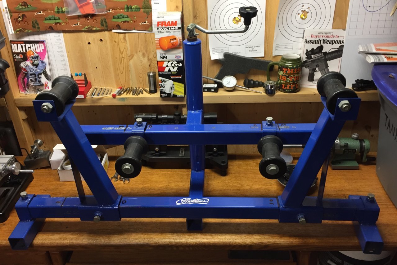

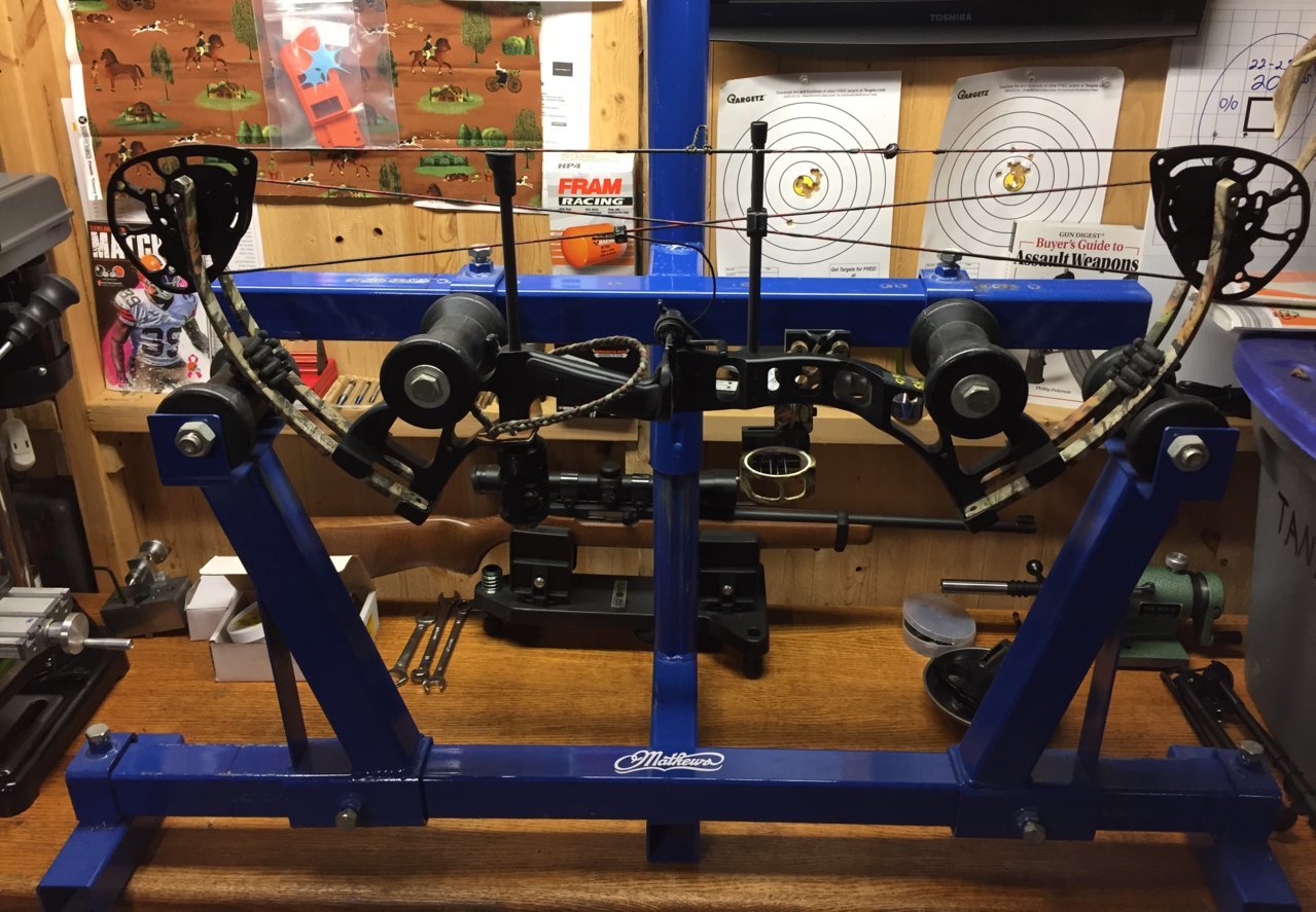

    This is “big blue” This is the press I currently own . As you can see from the pictures how swept back of a design you can actually get in these styles of presses. The 1st is a Darnton 700 and the 2nd is a Matthews switchback, but the switchback I believe is the last Matthews bow that you can fit in this style of press. When they went to the Z bow, that’s when the new style press came on. That’s why my friend sold me “big blue” for only $300.
    ( The bows are just set in there for the photo)

    The important thing to remember is it doesn’t have to be super complicated and expensive. The concept is basic, squeeze the bow to relax the string. But of course a well-built bow press is an advantage. IMO. Having rollers on the pressing portion of the press is definitely wanted to keep from damaging your limbs.
