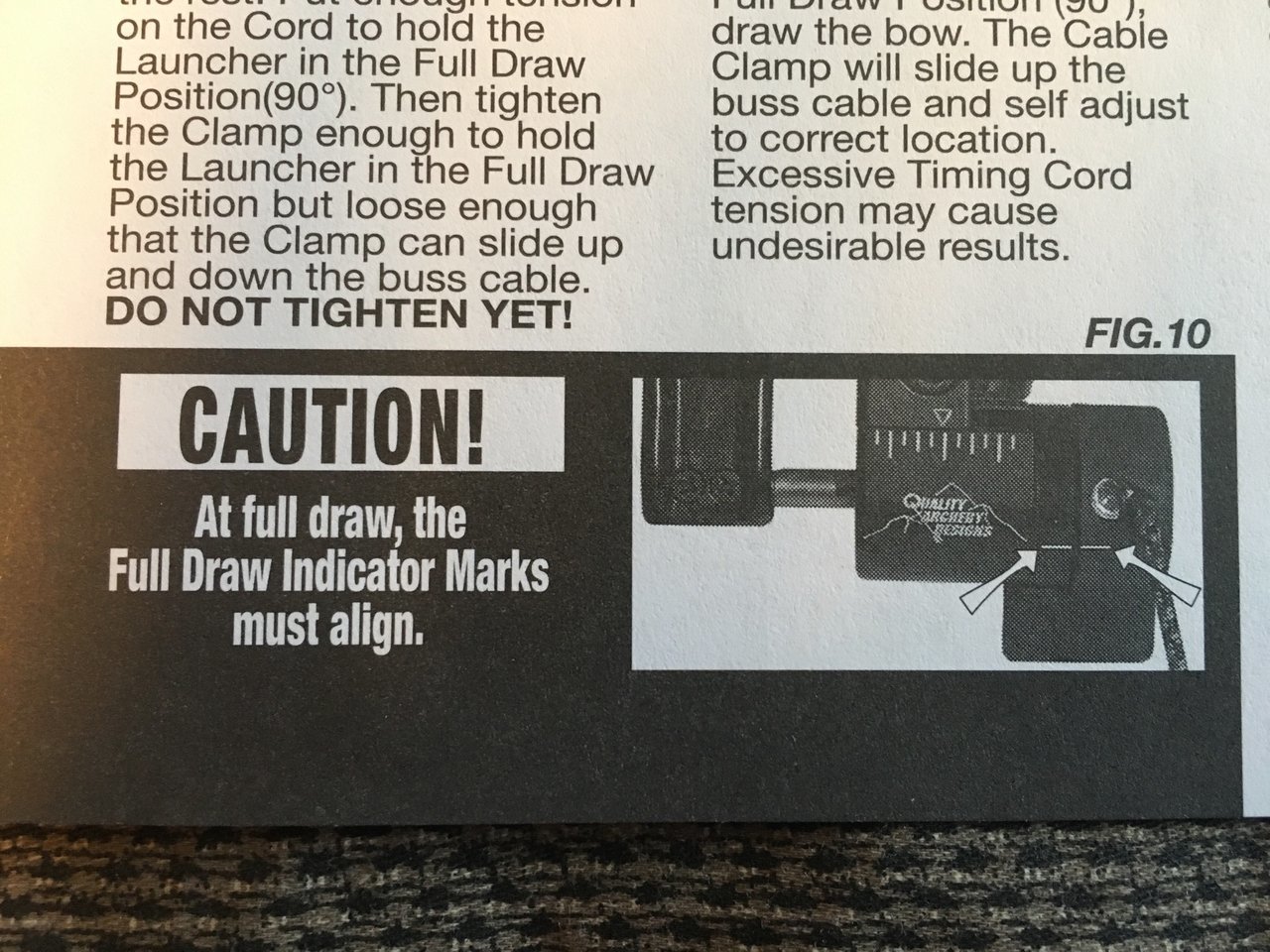

    Does anyone here use a QAD drop away rest? I got one about a month ago and since then my bows accuracy has Shit the bed. No matter what I do the arrows are eating through the felt in the valley of the rest, which makes the arrows come off at all different angles. So my questions are: has anyone else had this issue and resolved it? Since it is a drop away rest the arrow/fletching should never contact it once fired right? What could cause this?

    I have a picture of mine in my photo album.I did have it put on by the tech at the archery shop when I got the bow so I’m no expert on the subject but it sounds like it would have to be the timing cord that goes to the string (cable)..51DD8F3F-35D0-43B2-808B-95451A02F887.jpg

    I have several QAD’s, as it is the only rest i use and I shoot out to 70 yards . I have not had that issue. I would check to make sure you’re lead fletching is pointing straight out at 9 o’clock (3 o’clock if you’re left-handed, i’m left-handed) and check the timing and your pull cord.
    Also check to see if your catch bar, if you use one is not tilted too far forward or too low

    2 Questions for you, is it burning the felt off of both sides of the V or just one?
    And
    Are you sure you’re not hitting the bottom of the site box? This is a very common issue that people miss, and then miss diagnosed flight problems not realizing they have their site box to low

    It’s hitting exactly where the arrow rests when at full draw and peeling the felt forwar. I’m also getting color transfer from the vanes on the plastic part of the rest below the valley. Almost like the arrow is dropping with the rest. I can literally watch the arrows beer and wobble in flight. Definitely not hitting the sight box

    First check the timing. If it's not the timing then your nock height is off. (To low)
    You need to put your bow in a draw board, draw it back, check the timing on the QAD. If the timing marks line up, then stick an arrow level on the arrow while the bow is still at full draw. You should be level at full draw or even better nock high a little bit.

    I would definitely check the timing line like he showed in the picture obove

    If you don’t have access to all that fancy equipment he mentioned above just use a buddy, Pull back to full draw and have that person look at that line to see if it’s lining up.
    And yes I’m assuming all of your other alignments have already been addressed like he mentioned above.

    this as well. Should be level at least to where the drop away rest mounts at full draw.

    I had that issue, but didn't have the tools to fix it. I took it to the LBS my nock height was low and the timing was off. I never had a problem after it was adjusted
