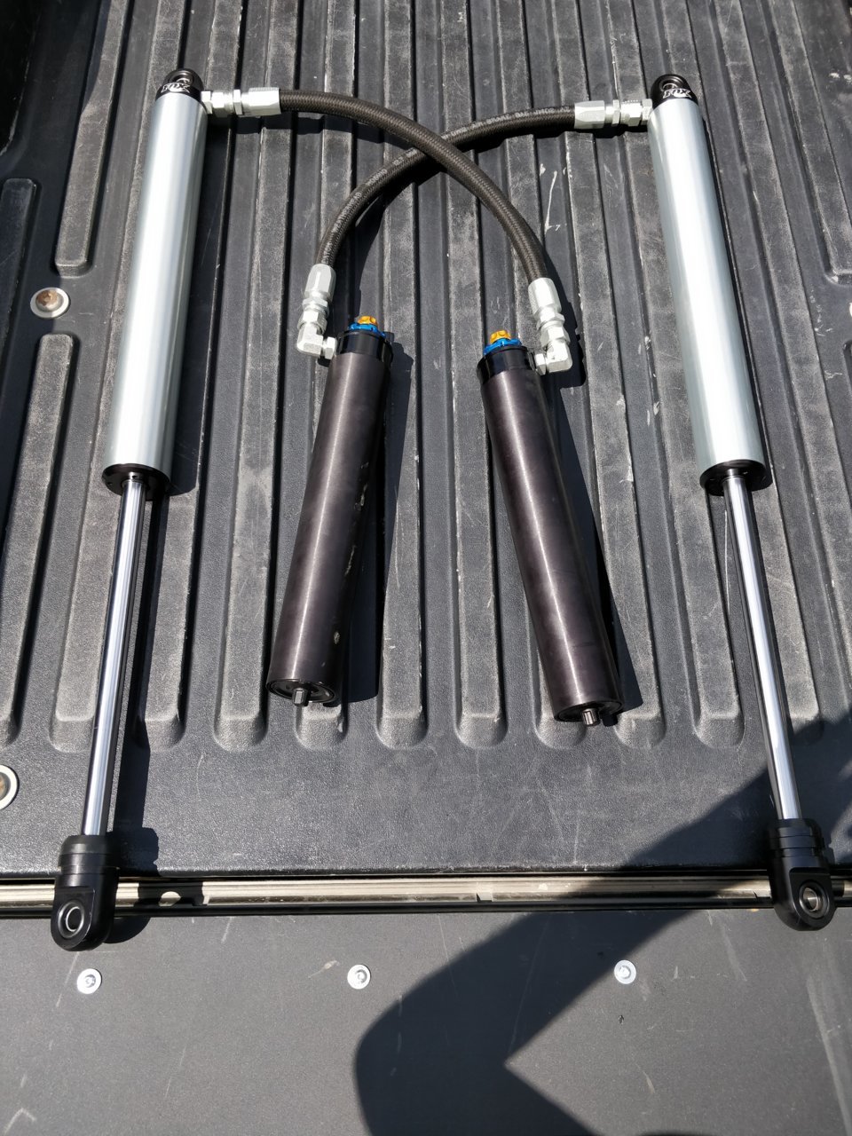

    You would bend the frame before you'd ever put enough force to need 3.0s. The below shocks are what I'm about to stuff in, Fox 2.5" x 14" and they are massive, significantly bigger than the King 2" x 12" I have on my other truck.
    I normally go out with about 700 lbs in the back and the Kings never got so hot I couldn't keep my hand on them even after 50+ mph down desert trails. 3.0s would be like driving a dump truck, you would need some serious valve work to get them to ride well.
