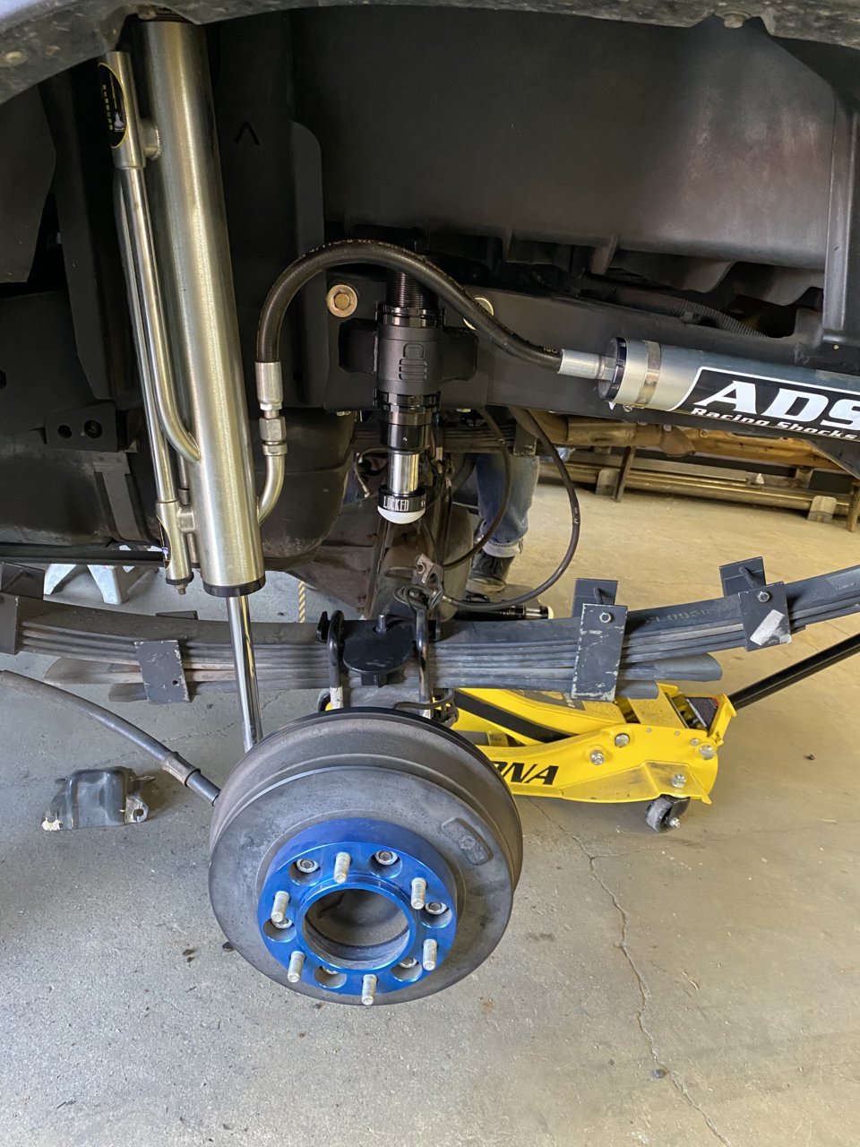

    Alright peeps, I’m about to order some rear 2.5x14’s from ADS...
    Anything special I need to request? @Supra4x4 i think you’re the only other ADS guy here...
    I know I need welded rod ends, to help shorten things up a tad. I’m going to add compression adjusters as well, and have them valve to my trucks rear axle weight.
    I’m not sure if they can add an IBP but if so, I’ll check to see how much more that will cost. I’m not going to bother with triple bypasses, it’s mainly a street truck and the type of wheeling I do doesn’t warrant them.
    should I request a specific RR hose length?

    The golden recipe would be:
    2.5x14" Short Body (Custom order only, I asked them on instagram and they said they would make it.)
    Welded Lower Rod End
    Remote Reservoir (specify Archive towers so that they know how to orientate the fittings.)
    As far as hose length goes, you'll have to burn in some mounts for the reservoirs so as long as the hose is long enough to make a 90 degree turn around whatever bump stop solution you have you're good. I used camburg dual clamp mounts: https://camburg.com/shop/fabrication/camburg-universal-4130-mounts/
    The rest is up to you as far as the comp adjusters and valving.

    So regarding limit strap length, I measured on my truck, with 12" extended on the shock, it looks like an 18" strap bolt to bolt would be about right. This is with the axle limit tabs pointing off back side of axle, almost touching the hard brake lines, maybe about 30° up from horizontal.
    Right now, I recommend anyone with the limit tabs to see how they fit on the axle, and measure for your setup. Read quoted post for more info

    ~16" hose length should be good, which is Fox standard length for smoothy. King has a 14" I believe and it can be too short

    There we go lol. I had no idea what the hose length should be. With my bypasses I have a 90 degree fitting pointing upward for the remote reservoir and the hose just makes a turn around the airbumps. I think the smooth body shocks have the fitting at the top.

    It’s less necessary on the smooth body shock, since with a bypass you have to be mindful of where ride height is for tube positioning. But personally, I would still order it. For reference my bypasses are full body 14” and as you can see they stick down a good distance below the frame. The main benefit for you ordering the welded rod end will be ground clearance, as it will allow you to angle the axle tab higher. If I was to do it over again, I would have ordered a short body 14 if I had known it existed. Disregard the shitty Dakar springs, those are gone now.
