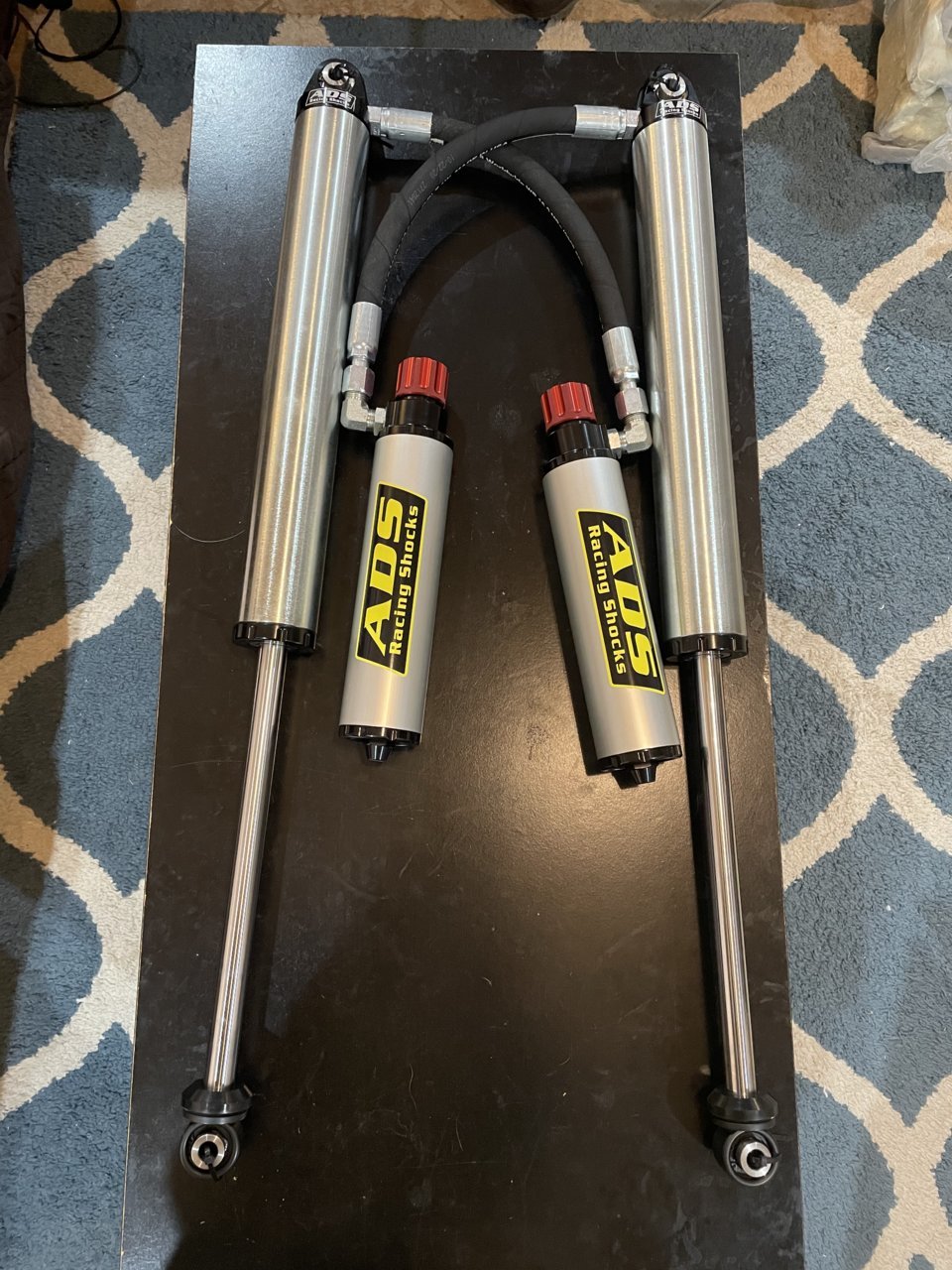

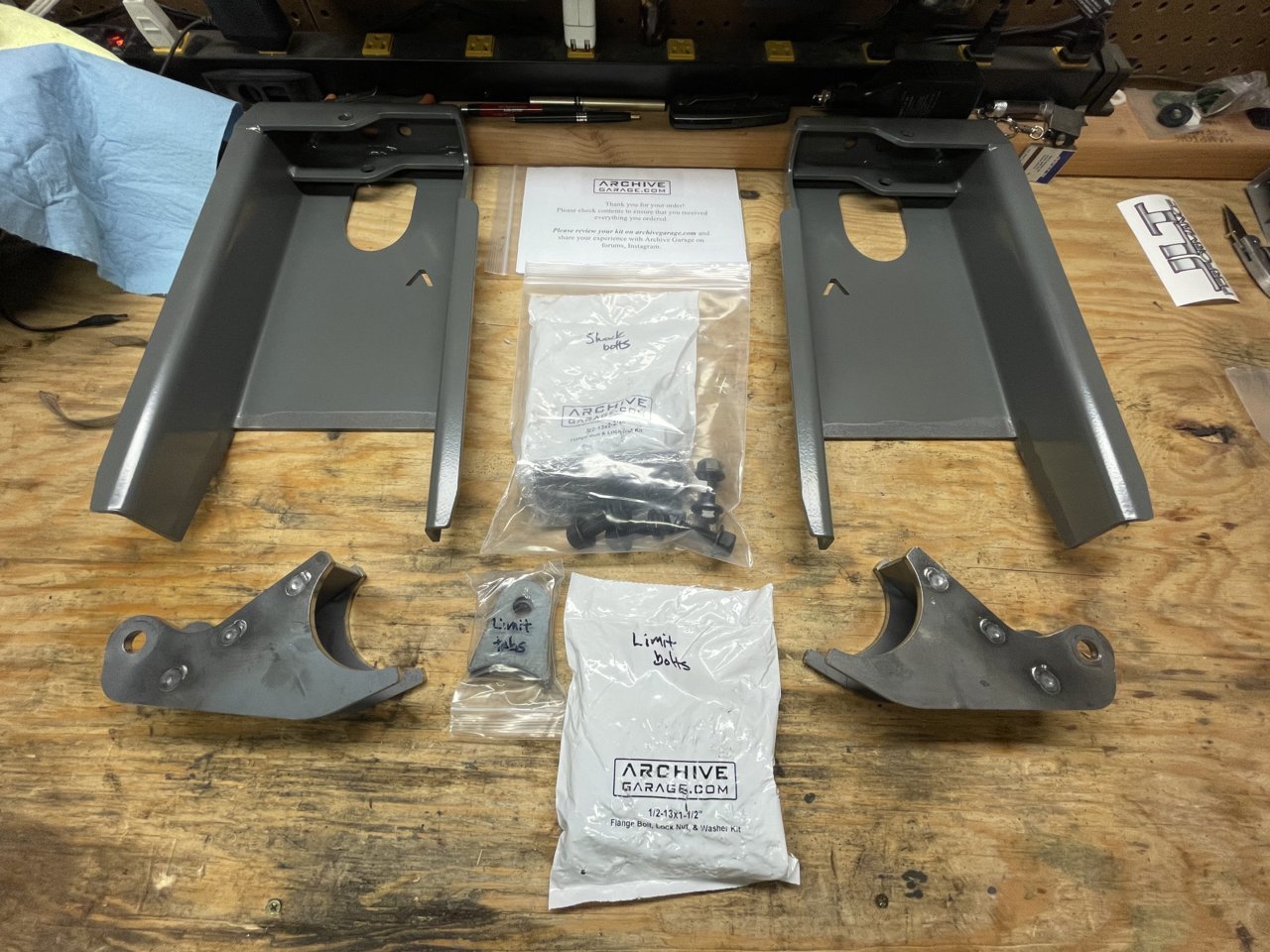

    Parts starting to roll in. I don’t think I’ve ever had truck parts that were packaged so well.

    #697

    Just got my set yesterday
