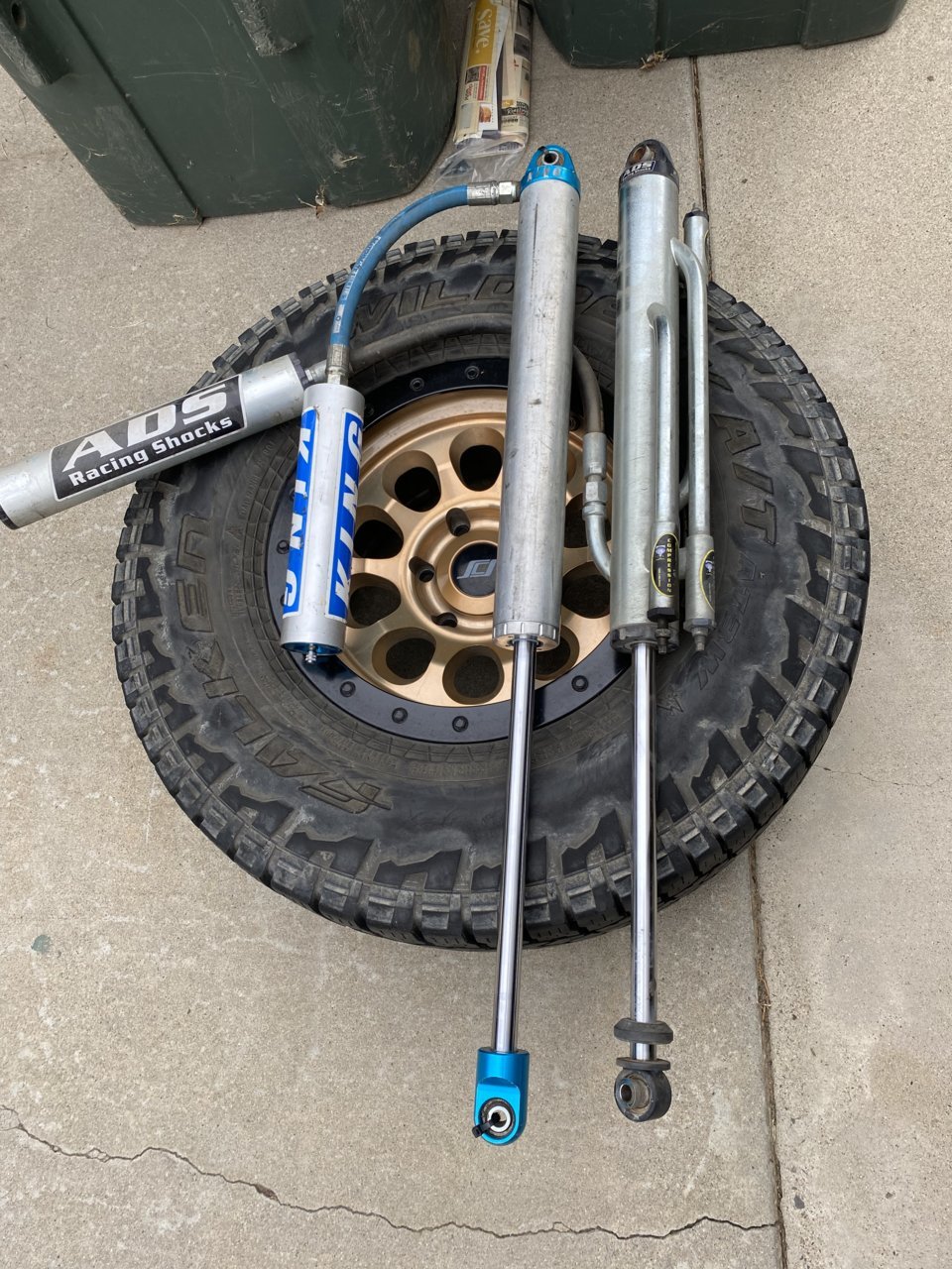

  17. Oct 16, 2021 at 5:55 PM
    #817
    ovrlndkull
    ovrlndkull STUKASFK - HC4LIFE
    Jan 7, 2017
    #206806
    37,791
    Skip
    Burlington, NC
    2005 DCLB Silver
    63s, XD Machete, Beat not Babied
    I don't want to ask what someone's short one measures :anonymous:
    Dayman Karate[QUOTED] likes this.
  18. Oct 16, 2021 at 5:59 PM
    #818
    Dayman Karate
    Dayman Karate Fighter of the night man, champion of the sun
    Dec 18, 2017
    #238838
    4,379
    Clay
    Central Alabama
    Mostly reg ass vehicles for once
    https://www.tacomaworld.com/threads/daymans-karate-class-but-you-wont-learn-nothin-4-link-lt-and-previous-iterations.755134/
    Haha y’all whip out your rods and shafts. Let’s get some pics and measurements! :rofl:
  19. Oct 16, 2021 at 7:17 PM
    #819
    Supra4x4
    Supra4x4 IG: hash_brown55
    May 8, 2015
    #154861
    3,238
    Andrew
    SoCal
    MGM 2011 DCLB 4X4 Long Travel'd
    Whole lotta stuff
    Yep, I was talking ground clearance off the axle housing.
    Here’s a picture showing the difference between a 2” standard rod end from King and a 1” welded rod end from ADS. Same 14” stroke and body length.
