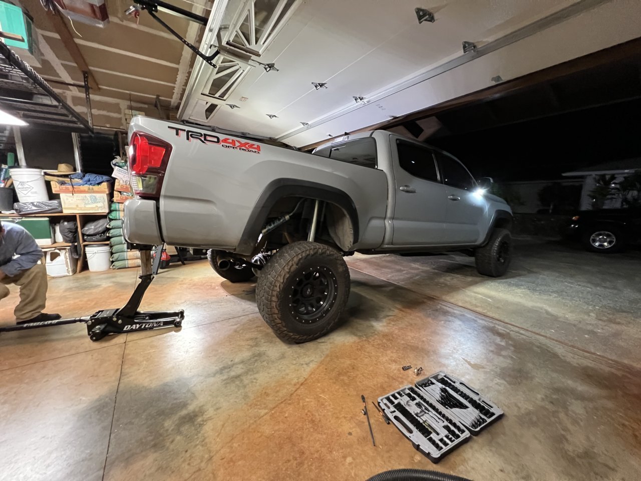

  12. Dec 11, 2022 at 1:39 AM
    #992
    trail.taco
    trail.taco Well-Known Member
    Jul 28, 2022
    #402379
    144
    2019 Tacoma Trd Offroad
    Beadlocks, 35s, Mid Travel
    Got my shock relocation done today. I was very impressed with the quality and fitment of all the archive garage mounts.6533491B-CB51-48BB-9E01-84BCF9BBDF48.jpgD293C096-2BF2-4395-8D9F-702F5AFE20B8.jpg
  13. Dec 11, 2022 at 1:53 AM
    #993
    ARCHIVE
    ARCHIVE [OP] Well-Known Member Vendor
    Oct 29, 2015
    #168099
    2,162
    Eric
    Orchard Park, NY (Buffalo)
    '05 Taco, '22 Tundra, '91 Cummins
    2.5" Fox relocation * Hammer hanger * Archive MD springs
    Thank you!
