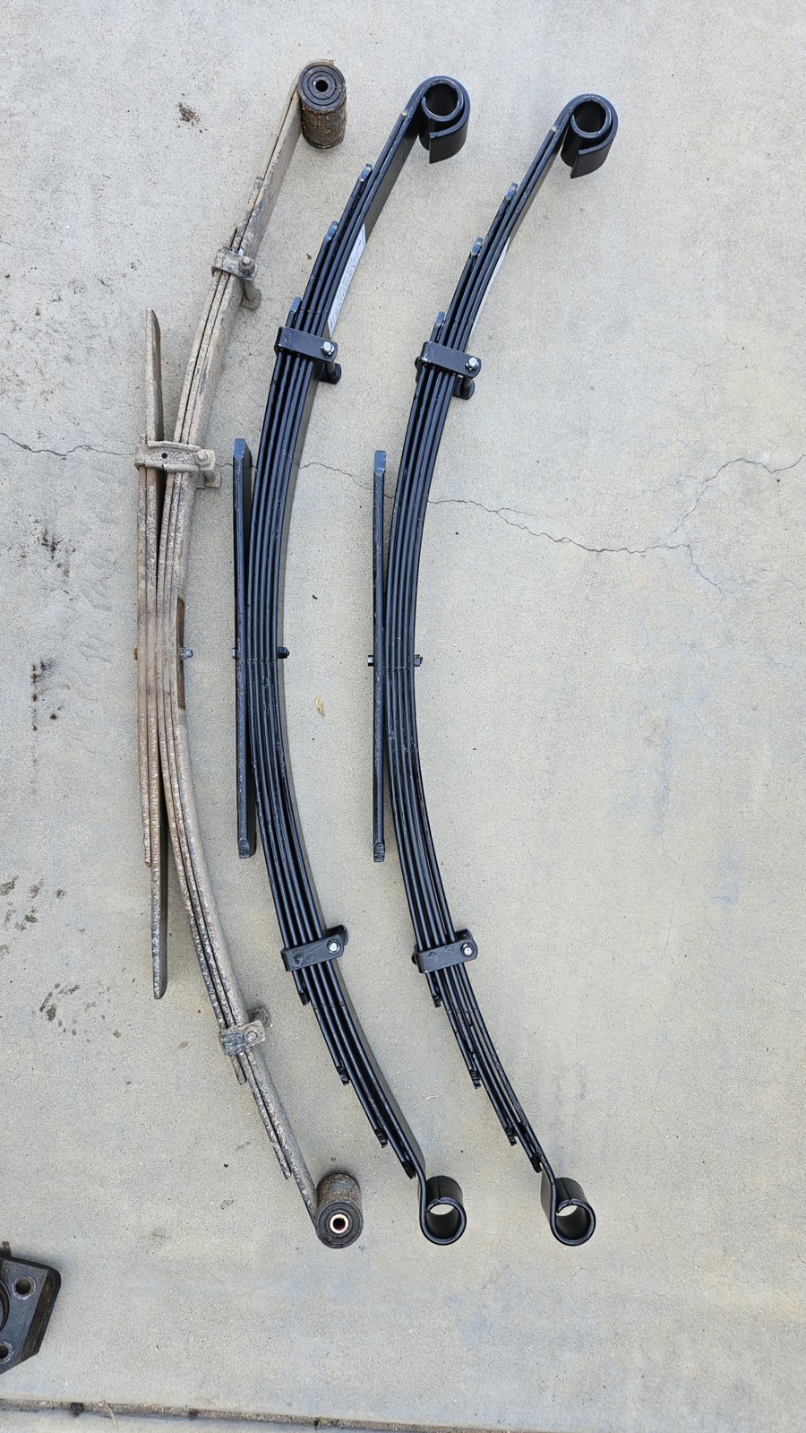

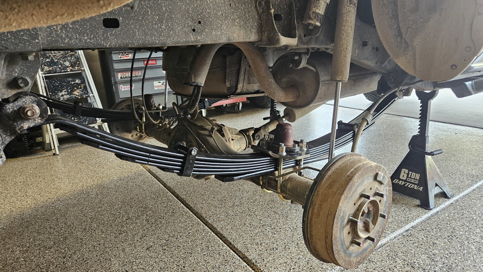

    @ARCHIVE I installed the MD leafs today. How much can I expect them to settle? Currently sitting at 26" hub to fender with an empty bed.
    Installed
    Guess I'll have to adjust the front up some. It is currently at about 2" of lift.
    Now the whole rear is Archive. Hammer hangers with cross tube, trail series shock relocation, U-Bolt flip option 3, and now Leaf springs.

    Thanks for your support! Should come down a little 1/4"-1/2" over time. You're probably about 2.5" lift because you don't have much weight, as you say bed is empty. But it's good to have capacity for your trips when loaded.
