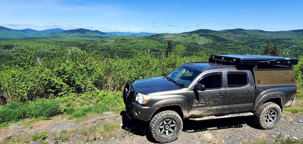

    @ARCHIVE 2010 Tacoma 4door. Currently have the OME HD pack (OME shocks as well). Super soft-too soft ride and bottoms out quickly just shy of 2 years. Have the superbumps and flip kit installed. Stock hangers.
    Tube-to-frame measurement of 10" even.
    Calculated at 562 pounds of extra bed weight when daily and 100-150 extra when camping. Minimum weight of 250-300 when in "winter mode" (up here in Maine).
    I'm interested in your HD spring pack and curious if I may retain the current ride height ( a tad higher is fine) yet gain better ride quality without the hanger kit.
    Thanks!
    PS: There's not a local scale or even close to near me..

    If the Dakar "HD" are feeling super soft, you might have more weight than you're calculating, which is very common especially with DCSB.
    I think our HDs would be good, even down at 300lbs ride should be pretty good. I was very impressed with a customer truck with HDs at about 300lbs, but it had Hammer Hangers which help ride a lot.
    HDs at 300lbs were about 3" lift (11.25"). 300lbs is significantly below HD 600-1,250 lbs intended range, but it won't be harsh.
    Remember, rear lift is how you increase bump travel

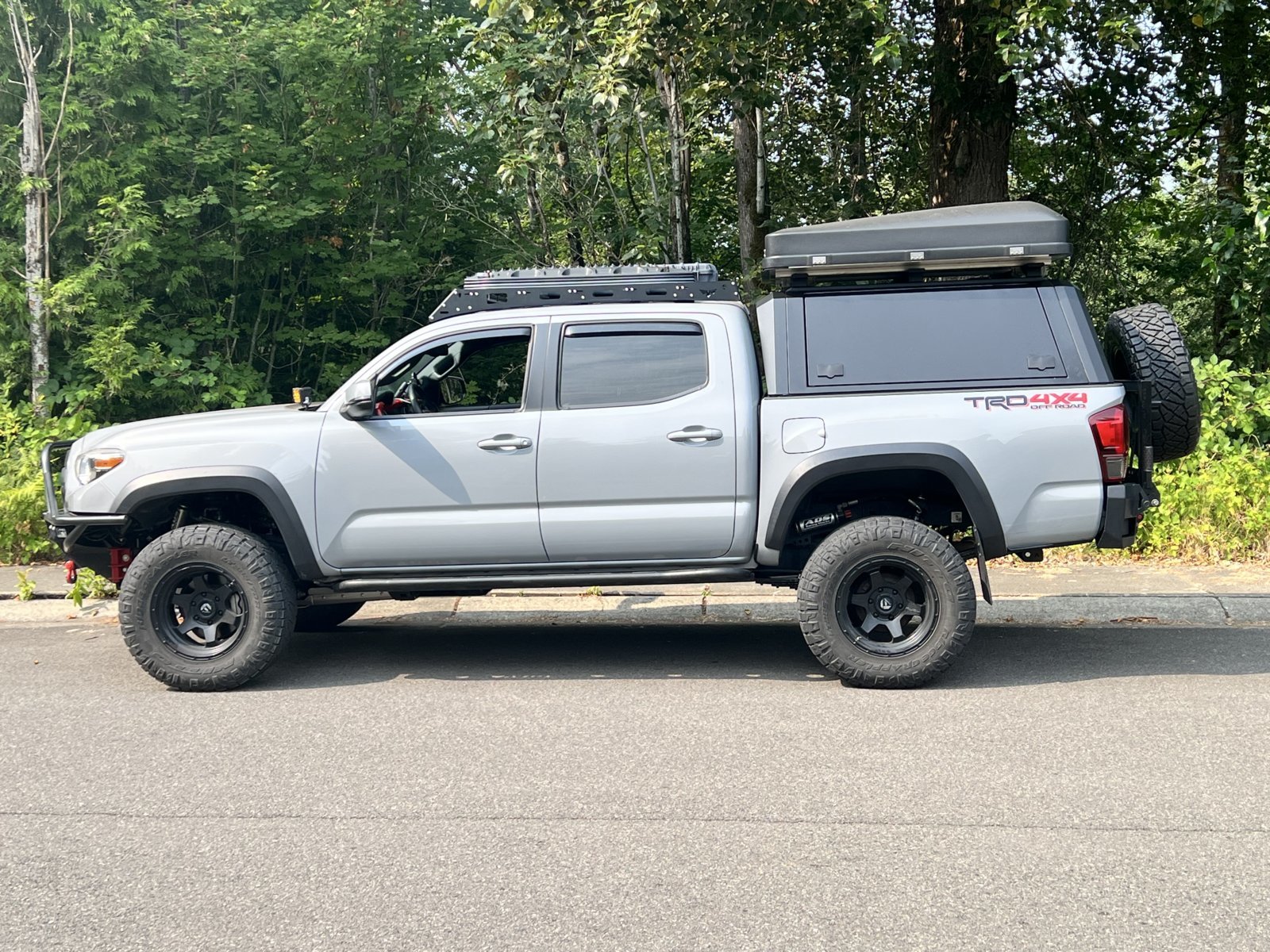

    Are their leaf packs side specific?
  12. Jul 27, 2024 at 7:43 PM
    #52
    ARCHIVE
    ARCHIVE [OP] Well-Known Member Vendor
    Oct 29, 2015
    #168099
    2,254
    Eric
    Orchard Park, NY (Buffalo)
    '05 Taco, '22 Tundra, '91 Cummins
    2.5" Fox relocation * Hammer hanger * Archive MD springs
    No

    ‘19 TRD offroad DCSB Cement
    Icon stage 1, Icon upper control arms, 17” Fuel wheels,Ridge Grapplers, TRD exhaust, leather interior.
