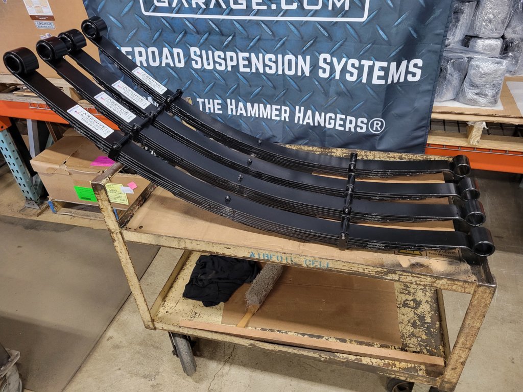

    Tacoma leaf springs in stock: MD, HD, XD and MAXD
    We also have our new LD/Prerunner springs coming in about 8 weeks!
