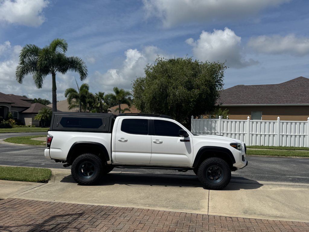

    el Gringo
    el Gringo Well-Known Member
    Nov 28, 2018
    #274086
    64
    Brian
    2018 Tacoma TRD Pro
    For reference…these are the LD springs, with Hammer Hangers…on 33s
    ARCHIVE[OP] likes this.
