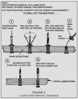

    Note, drilling down the rivet shank with a small size drill is the single most important item. If possible drill all the way thru the items, but not all the way thru the tail. This lets you remove the rivet shank by 'pulling' the material thru the stack up (with a pin punch down the middle). When trying to drive a rivet out, you are just swelling it more if you are just hammering on the top of the shank. If you drill thru the shank but not the tail, the material will shrink under axial stretch and help to come out. If you drill all the way thru, then you dont have anything to hammer on and you are stuck drilling (and elongating the hole, and risk the rivet spinning).
    Make sure you have a pin punch to match the pilot size you drilled down the shank. If the rivet spins, you are in for some pain. Hopefully someone can hold the shank with pliers.
