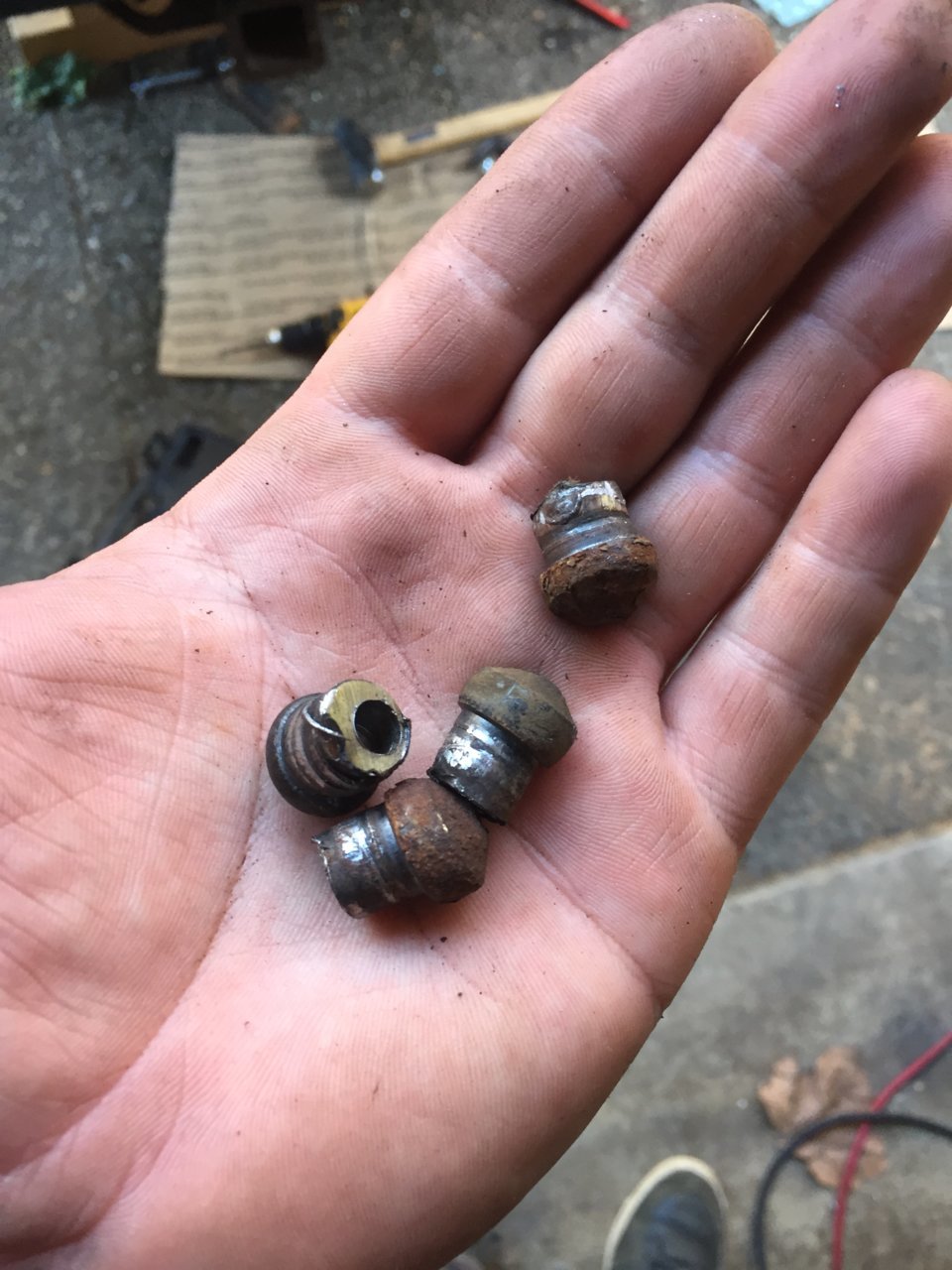

    Update: I got the driver side hanger off and frame spray painted. The rivets will be framed as trophies and hung right next to be front door so I can hiss at them every time I leave.
    I have all four rivet heads ground off on the passenger side, 3 of which have pilot holes. I can't get to the front bottom because my exhaust is in the way.
    I got a 3/8" punch and 3lb sledge at Lowes. Extremely helpful. Also a creeper, for which my back is still thanking me. I'm hoping to have the passenger hanger off and frame painted tomorrow and while it dries I'll put the driver side back together.
    Thanks to all the motivation and feedback, everybody.

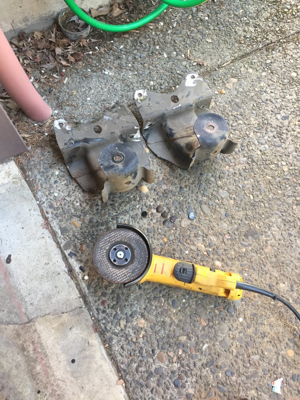

    Day 3 of The Rivet Reckoning: passenger side rivets are done, frame is painted. I made it as far as putting the hanger on the shackle before realizing I didn't have a big enough wrench to hold onto the nut while tightening so it's off to Lowes again tomorrow.
    I got the poly bushings as well thinking they'd work for stock shackles but I'm not seeing an obvious way to do a swap and the instructions are written as if you were also using Archive shackles (which I should've gotten alongside the hangers). Anyone use the bushings with the stock shackles?
