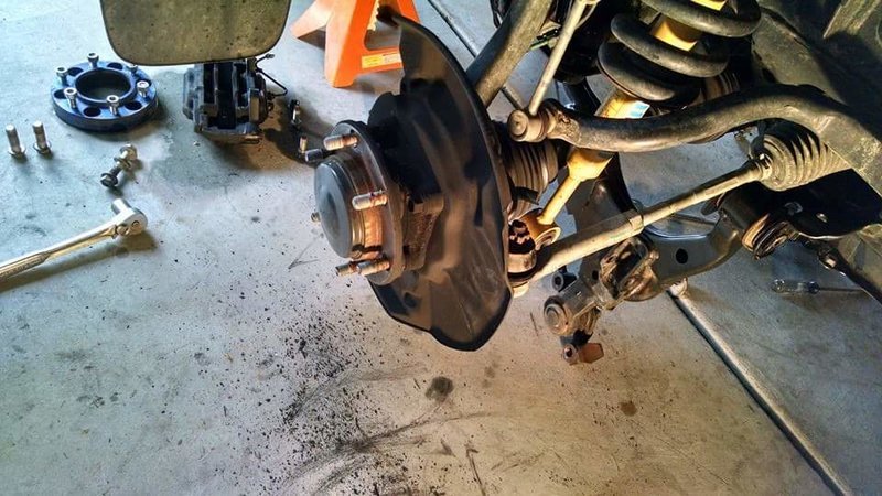

    Gladiator

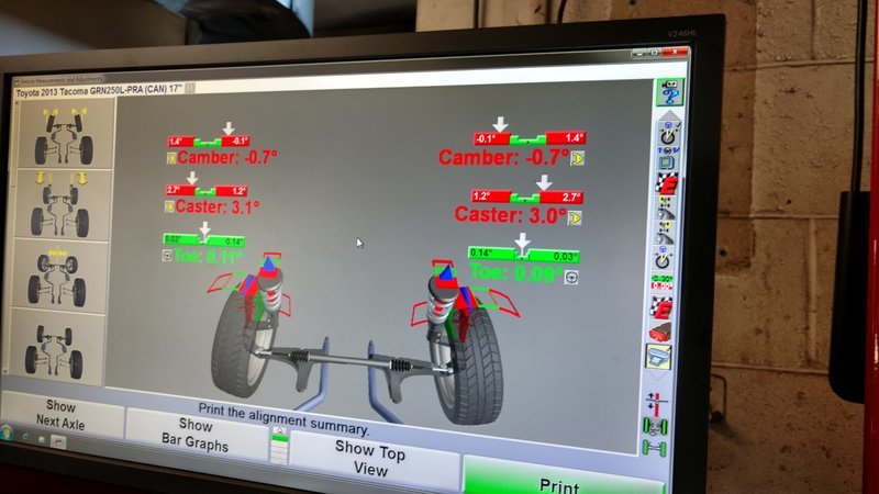

    Alignment
    Negative camber helps with grip on the corners. I'd like less Caster though.

    Gladiator
    Two months later the negative camber is a big improvement. Cornering is better, as is the tire wear pattern.

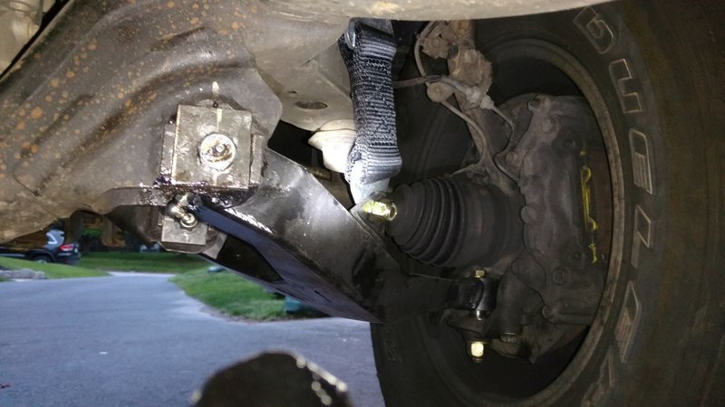

    Solid mounted LCA and limit straps.

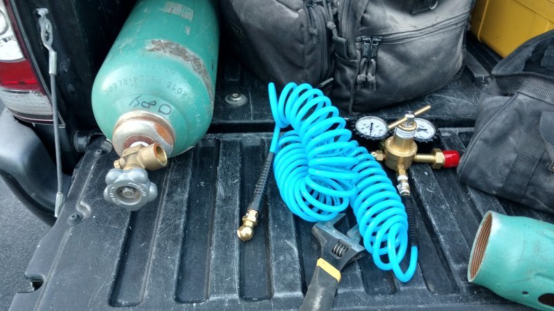

    Air On Board:
    Argon tank, regulator, and air hosewith chuck.

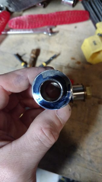

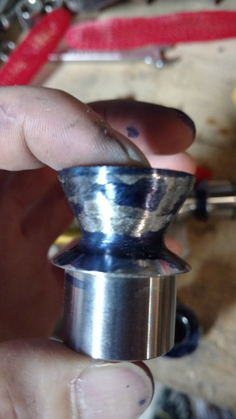

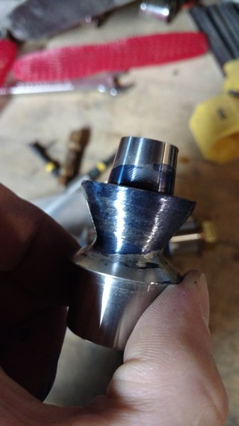

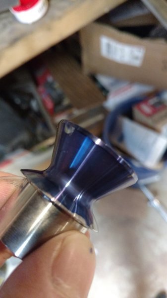

    Custom angle misalignment spacers for my UCAs. This will take off the safety margin on the DK part, and let me get more down travel, limited but straps to save the steering and CV joints.
    Marking 180 degrees:
    Dykem blue layout fluid, and a square to ma4k off one half of the part.
    Ground down by hand, keeping a smooth radius. Then using dykem to confirm both parts have the same angle and a smooth surface.
    The final product.
    The cut side will be on the down travel side, the original OD on the up travel side.
    Overall I removed .05" of material.

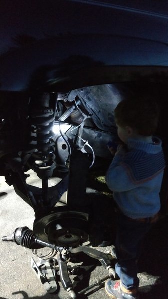

    Big thanks to Finch @fatfurious2, and some one else who happened to wander by for helping me install @Mobtown Offroad skids in the dark at the RC takeover last weekend.

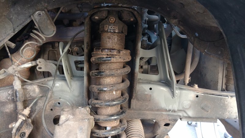

    Recent updates:
    1) added the modified misalignment spacers and got a bit over an inch of travel back, with limit straps to protect the CVs.
    2) installed gusseted spindles, new hubs, CV boots, and carrier bearing bushing mod from ECGS. All are wins, would recommend.
    3) the damned front end clunk is still there, perhaps the radiator support bushing, perhaps something else moving.
    4) repainted everything under the front and the sliders.
    5) Dakar squeak is back, time for more spray lube.

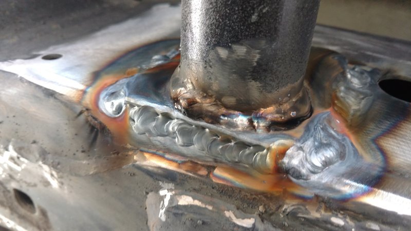

    One side in peices for the night
    One side done .
    Nimble9 and ChadsPride like this.

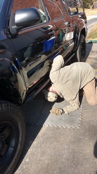

    Weekend recap:
    -Sliders and antenna mount welded on for @Finch1018
    - @Dirt King Fab double shear UCA gussets added FTW
    -drivers side outer CV rebooted, it had a very small tear.
    -LCAs greased to make clicking/banging stop
    -Uniball on the passengers slide lower has lost its PFTE insert, and makes a horrible noise. Don't use break cleaner on uni-balls.
    - @Mobtown Offroad tailgate skin and cap installed.
    - Measurements taken for custom front bumpers.
