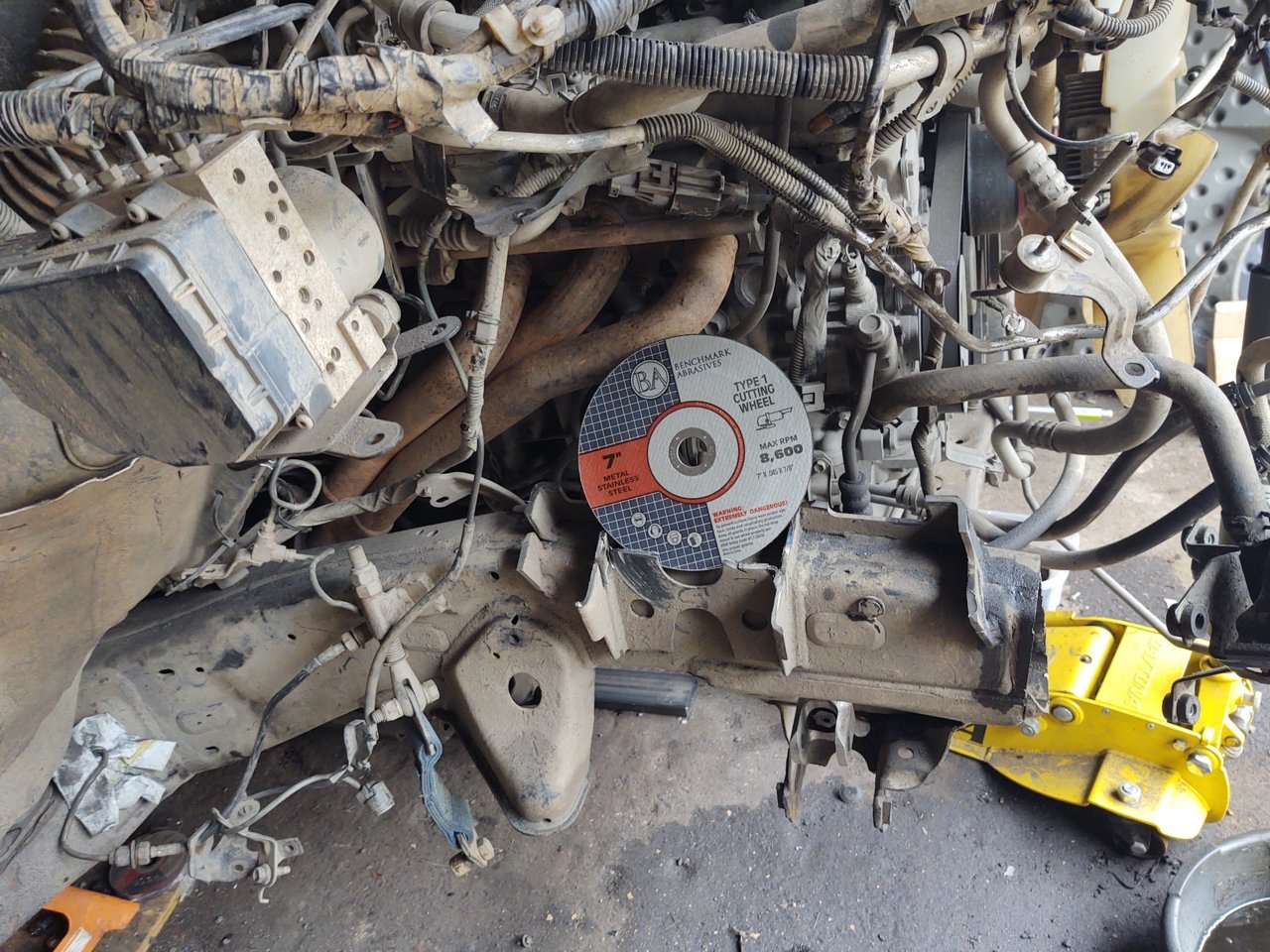

    Applied more cutting wheel.
    Time for long travel.
    And a cage to attach all the new parts too

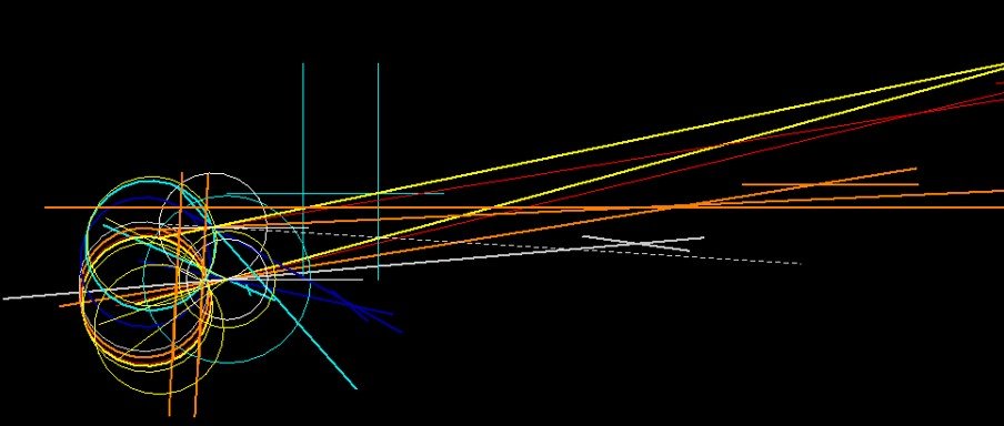

    That looks like a LT kit that should work. Now it's time to bend some metal.

    Drop bracket lift and booger welds
    All I see is someones terrible MS Paint drawing.

    Gladiator
    Hey, I've got literally hours of experience using Microstation for this design.
    The only point of that drawing is to capture the OEM suspension Instant Center and then make sure the new layout will be similar. I don't need to build (another) death wobble.

    I got it set up and started work on this project, had a buddy who's a PE show me a few things for drawing and the user interface.
    All that model is really showing is the instant centers, based on OEM and proposed new geometry. Makes it very easy to play with spindle height, UCA length and UCA mounting location.
