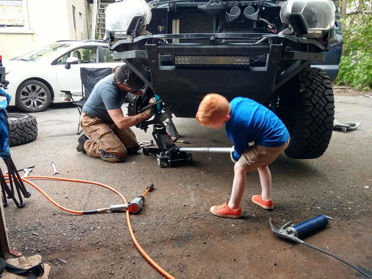

    Huge thank you to @redmann for completing my battery relocate to the cab, and the second battery installed. Supper clean looking, and now I can get my lights and other aux electric back.
    Also my ARB installed (but not fully wired) and replaced LCA uniballs today. I had to trim the lower misalignment space for the steering stop to make them fit properly.

    Ragnar helping put the LCA back in. It's amazing how much better everyrheve feels with tight uniballs and missalignment spacers.

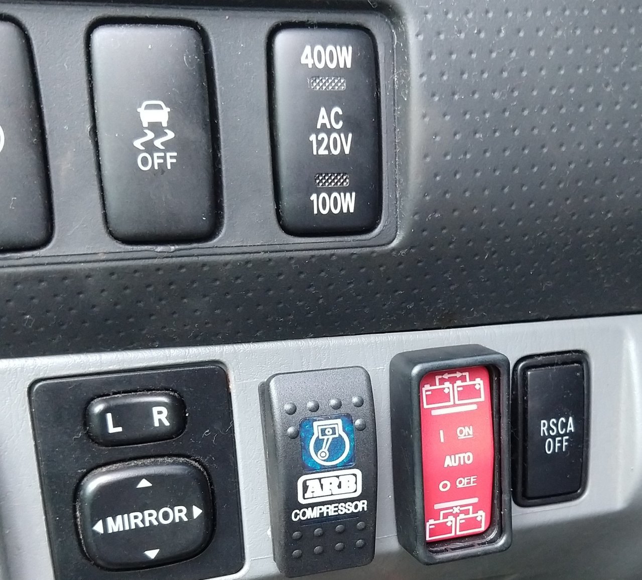

    Just a couple more connections and it all should work.

    Dual battery switch works, that relay makes a hell of a noise when it switches.

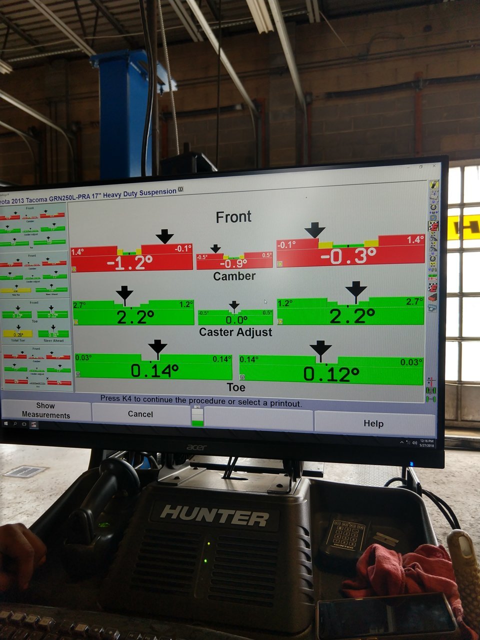

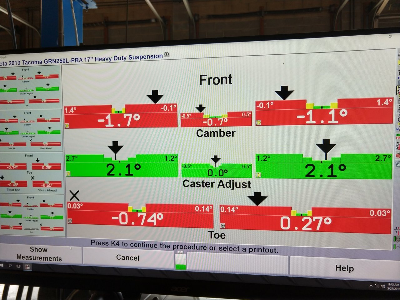

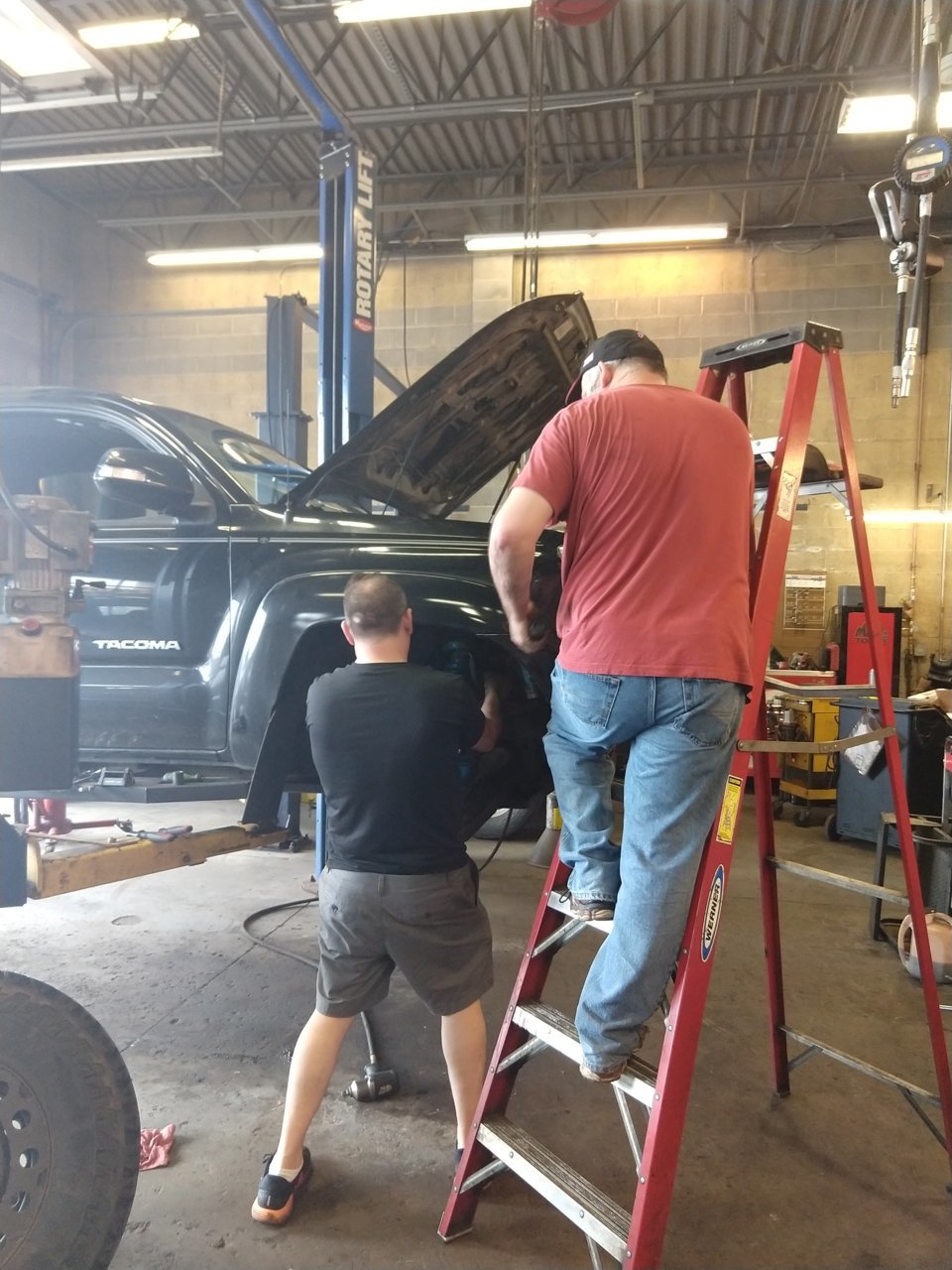

    Alignment adjusted thanks to @Braves95 and his secret shop. It was a huge job, with the hiemed upper control arms, but we got it dialed in better, and more importantly I know what the adjustment per turn is.
    Before
    After
    @Braves95 and secret mechanic at work
