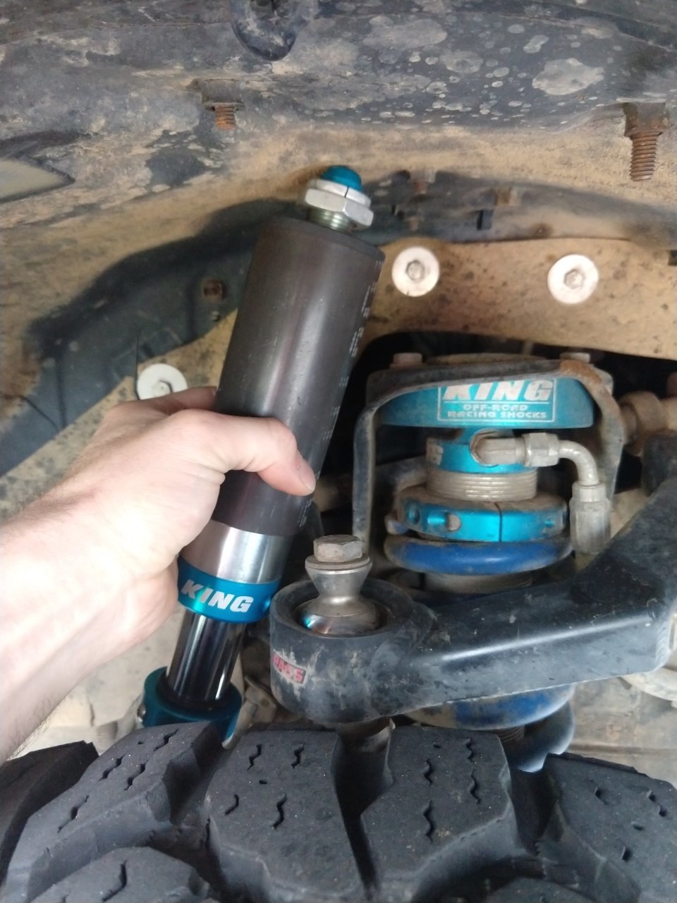

    What sort of rear leaf set up you rolling with? Interesting as I wouldn't think it would be needed for the rear, but I havnt seen yours cycled either.

    Gladiator
    I've got a Panda Special HD pack from @Blackout14
    ItsI right on the edge of needing a strap, but it's cheap insurance

    TC 3.5 LT, RCV axles, Demello sliders, BD light bar/fogs, LP6, DMZ rear, SOS skids, custom bumper, King 16" triples, Locked-on hydro rear bumps...
    Interesting...what sort of travel are you pulling with that? Kind of scary that your shocks are right at the edge of being maxed out...I assume the shock length was spec'd for that right?

    7,662
    Gladiator
    I've got the 12" travel kings on a BAMF relocate, and am pulling 11.75" of travel on the leaf pack. So it's bumpted and strapped to 11.5" of travel, just to have some safety margin.

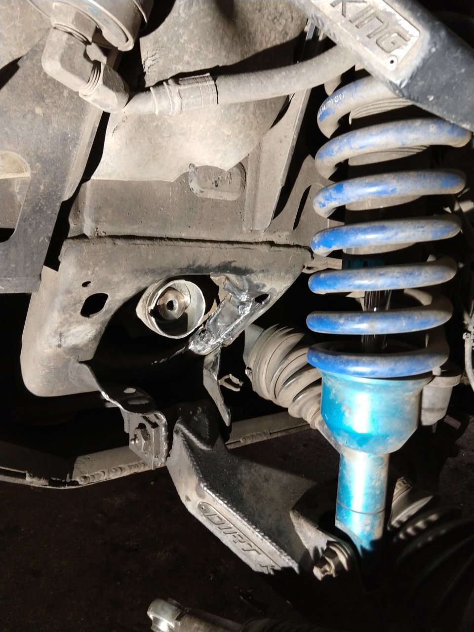

    @Tatts521 here's how I did mine.
    TC cam tab gussets, and a Moog greasable bolt. The alignment plate is 3/16ths plate.
    Blackout14 likes this.

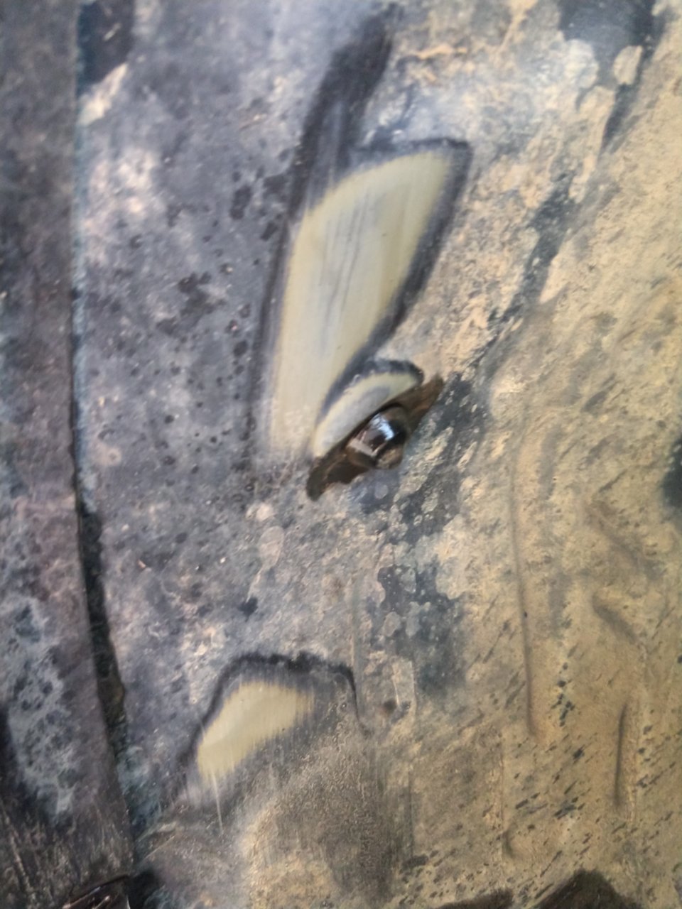

    Gladiator
    Not a big enough hole. Also, make it parallel to the piston, not perpendicular to the frame.
    Almost big enough.

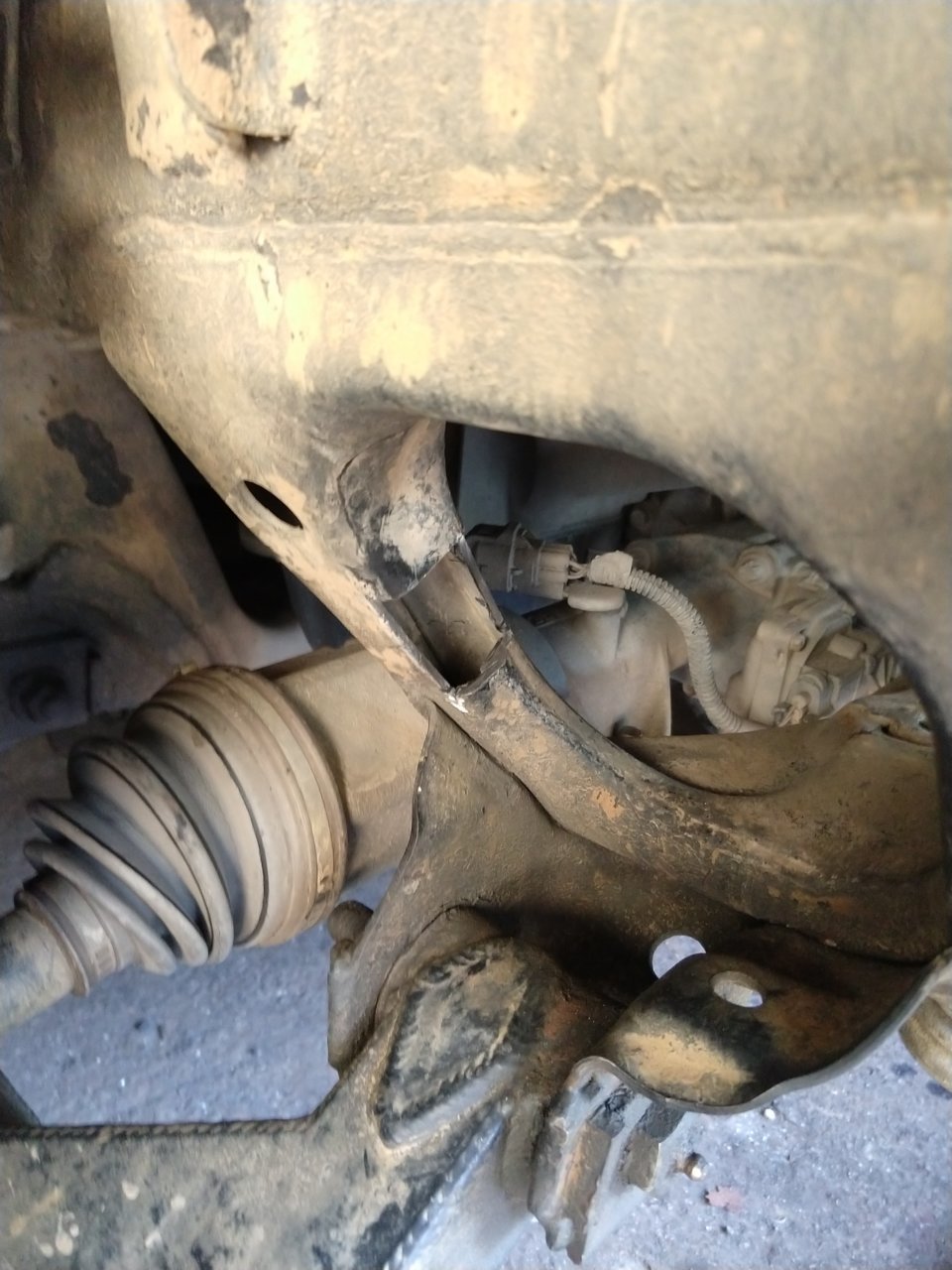

    7,662
    Gladiator
    Rack rebuilt, it was a bad seal on the driver's side of the hydraulics.
    Tested and proved that 33s will rub at full stuff. I guess it's time to start cutting.

    Gladiator
    That's going to take some serious cutting to fit.
