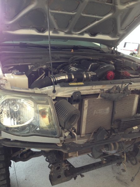

    Ha that is a pretty sick set up. I would have to cut out some wonky thing for mine, but I'm sure it can be done. Maybe I can convince @snowsk8air2 to jump in on the snorkel train?

    No snorkel for me. I want power!!! Already running the urd tcai, basically the anti-snorkel.

    That's not an option for me. The motor doesn't need a drinking straw :)

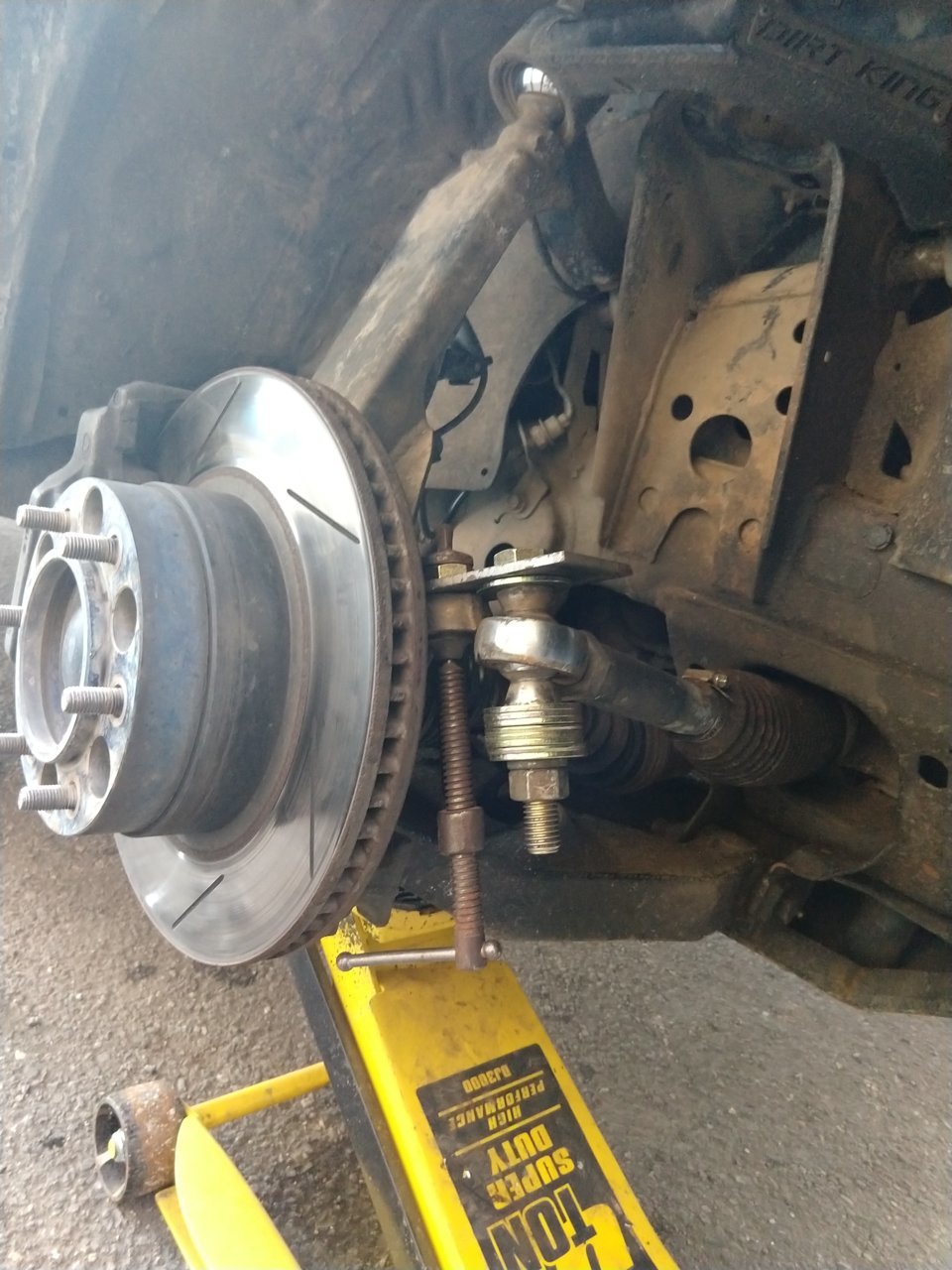

    Bump steer
    https://youtu.be/sJvw_g-usGs
    This is what happens when the alignment of the steering link pivots and axle pivots are not aligned correctly. In this case because using a setup designed for a +3 long travel kit and cut down for stock width.
    The solution is to move the outer pivot up. The giant stack of washers is there because the bolt is too long, the real magic is in the plate on the top, which moves the pivot forward and up to make the geometry work.
    Next step is to weld it on and make it double shear.

    Snorkel with glass and supercharger here. I used 3.5" for the main section, to 4" into the CAI box and haven't noticed any power loss.

    Very nice, 4" pipe should be plenty. That's a nice solution, I'm going to save that spot for an exo-cage.
