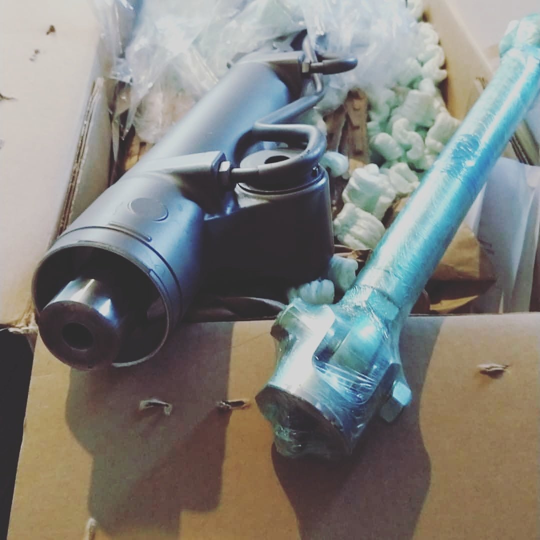

  14. Feb 22, 2019 at 6:24 AM
    #514
    Arcticelf
    Arcticelf [OP] Well-Known Member
    Jul 18, 2015
    #159735
    7,662
    Gladiator
    @WormSquirts @SGTCap
    Check out the Solo Motorsports tundra rack and heim joint steering upgrade if you want heavier duty and not long travel.
    There is a minor bump steer issue with stock geometry, but I'm working on an adapter now, and you both have the fab skills to solve that problem.
  15. Feb 22, 2019 at 8:31 PM
    #515
    WormSquirts
    WormSquirts Armageddon
    Dec 18, 2015
    #172583
    2,904
    Braeden
    BC
    Thanks! Yeah I've seen solo's before, it's just expensive... Will probably get that or the marack at some point when I step up in tire size
    Arcticelf[QUOTED][OP] likes this.
