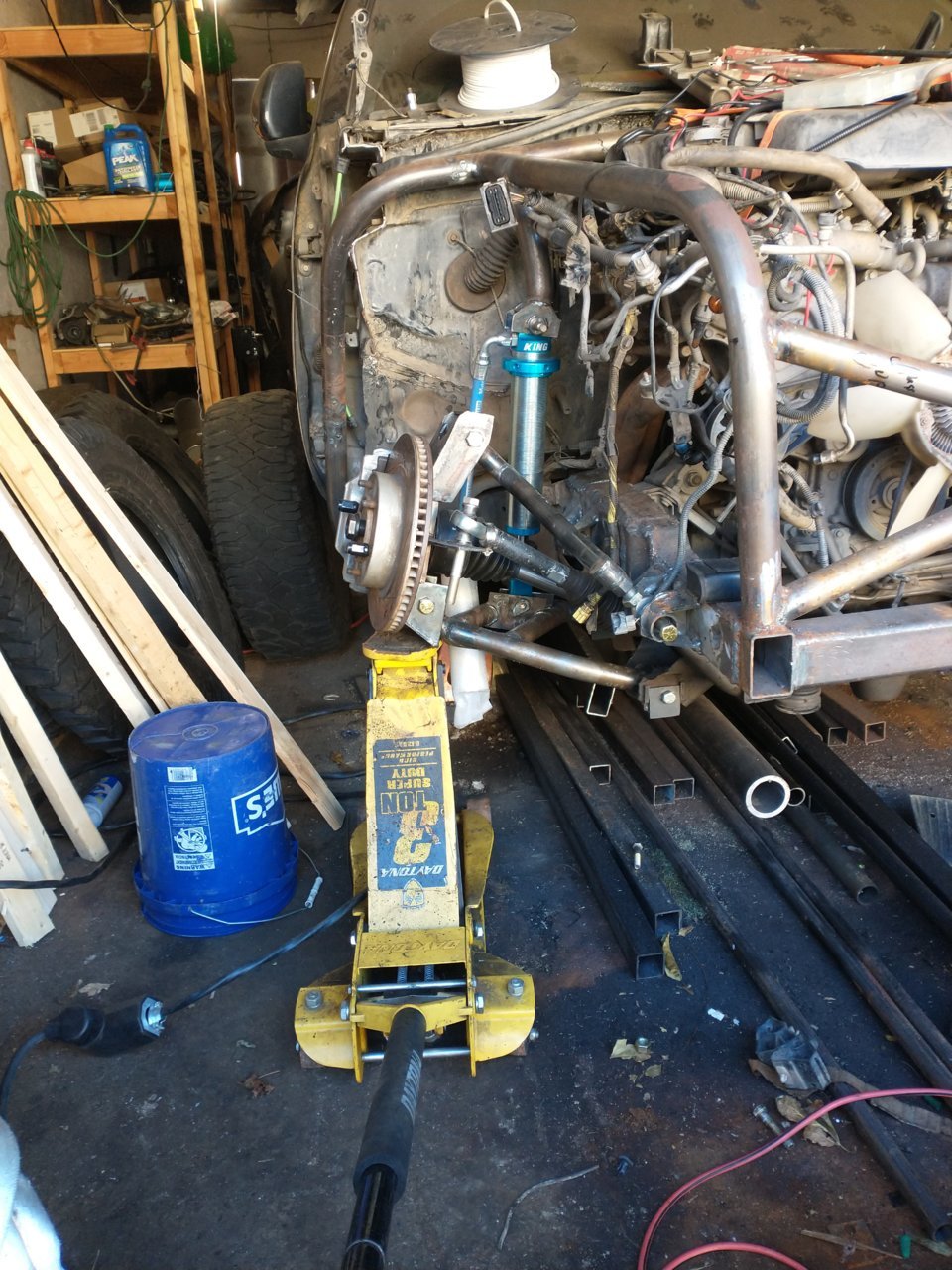

    7,662
    Gladiator

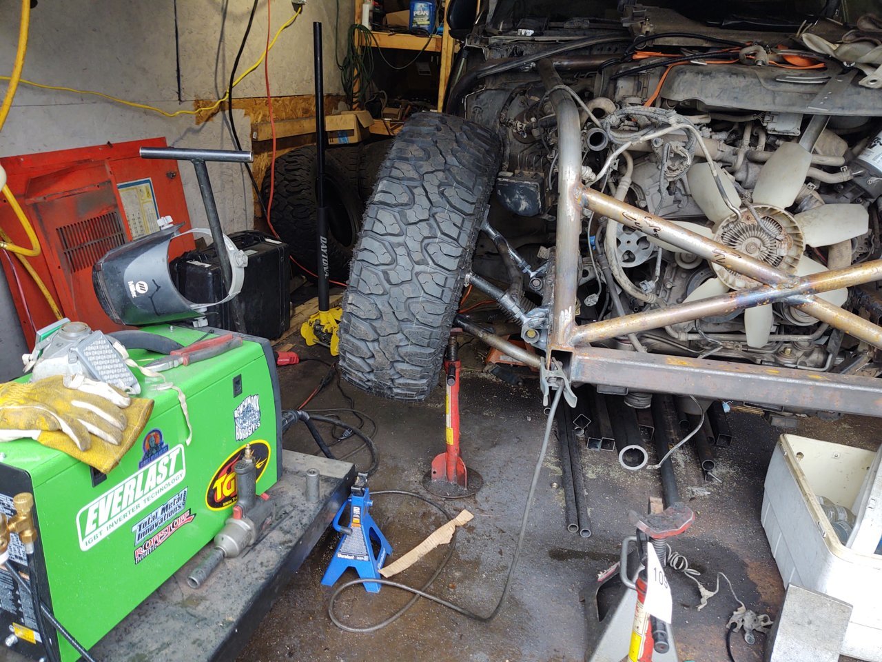

    15" of travel, limited by the CV angle. And the tire clears the firewall.
    Now for a UCA.

    do you know what angle the stock cvs bind up at? Also 3.5” over lt? Looks rad, been trying to piece things together to build my own, aiming for 12-14” and hoping to stay at 2” over.
  13. Jan 17, 2021 at 7:04 AM
    #893
    Arcticelf
    Arcticelf [OP] Well-Known Member
    Jul 18, 2015
    #159735
    7,662
    Gladiator
    24deg I think. The inner binds first.
    Thanks, it's 1.5" over stock width on each side, so basically the same track width I had before with 1.5" spacers to clear my tires on the uca.

    I know it’s not aligned yet but that seems like a lot of camber change. There going to be enough alignment adjustment to address that?
  16. Mar 29, 2021 at 9:13 AM
    #896
    Arcticelf
    Jul 18, 2015
    #159735
    7,662
    Gladiator
    That's actually pretty close to aligned.
    It's sitting at -.5 deg camber at ride height, - 12 deg or so at full bump and .5 deg at full droop. It goes from -4 to -12 in the last ~3" of travel, so I think it's just something to live with. The bump steer looks good though, and so does the caster.

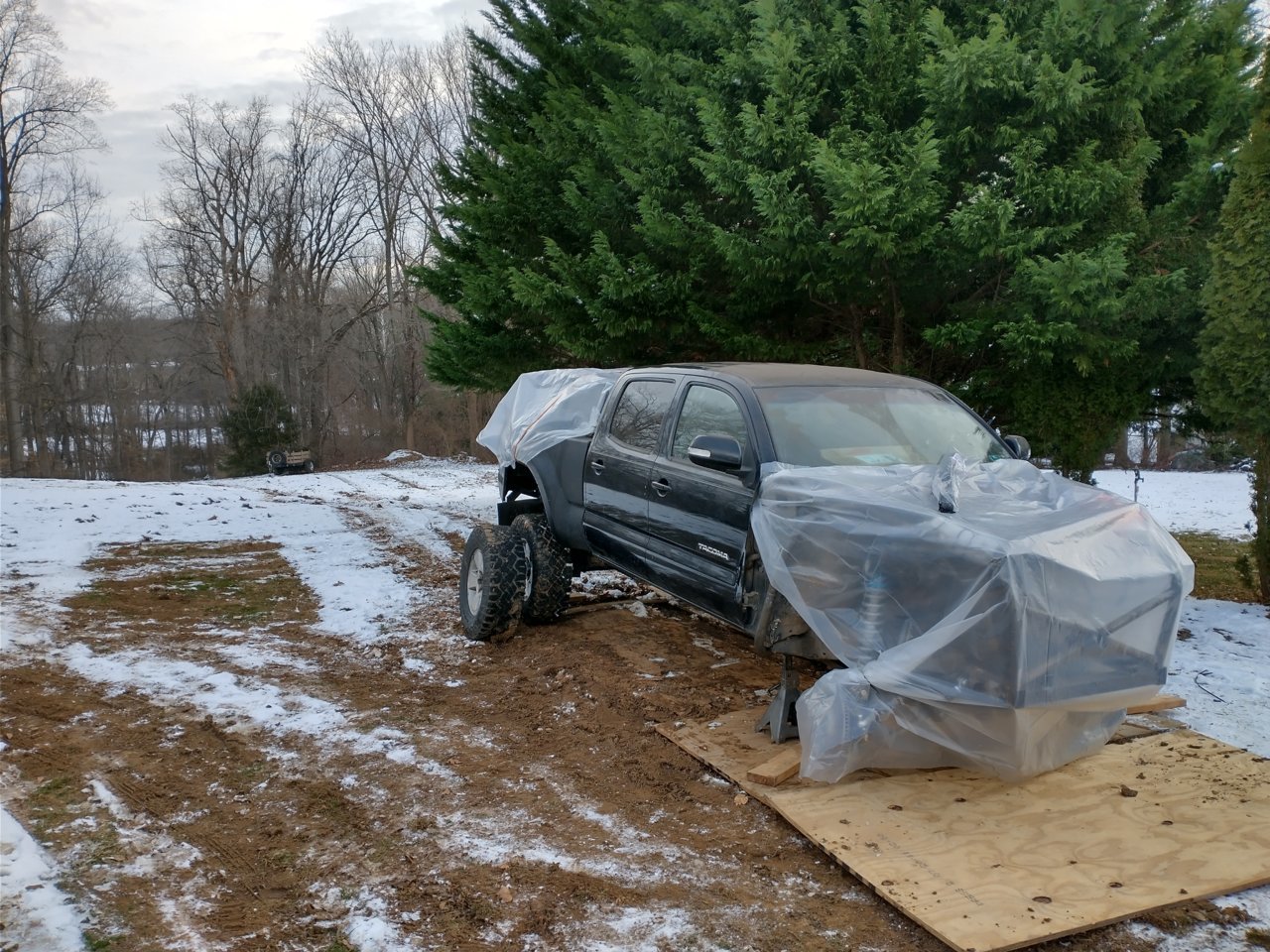

    7,662
    Gladiator

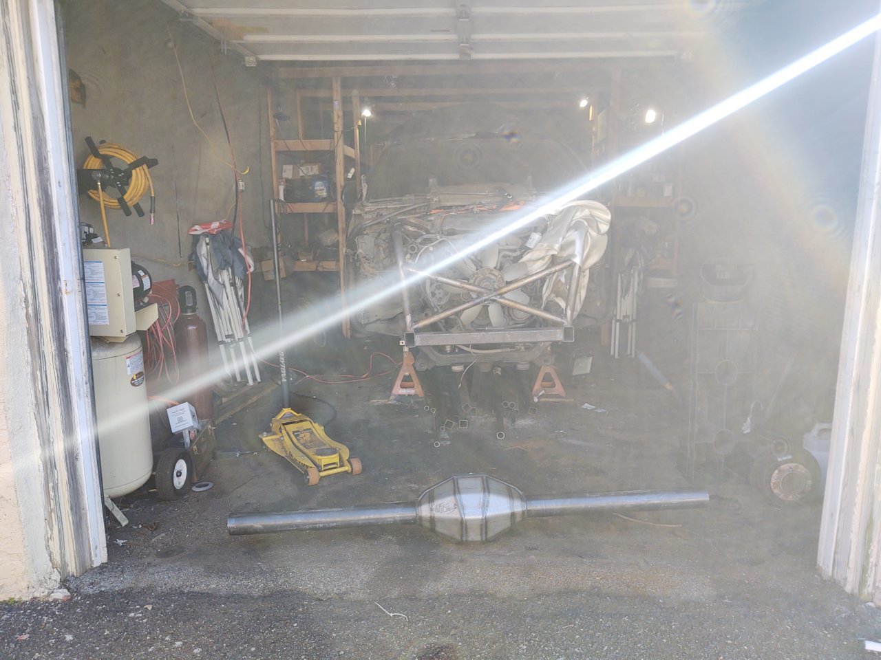

    Getting close to coming off the jack stands

    New jack stands, same not moving under its own power.
