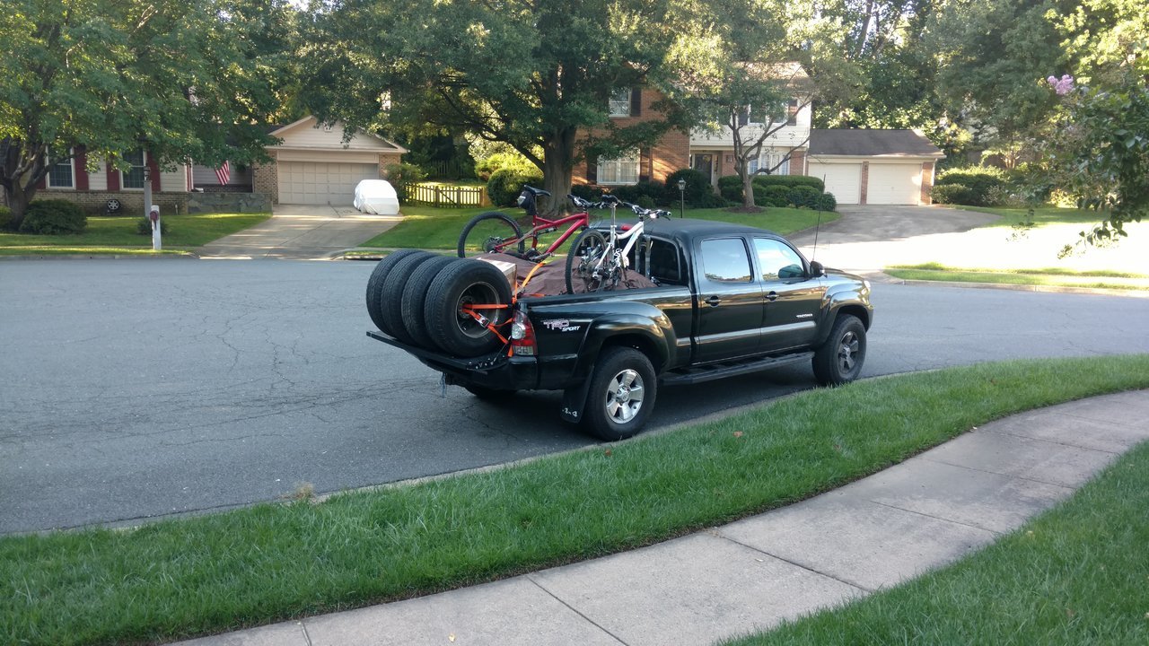

    Installed my new, patent pending tire gate.

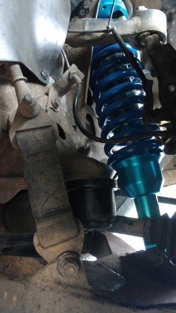

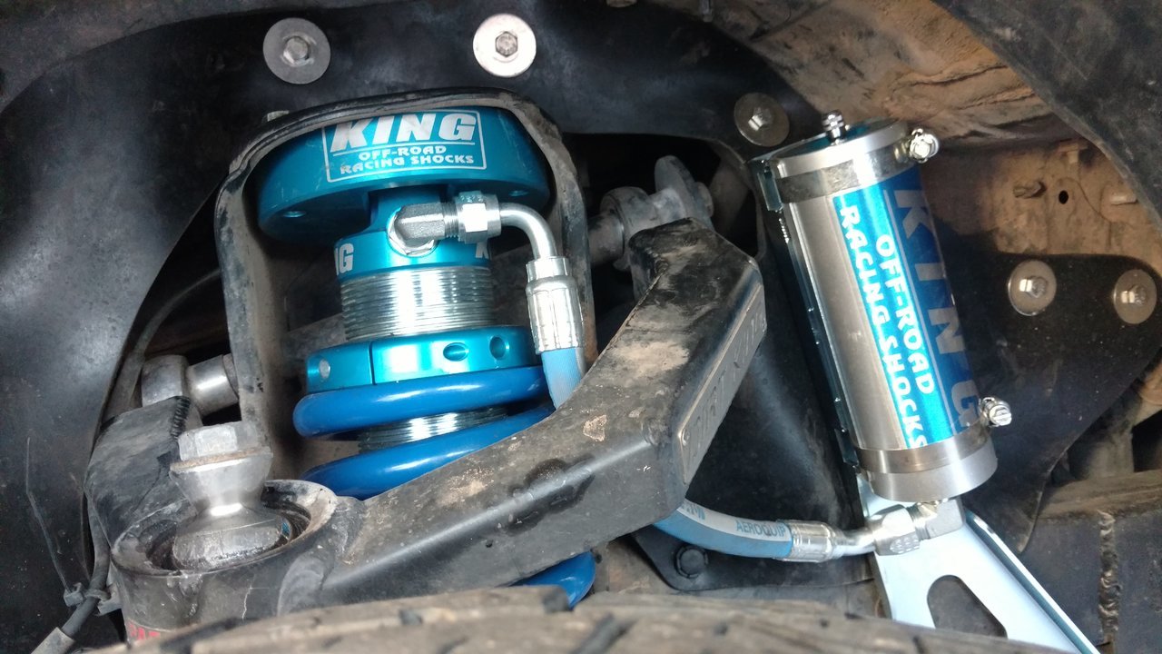

    Did a thing this weekend.
    Kings with 700# springs from the guys at @Downsouth Motorsports , and @Wheeler's Off-Road Inc Super Bumps. Big improvement to the front end.
    Note: preserve the holes for the swaybar on any front end work, lots of shit you might want bolts into those holes (like the king remote mounts).

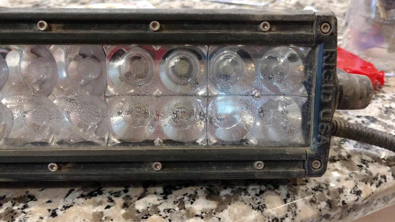

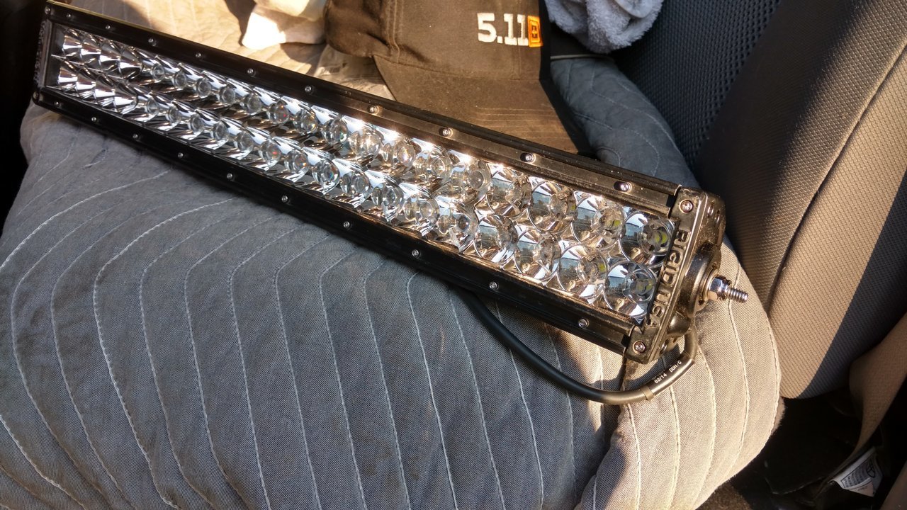

    Before
    After
    Thank you to the customer service department at Rigid, I bought that light second hand, and they still honored the warranty.

    Def interesting...how does the tailgate hold up to that much weight? Didn't know you rode!

    Installed this weekend, went on easily, and no issues with the straps.

    Tailgate did fine, most of the weight is held by the ratchet strap going up to the bedside stiffener, and pulling the tires against the tool box.

    what LCAs do you have? Dirt King?
