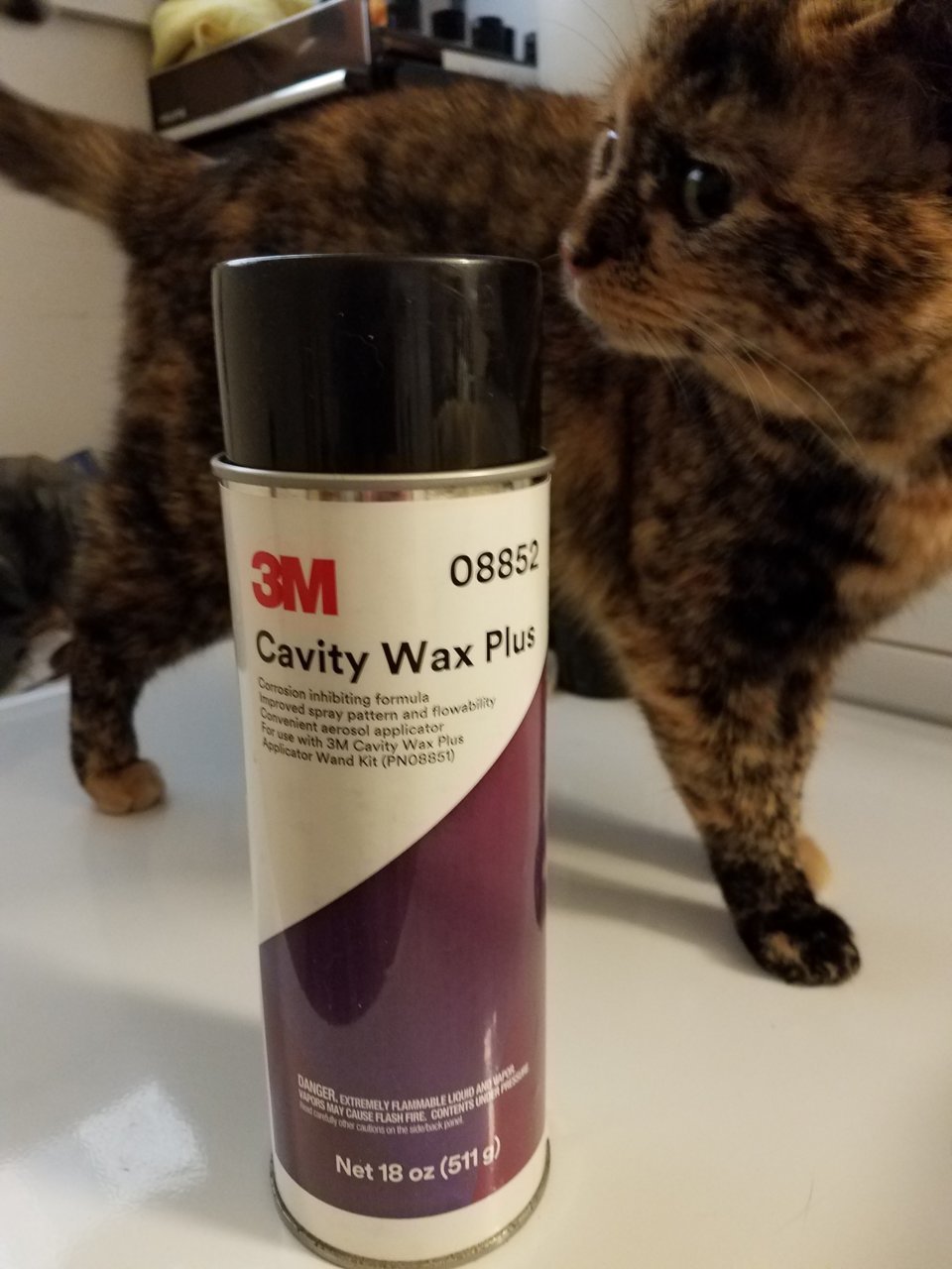

    I use body cavity wax on my truck, it dries shortly after spraying so no mess from dust and I can also work on the underside of the truck without getting it all over me.

    Sorry about the cat but she insisted on getting in the way
