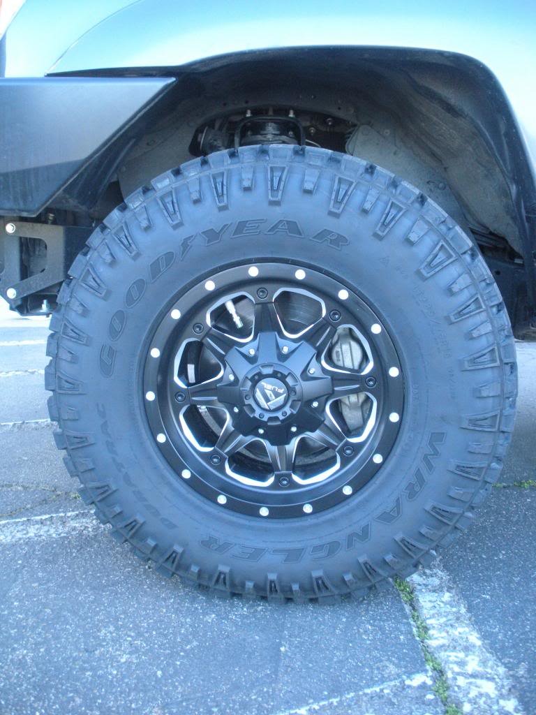

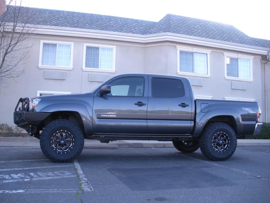

    I'll try to make a long story short. I have a 2009 DCSB TRD 4x4. Wanting a little lift, went with a leveling kit. Then realized the truck looked a little weird with stock tires (265/70/16). Decided to buy new wheels and tires and fill up some wheel well. After reading many posts on Tacomworld 265/75/16 sounded like the safest option. Some folks have been running 285/70/17 with "little" trimming. Went to a shop weeks ago and was told that the Duratrac didn't come in a 265/75/16 at that time, I think they do now. However, the salesman said that they have installed 285/70/17 on quite a few tacos with no problems. Well needless to say, they didn't fit, especially because the offset/backspacing made the wheel hit on the UCA. Didn't even sound like they could get them to bolt on (Fuel Boosts). After driving 100 miles to the shop, I was stunned. The salesperson did more checking and calling and let me know that a 285/75/16 on a 16x8 Fuel Boost with proper offset would work or they would do what it takes to make it work. At this point I feel a morbid curiosity to find out what happens. Am I just being dumb standing here waiting for a train wreck, which is my truck, to take place. Or should I quit worrying because it will work out and look decent in the end?

    Ummm... long as you have the proper backspacing 285s should fit pretty easy, especially if you only street it. You may have to clearance a little plastic and maybe the cab mount but that's all pretty non-invasive stuff

    I have 285/75/16 BFG All Terrains on mine, using stock rims. They rubbed the UCAs a little bit on hard turns. I put on 1.25" Spidertrax spacers for now, until I get new rims.
    There is a bit of rubbing on my mudguards when I back up and turn hard. I drilled a hole through the inside of the mudguard and tie-wrapped it back to the body mount to stop it.
    Sometimes it touches the front fender liner when off-roading, but I'll be cutting that back once I put the off-road front bumper on - haven't bothered to trim the fender liner at this point.
    All that being said, you can just put on spacers until you're ready for new rims with less backspacing - they're about $100 a pair...

    You shouldnt need to cab mount chop with 285s. unless your offset is very low. Not familiar with those wheels but imo 0 offset is perfect. Maybe slight trimming or bending of the plastic.
    Definitely go with 285's over 265's, especially since you have a winch bumper.

    The wheel P/N that would fit is D53416808345, 16x8" with 108mm centerbore and 1mm offset (assuming you want the black finish).
    285/75/16 is a 33" tire. You would need to remove the mudflap, trim away the portion of the fender flare that wraps around the bottom, and do a cab mount shop. The last one requires cutting away metal in your truck's frame and welding in a closeout piece: http://www.tacomaworld.com/forum/2nd-gen-tacomas/256842-cab-mount-chop-tut.html

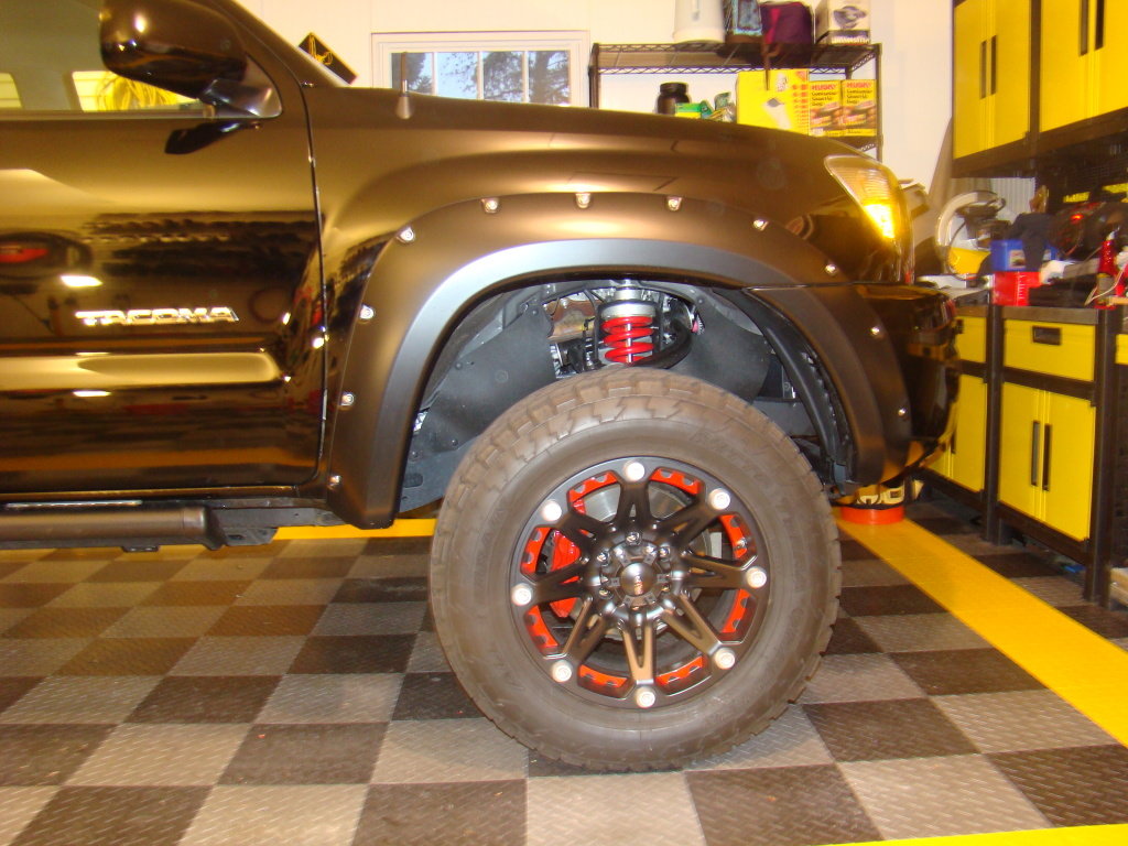

    Method Double Standards with 285 MTR's. Icon Extended length coil overs with total chaos arms. Did the cab mount chop. Cut a bunch of fender flair away. And hammered the pinch weld. Still when I hit good sized bumps at speed I hit the tire in to the wheel well. Raised it up a little still happens. So next is spacing down the super bumps. So be aware. You may not rub on the street or rock crawling but if you drive fast off road you might still have trouble.

    If your wheel offset isnt too crazy and caster is 2* or more, it shouldnt be that much of a problem with 285's. Assuming youre atleast 2.5" lift. Ran both my 2nd gens with 5100s and trimmed the front flare a little and no mud flaps. Ran it like that for a while, fairly easy and it did get wheeled at time. It did rub slightly on full stuff/lock.
